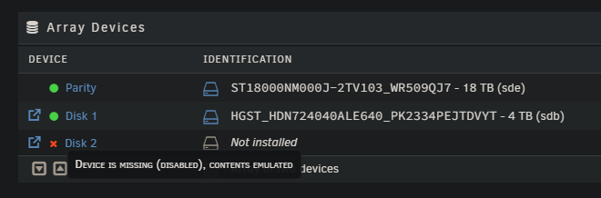

  3. "Regardless, I didn't risk it and added the second 18TB as Disk2. I have effectively 20TB atm." Yeah. I am now trying to remove it.

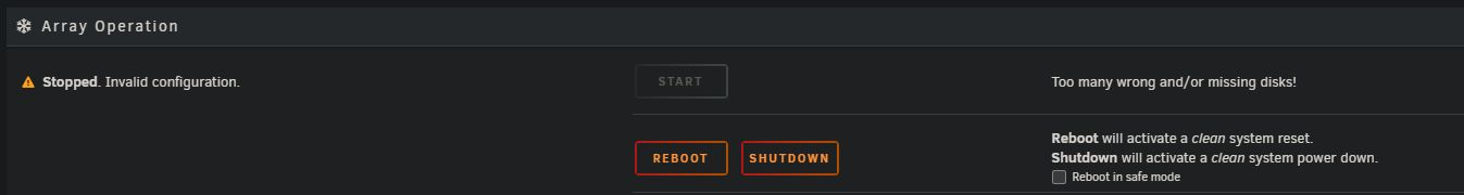

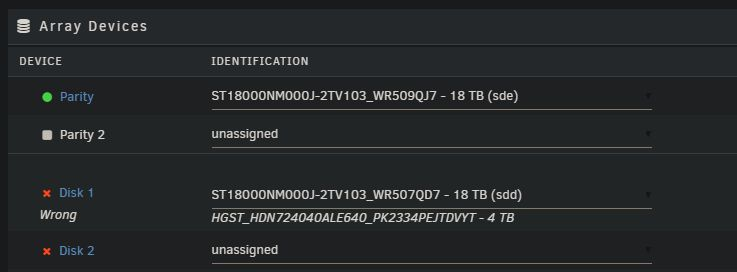

  4. I have stopped the array and removed the new disk from the array, but Unraid doesn't want to forget it. Keeps emulating it and claiming that array is not protected (which is expected according to the documentation.) My next step was to replace the Disk1 with the new Disk. I guess I need to force Unraid to forget that disk2 somehow or reinstate this array config in "New Config" (hope not...)? I keep starting and stopping the array. When attempting to add the new Disk in place of Disk1 I have a wrong configuration.

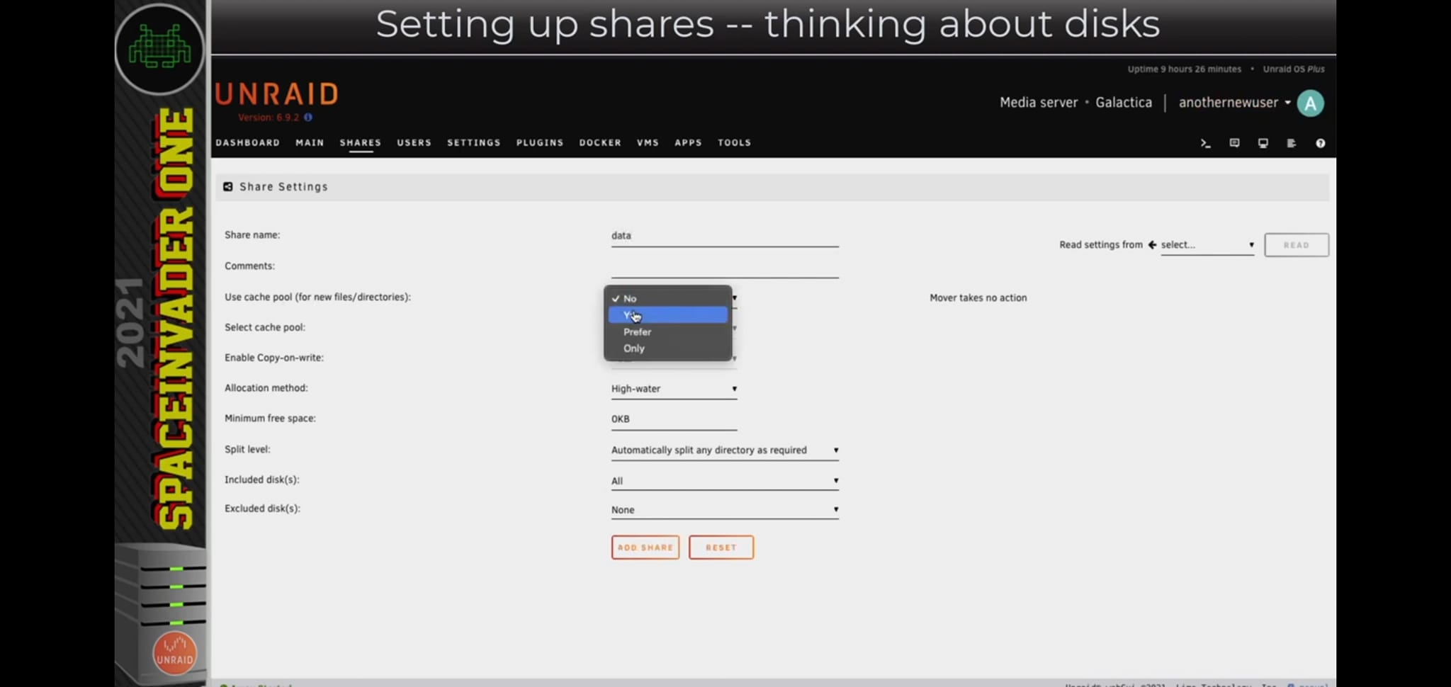

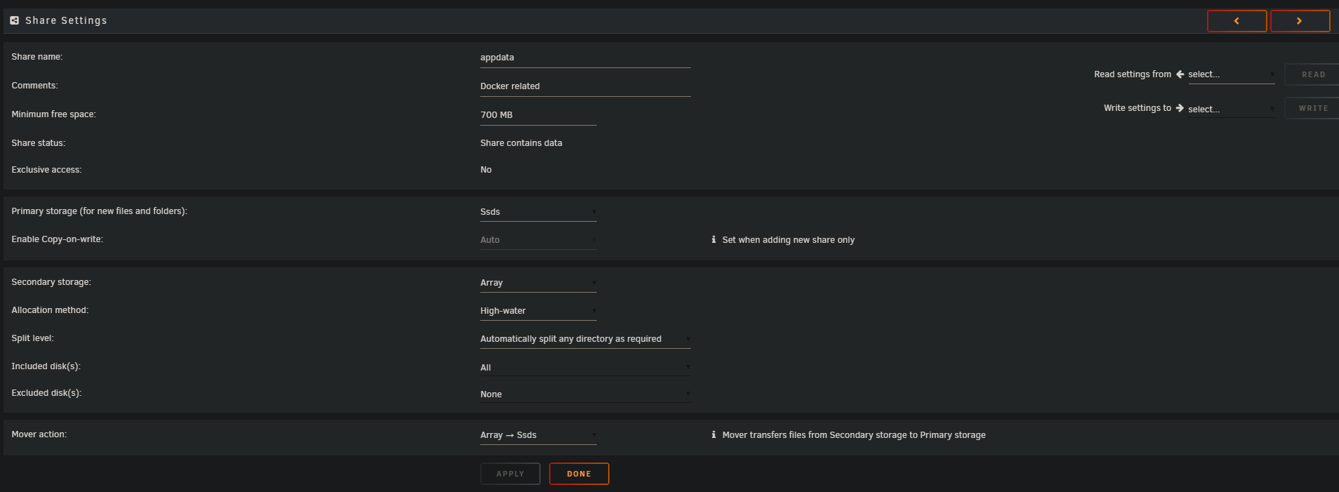

  8. Hi everyone. After months my focus returned to Unraid. Besides getting OS update, I'm also catching up with the settings. On the topic of shares; I see that there is no "Use cach pool (for new files/directories)" option anymore. How is this being set up these days? Is this covered by setting up the "Primary storage" and "Secondary Storage" sections? Are those new sections in the webUI? The first screen is from my Unraid, the second is from YT video. Thanks for the support!
