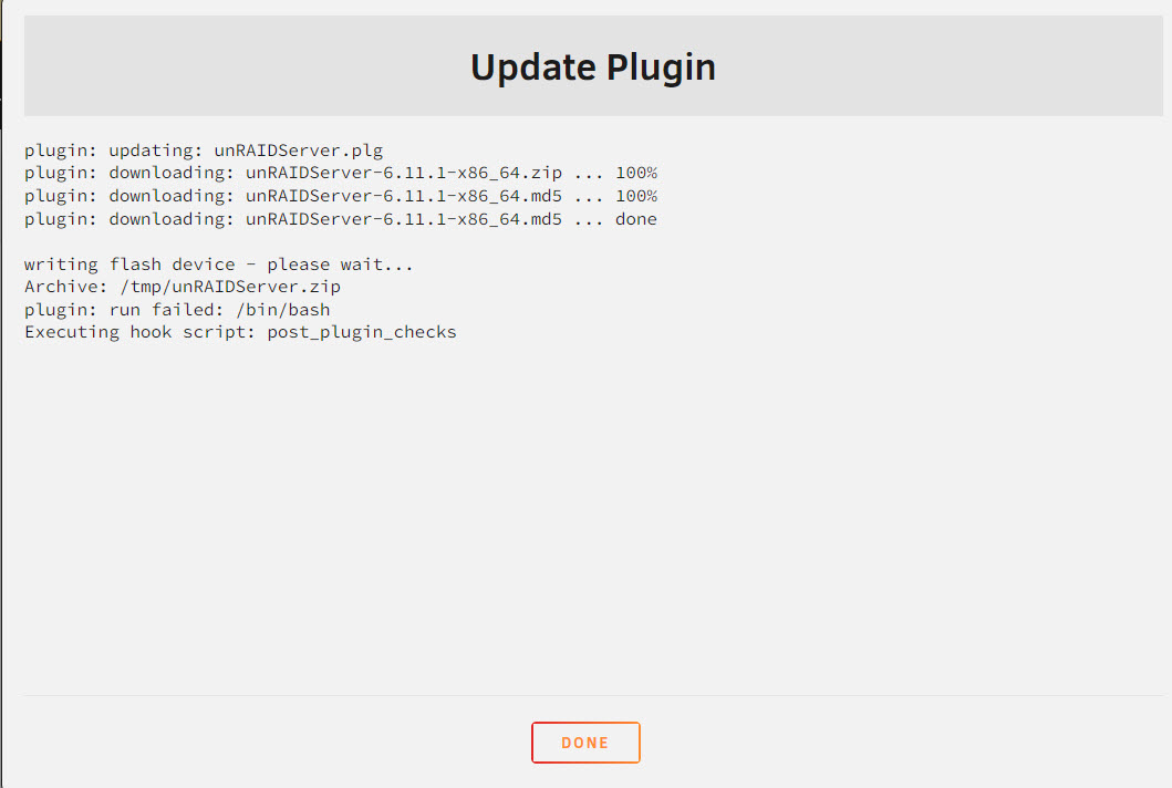

Well, when I looked at my motherboard lights the boot device light was on, so I did a CTRL-ALT-DEL and it started to boot properly and did the upgrade. I had to do the CTRL-ALT-DEL again, so it is probably the flash drive. I'll chkdsk on it later and/or replace it. I have a few new ones somewhere. Thx.

Damn, brand new Samsung metal bars too. See what happens.

I am unable to upgrade for some reason. Oct 7 06:58:46 SUN kernel: FAT-fs (sda1): error, fat_get_cluster: invalid start cluster (i_pos 0, start ff37525a) Oct 7 06:58:46 SUN kernel: FAT-fs (sda1): Filesystem has been set read-only Oct 7 06:58:46 SUN kernel: FAT-fs (sda1): error, fat_get_cluster: invalid start cluster (i_pos 0, start 39d1e50e) Oct 7 06:58:46 SUN kernel: FAT-fs (sda1): error, fat_get_cluster: invalid start cluster (i_pos 0, start 6c4cd5aa) Oct 7 06:58:46 SUN kernel: FAT-fs (sda1): error, fat_get_cluster: invalid start cluster (i_pos 0, start 7930364a) Oct 7 06:58:46 SUN kernel: FAT-fs (sda1): error, fat_get_cluster: invalid start cluster (i_pos 492537, start 317e5461) Oct 7 06:58:46 SUN kernel: FAT-fs (sda1): error, fat_get_cluster: invalid start cluster (i_pos 492537, start 317e5461) Oct 7 06:58:46 SUN kernel: FAT-fs (sda1): error, fat_get_cluster: invalid start cluster (i_pos 492537, start 317e5461) Oct 7 06:58:46 SUN kernel: FAT-fs (sda1): error, fat_get_cluster: invalid start cluster (i_pos 492537, start 317e5461) Oct 7 06:58:46 SUN kernel: FAT-fs (sda1): error, fat_get_cluster: invalid start cluster (i_pos 492537, start 317e5461) Oct 7 06:58:46 SUN kernel: FAT-fs (sda1): error, fat_get_cluster: invalid start cluster (i_pos 492537, start 317e5461) Oct 7 06:59:42 SUN root: plugin: creating: /tmp/unRAIDServer.sh - from INLINE content Oct 7 06:59:42 SUN root: plugin: running: /tmp/unRAIDServer.sh Oct 7 06:59:42 SUN root: plugin: creating: /tmp/unRAIDServer.zip - downloading from URL https://unraid-dl.sfo2.cdn.digitaloceanspaces.com/stable/unRAIDServer-6.11.1-x86_64.zip Oct 7 06:59:47 SUN root: plugin: creating: /tmp/unRAIDServer.md5 - downloading from URL https://unraid-dl.sfo2.cdn.digitaloceanspaces.com/stable/unRAIDServer-6.11.1-x86_64.md5 Oct 7 06:59:48 SUN root: plugin: creating: /tmp/unRAIDServer.sh - from INLINE content Oct 7 06:59:48 SUN root: plugin: running: /tmp/unRAIDServer.sh Oct 7 07:01:08 SUN root: plugin: creating: /tmp/unRAIDServer.sh - from INLINE content Oct 7 07:01:08 SUN root: plugin: running: /tmp/unRAIDServer.sh Oct 7 07:01:08 SUN root: plugin: creating: /tmp/unRAIDServer.zip - downloading from URL https://unraid-dl.sfo2.cdn.digitaloceanspaces.com/stable/unRAIDServer-6.11.1-x86_64.zip Oct 7 07:01:12 SUN root: plugin: creating: /tmp/unRAIDServer.md5 - downloading from URL https://unraid-dl.sfo2.cdn.digitaloceanspaces.com/stable/unRAIDServer-6.11.1-x86_64.md5 Oct 7 07:01:12 SUN root: plugin: creating: /tmp/unRAIDServer.sh - from INLINE content Oct 7 07:01:12 SUN root: plugin: running: /tmp/unRAIDServer.sh

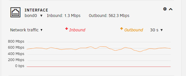

That's the problem, I don't know what it is. I think I have the streams plugin installed, I will check that now. UPDATE: I think I know what it was. Since my unraid hasn't been online for a little bit my Plex wanted to do a scan of my libraries. I looked at the streams and the machine getting all the information was where my Plex server is out. I killed Plex and the parity went back to normal! Glad at least I figured that one out. Would of driven me crazy. So now Plex is done and the parity is up to 139MB/sec. I turned that feature on Plex where it makes thumbnails and all that. Forgot the name.

Doing a parity, and let me tell you it is slow as ever! I've never seen it so slow. Also, when looking at interface there's alot of data going out to where, I have no idea. I took a couple snapshots and diagnostics to maybe someone may know what could cause this. sun-diagnostics-20221004-0530.zip
