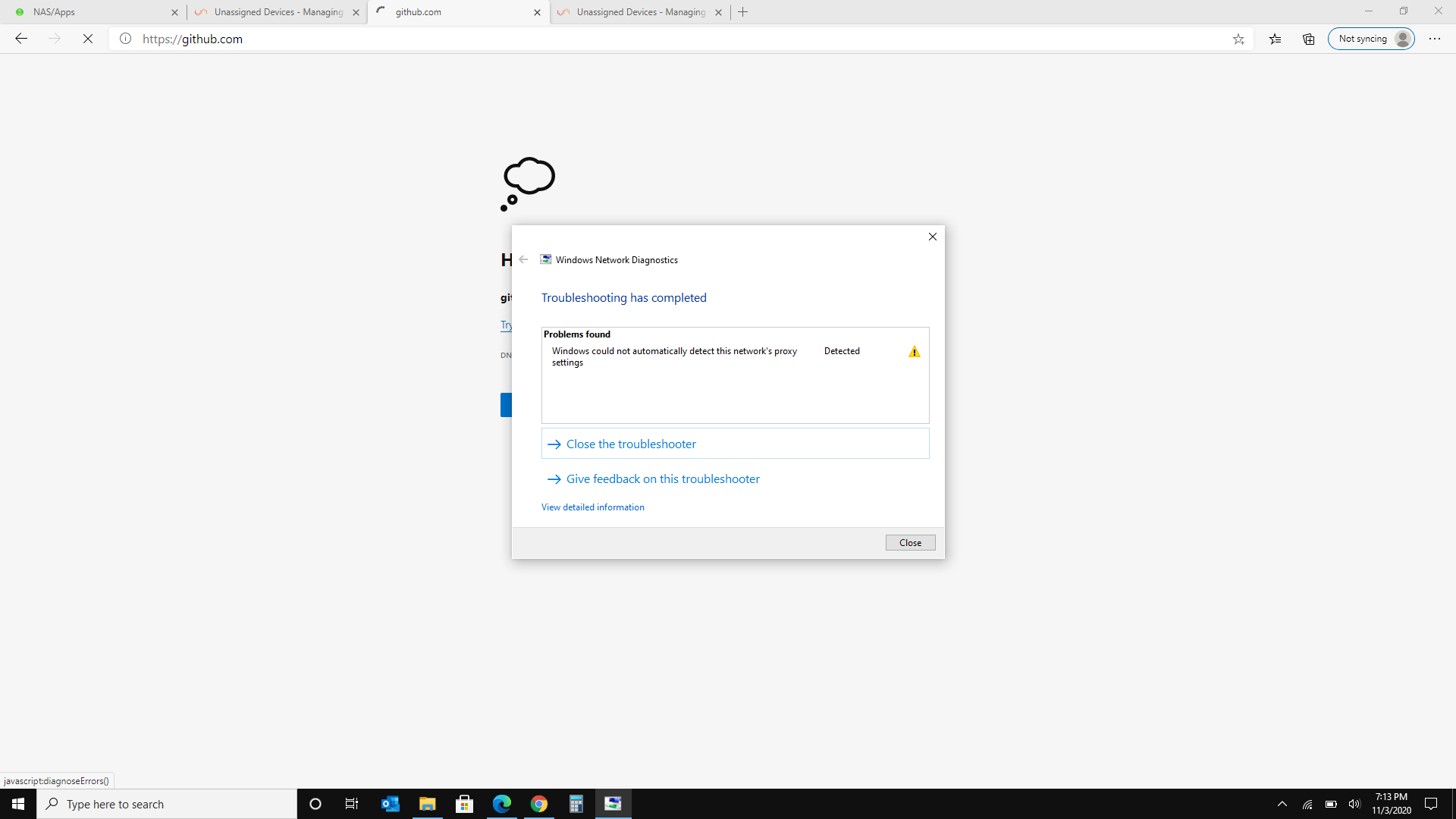

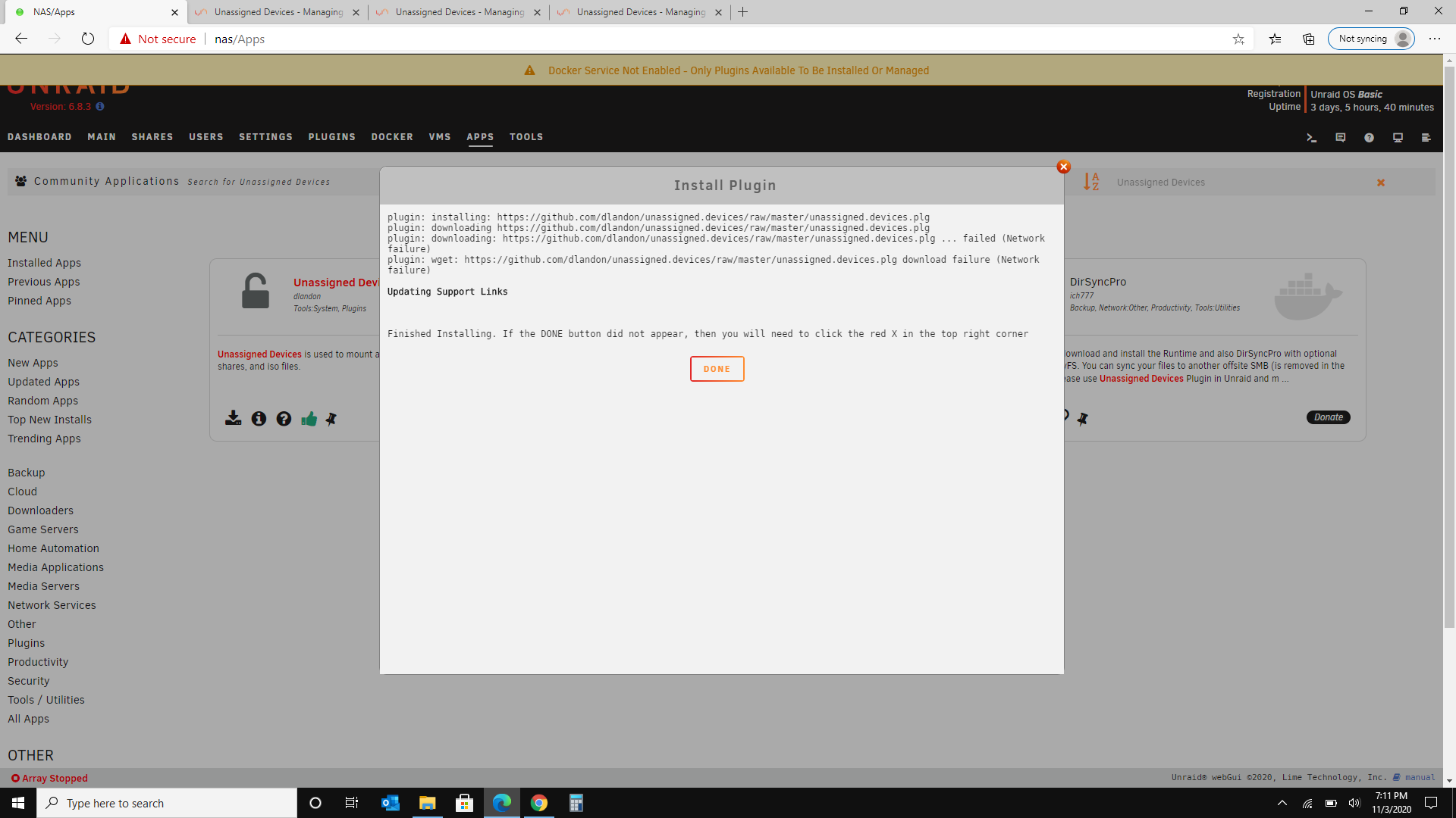

  4. Hello, I am struggling to get this plugin installed. I am new to unraid..just set up my first NAS this weekend and I am not the most tech savvy person. I have been able to install Community Applications, Fix common problems, Preclear Disks, and C A Auto Update. When I try and install Unassigned Drives I get a network error. See Screenshot #1. In investigating the potential problems, I discovered that I get a Proxy error when I try to go to the github website..see screen shot #2. I assume that these issues are related and this proxy error is what is causing the network error. I tried every thing under the sun from youtube and google searches to resolve this proxy error. The github website is the ONLY site that I have ever seen this error occur. Any insights or advise would greatly be appreciated. I have around 6 TBs of data to transfer onto my server and It's going to take forever if I can't attach my USB hard drives directly to the server.
