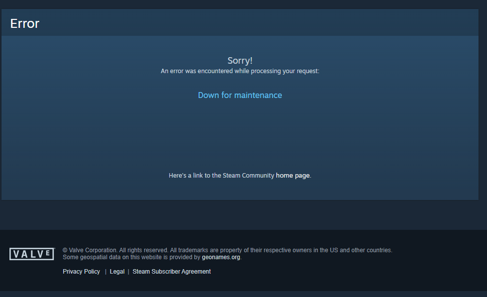

  11. Setting up CSMM on 7DTD server - Do I need to add the web server port that Alloc's creates to the Container page? (i.e. TCP4 - Allocs, Container Port:#) I have Alloc's installed on the server and working, created the webtoken to be able to add the server to CSMM. However, I can't resolve serverip:webserverport and adding the server to CSMM fails. Thoughts?
  12. Steam oauth was down for a while - working now!
  13. @ich777 Hey, I downloaded and setup your CSMM 7dtd container with reverse proxy pointing to my domain. I believe I have all that setup correctly as I have no issues hitting the CSMM homepage from both Unraid and externally via the web. However, when I click "Get Started" to get connected with Steam I get the following error. Have you seen this before? I wonder if it's actually down for maintenance or it's something else since it's my first time setting this up. Thanks for any help. Edit1: I don't see anything in the CSMM logs that point to anything wrong, only that it's trying to redirect to /sdtdserver/addserver since I'm not logged in. Edit2: Looks like from Googling, steam has maintenance every Tuesday. I'll wait!
