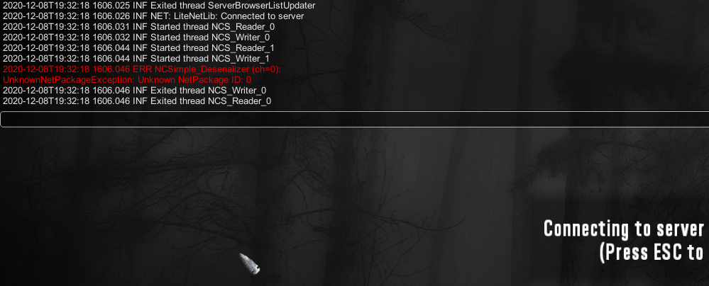

  17. Here's the error that pops up each time I or anyone tries to connect
  18. Anyone know how to roll back a beta version of 7DTD? I put in -beta latest_experimental in the game ID and it seemed to update fine, but I nor anyone else can connect to the server and I want to roll back for the time being. I tried removing the -beta tag to see if it'd pick up the latest public release and it didn't. Thanks!
