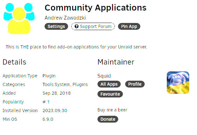

  4. *Facepalm* Just seen we're at 6.12.4 now. I'm so used to Windows updates with a pop-up.

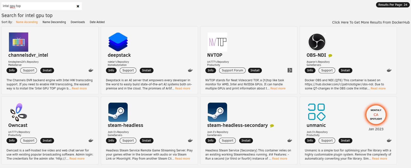

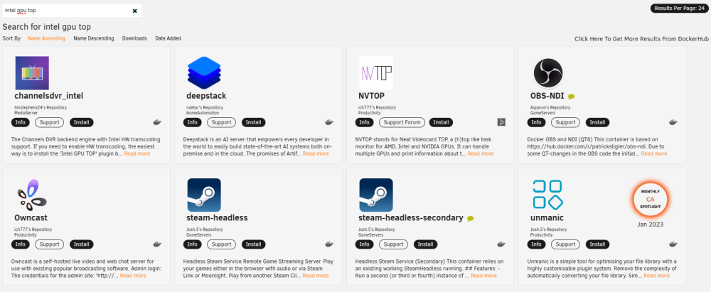

  5. That is so strange as I cannot find it at all. Unraid version (apols for the blown-out colour. Monitor is HDR): CA Version: Search:
  6. Apologies if this has been covered numerous times, but I cannot find the Intel-gpu-TOP plugin anywhere on CA anymore. Has it been removed or something?

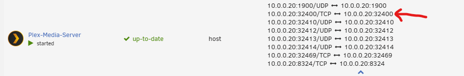

  14. Great, thanks for letting me know. Is there a way of doing what I need to in the app then? Changing the setting in the server settings doesn't seem to work. It puts it into indirect play mode which results in streaming 480p or less.
