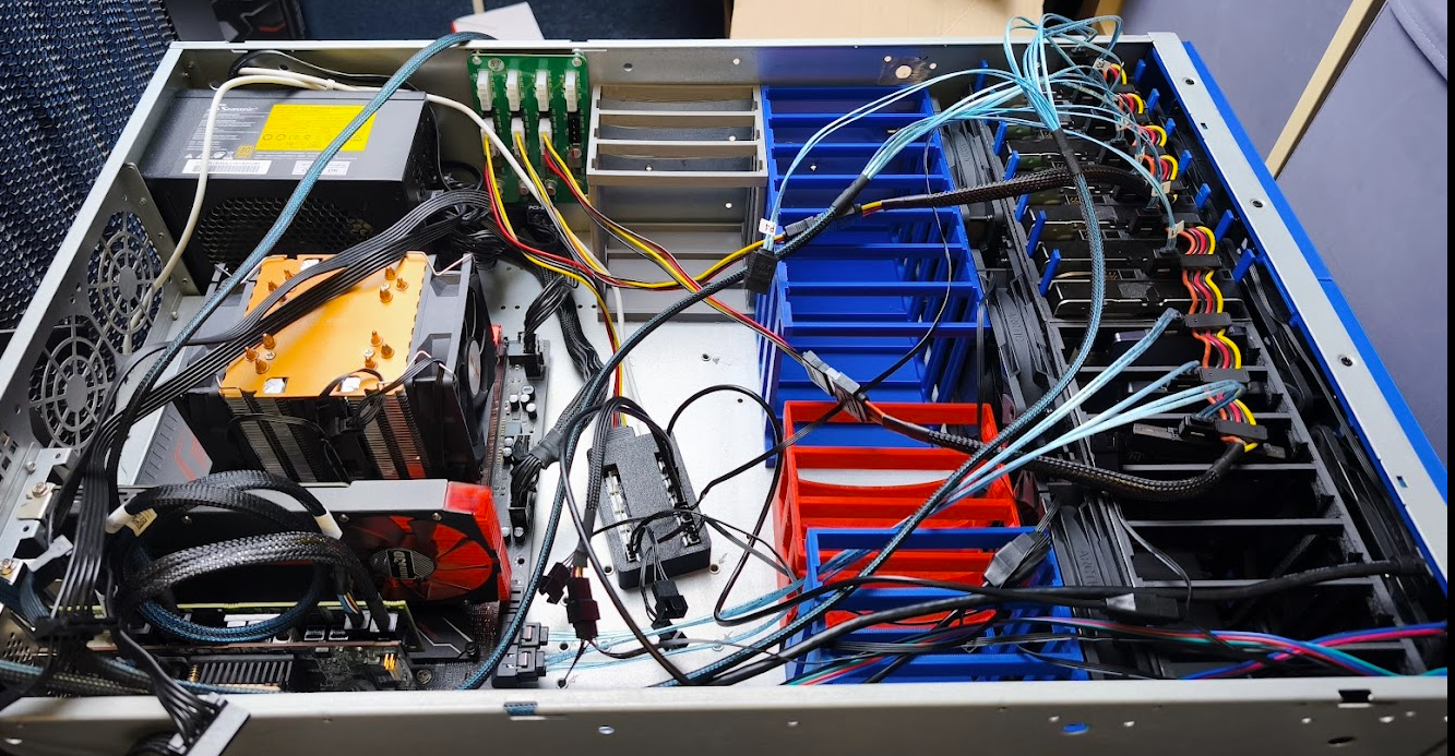

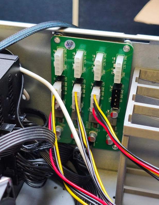

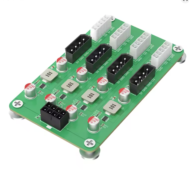

  10. Just to comment, as I'm was a similar situation. It's not ideal, by any means, and you run the risk of shorting the drives. (I've personally had this happen) Option: Get a power supply with 6 SATA connectors. I have a Corsair HX1200 v2 and I have 7 drives per SATA connector. Option: Seing how HakoForge and 45drives do their power spliiting from PCIe GPU power connectors, I found this on a certain Chinese online site my friend Ali recommended under the name "ATX 6/8Pin 12V to 5/12V 4x 4PIN + 4x 5PIN Power Supply Breakout Board Module Adapter Connector for ATX PSU 2.5/3.5" SATA HDD". One PCIe GPU split it into 4 connectors which provide stable 12v and 5v. I have between 4 and 5 drives attached per molex connector. Each power connector can handle max 3A. (FYI: this is work still in progress, so the build is FAR from done).
