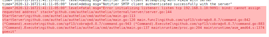

  7. Found the error, it was in the configuration.yml. Syntax error, as I have two "rules"
  8. Thanks for the tip, it was actually the IP problem, I put the unraid IP, when I should leave 0.0.0.0 Now I have another problem. I can log in into authelia, but every subdomain protected by authelia, I get 403 Forbidden nginx/1.18.0 I know is a permission problem, but I can't figure it out were is the setting. In the user_database.yml, my account have the groups -admin and -dev Also I removed the # in the corresponding proxy-conf authelia section. In the docker LOG it says time="2020-12-19T15:31:09-05:00" level=info msg="Access to https://sonarr.domain.com/favicon.ico is forbidden to user xxxxx" method=GET path=/api/verify remote_ip=xxx.xxx.xxx.xxx
