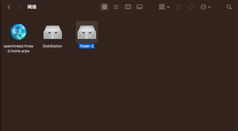

The Tower-2 problem occurred again, there is no system user Tower, and the network connection is not normal. tower-diagnostics-20240312-1458.zip

Mar 11 00:56:14 Tower root: error: /webGui/include/Boot.php: wrong csrf_token Mar 11 00:56:14 Tower rc.docker: transmission: started succesfully! Mar 11 00:56:21 Tower rc.docker: v2raya: started succesfully! Mar 11 00:56:32 Tower root: error: /webGui/include/Boot.php: wrong csrf_token Mar 11 01:18:44 Tower avahi-daemon[9320]: Host name conflict, retrying with Tower-2 Mar 11 01:18:44 Tower avahi-daemon[9320]: Registering new address record for 192.168.31.10 on br0.IPv4. Mar 11 01:18:45 Tower avahi-daemon[9320]: Server startup complete. Host name is Tower-2.local. Local service cookie is 2622481786. Mar 11 01:18:46 Tower avahi-daemon[9320]: Service "Tower-2" (/services/ssh.service) successfully established. Mar 11 01:18:46 Tower avahi-daemon[9320]: Service "Tower-2" (/services/smb.service) successfully established. Mar 11 01:18:46 Tower avahi-daemon[9320]: Service "Tower-2" (/services/sftp-ssh.service) successfully established. Edited just now by wuyongjun

I have been using unraid for more than a month. There are two problems that have been confusing me at the moment, the first is that unraid always disconnects when connecting to the time machine, and it disconnects after a backup. I want to further improve the backup connection stability of Time Machine. The second problem: the name of the native unraid is that Tower will disconnect while transferring large files, and then the Tower name cannot be found on the computer when the file transfer is completed. Instead, a Tower-2 computer hostname was generated. The Tower name can only be reverted back to after restarting unraid. What is the problem?
把数据同步完后,我的Tower不见了。可是很快就能在网络中看到一个Tower-2.不知道是unraid系统问题,还是bug。可是只要重启unraid,就能恢复到Tower,不知道谁能解决下 Mar 11 00:56:14 Tower root: error: /webGui/include/Boot.php: wrong csrf_token Mar 11 00:56:14 Tower rc.docker: transmission: started succesfully! Mar 11 00:56:21 Tower rc.docker: v2raya: started succesfully! Mar 11 00:56:32 Tower root: error: /webGui/include/Boot.php: wrong csrf_token Mar 11 01:18:44 Tower avahi-daemon[9320]: Host name conflict, retrying with Tower-2 Mar 11 01:18:44 Tower avahi-daemon[9320]: Registering new address record for 192.168.31.10 on br0.IPv4. Mar 11 01:18:45 Tower avahi-daemon[9320]: Server startup complete. Host name is Tower-2.local. Local service cookie is 2622481786. Mar 11 01:18:46 Tower avahi-daemon[9320]: Service "Tower-2" (/services/ssh.service) successfully established. Mar 11 01:18:46 Tower avahi-daemon[9320]: Service "Tower-2" (/services/smb.service) successfully established. Mar 11 01:18:46 Tower avahi-daemon[9320]: Service "Tower-2" (/services/sftp-ssh.service) successfully established.
