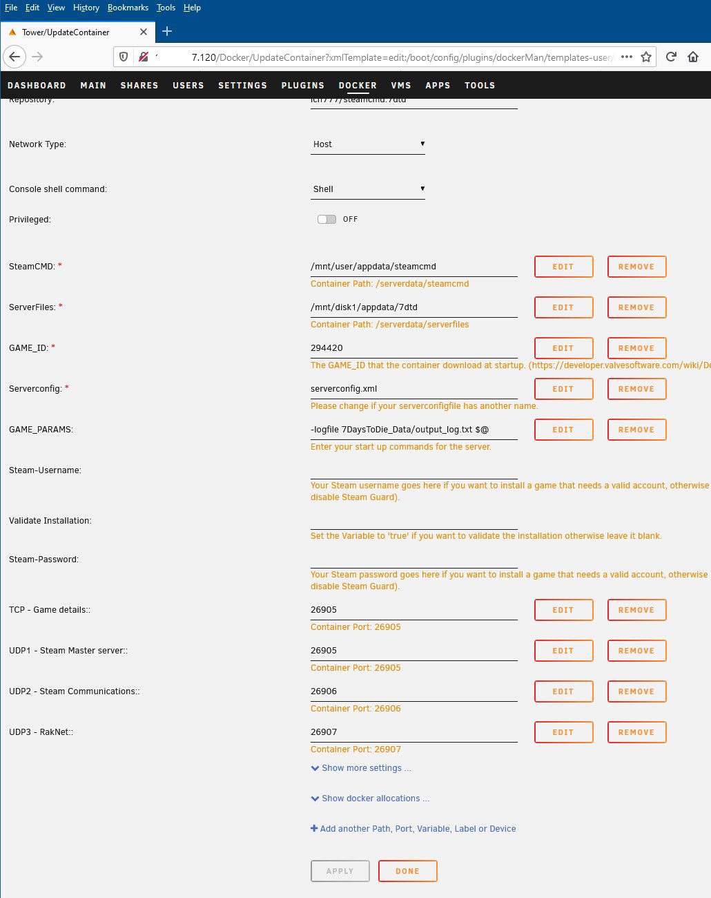

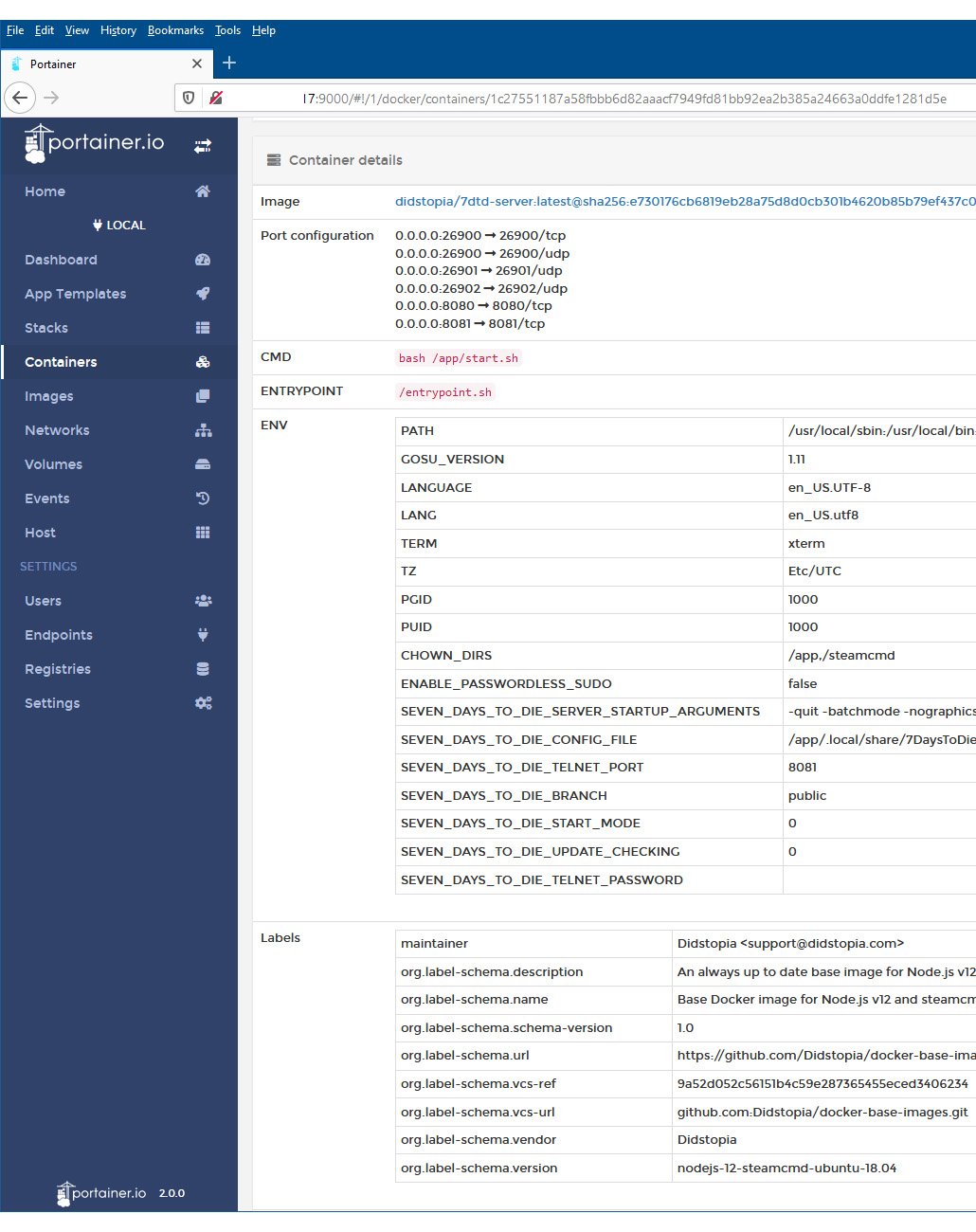

  18. This is the part that's a bit strange to me... In your example, you set a container port to say 27016, but how does the game know to use that port unless it's specified somewhere? (I'm assuming the default is 27015) That's why I was asking about the "+1" idea with the serverconfig.xml; if you simply set the serverconfig to say 26905, does the game know to move-up the port numbering to find the rest of the ports used? Does the game "scan" though a range of ports? (seems unlikely...) In any case, when I duplicate (but shift +5 to 26905) my -working- OMV ports, the Unraid-hosted server can be seen by the in-game browser, but you get a timeout trying to connect. Something is missing, but I don't know what! FYI, switching to host mode works fine with the example attached (26905 and note the container ports shifted to match), but that's really not a "solution"! What makes it more complicated is that you really need to test connectivity though a VPN since servers on your LAN will appear to work fine, with settings that will fail for external clients.
  19. Ah, OK... The only port I've ever seen in serverconfig.xml is a single instance of 26900. Are there other instances that need to be changed, or does it assume that's the base port and does +1, +2, etc. internally? Check on the "delete and replace", vs. simply trying to update the template. The last entry (UDP5) warns about that and if you change the serverconfig.xml, it follows... I'm just messing around with both platforms! OMV/Portainer works, but is a helluva lot more work to figure out and is sheer hell to try to get access to the /players directories! (Linux permissions are almost impassible and WinSCP is about the only option for file changes/additions) I just uploaded the Portainer image to show that a functioning server does not use 27015/16 in bridge mode. Thanks for the quick replies!
  20. OK, to get the terminology straight, in your reply, the "config" you refer to is the list of port mappings under "Update Container"? (been there, done that...) Where would you see/edit the "template" in Unraid? Also, I don't follow what "redo it" refers to... (I had no overlaps since the mappings were all changed to 2790x, etc. and the other instance is running on a different box under OMV) Oh yeah, under OMV, I don't port-forward 27015/16 and it works fine! I suspect that 26900 TCP/UDP might actually be the only port needed! Sorry if the questions seem obvious, but it seems like it should be simple, but there's a core issue I'm not addressing!
  21. Question: 7 Days to Die and multiple container instances and/or other existing servers and Bridge mode? More for curiosity and elegance, I'm trying to figure out how to make a 7DTD container that uses non-standard ports work in Bridge mode. I've got it to the point where an external user can connect via IP, bit the game is not advertised on the list. I can also get it to appear on the list, but it times-out trying to connect! There's (maybe) some magical combination of ports & forwarding that will make it work, but I haven't figured it out yet! (FYI, Host mode works, but that's cheezy and overkill and can cause other issues...) Also, I have a 7DTD server running on OMV/Portainer (didstopia/7dtd-server) with bridge mode and it works fine, albeit with the default ports.
