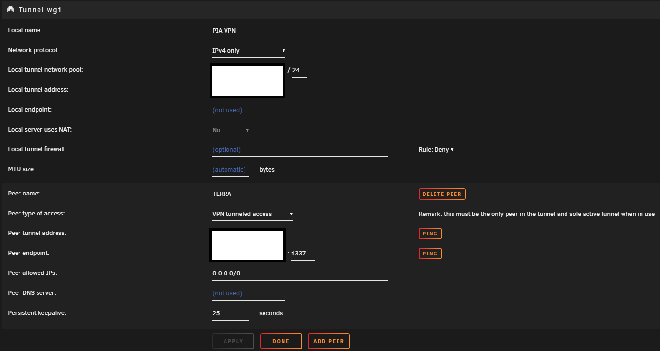

  1. Hey guys, I know this was referenced recently but is there a way to route only certain containers/VMs through the "VPN tunneled access" feature? When using my current config generated from pia-wg, it attempts to route all data going out of the server to the VPN.

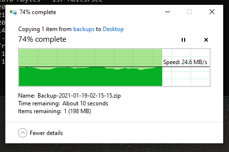

  6. Damn. Just tried a brand new network switch, now reaching around 40MB/s with the USB3.0 to ethernet adapter. Unfortunately, same 7MB/s with my motherboard's NIC, so that's definitely defective. STILL not the ~120MB/s I'm hoping for My PC (USB3.0 to ethernet adapter) to Server PC, hardlined. [ ID] Interval Transfer Bandwidth [ 4] 0.00-1.00 sec 40.4 MBytes 338 Mbits/sec [ 4] 1.00-2.00 sec 40.1 MBytes 337 Mbits/sec [ 4] 2.00-3.00 sec 40.1 MBytes 336 Mbits/sec [ 4] 3.00-4.00 sec 40.1 MBytes 337 Mbits/sec [ 4] 4.00-5.00 sec 40.1 MBytes 336 Mbits/sec [ 4] 5.00-6.00 sec 40.1 MBytes 337 Mbits/sec [ 4] 6.00-7.00 sec 40.0 MBytes 336 Mbits/sec [ 4] 7.00-8.00 sec 40.2 MBytes 337 Mbits/sec [ 4] 8.00-9.00 sec 40.0 MBytes 337 Mbits/sec [ 4] 9.00-10.00 sec 40.1 MBytes 336 Mbits/sec - - - - - - - - - - - - - - - - - - - - - - - - - [ ID] Interval Transfer Bandwidth [ 4] 0.00-10.00 sec 401 MBytes 337 Mbits/sec [ 4] 0.00-10.00 sec 401 MBytes 337 Mbits/sec
  7. Just asked my roommate to test it, he got better scores than my computer and slightly better than my laptop over wifi. [ ID] Interval Transfer Bitrate [ 5] 0.00-1.00 sec 32.0 MBytes 268 Mbits/sec [ 5] 1.00-2.00 sec 28.6 MBytes 240 Mbits/sec [ 5] 2.00-3.00 sec 28.8 MBytes 242 Mbits/sec [ 5] 3.00-4.00 sec 24.5 MBytes 205 Mbits/sec [ 5] 4.00-5.00 sec 26.9 MBytes 225 Mbits/sec [ 5] 5.00-6.00 sec 26.9 MBytes 225 Mbits/sec [ 5] 6.00-7.00 sec 27.5 MBytes 231 Mbits/sec [ 5] 7.00-8.00 sec 28.3 MBytes 238 Mbits/sec [ 5] 8.00-9.00 sec 27.2 MBytes 229 Mbits/sec [ 5] 9.00-10.00 sec 30.2 MBytes 254 Mbits/sec [ 5] 10.00-10.04 sec 1.00 MBytes 228 Mbits/sec - - - - - - - - - - - - - - - - - - - - - - - - - [ ID] Interval Transfer Bitrate [ 5] 0.00-10.04 sec 282 MBytes 236 Mbits/sec Since my Mini ITX board only has one PCIe slot for my graphics card, I don't have any slots available for another NIC, my only option is to use that USB adapter.
  8. Looks like you're correct, my motherboard's network adapter seems defective, tried using my usb3.0 to ethernet adapter instead and here's the results: BUT: I'm still not getting the speeds I was hoping for, even if this is a significant improvement. My PC (using usb3.0 to ethernet adapter) to Server PC, hardlined. [ ID] Interval Transfer Bandwidth [ 4] 0.00-1.00 sec 21.4 MBytes 179 Mbits/sec [ 4] 1.00-2.00 sec 20.9 MBytes 175 Mbits/sec [ 4] 2.00-3.00 sec 19.0 MBytes 160 Mbits/sec [ 4] 3.00-4.00 sec 20.4 MBytes 171 Mbits/sec [ 4] 4.00-5.00 sec 19.9 MBytes 167 Mbits/sec [ 4] 5.00-6.00 sec 18.8 MBytes 157 Mbits/sec [ 4] 6.00-7.00 sec 20.9 MBytes 175 Mbits/sec [ 4] 7.00-8.00 sec 21.0 MBytes 176 Mbits/sec [ 4] 8.00-9.00 sec 20.8 MBytes 174 Mbits/sec [ 4] 9.00-10.01 sec 14.1 MBytes 118 Mbits/sec - - - - - - - - - - - - - - - - - - - - - - - - - [ ID] Interval Transfer Bandwidth [ 4] 0.00-10.01 sec 197 MBytes 165 Mbits/sec [ 4] 0.00-10.01 sec 197 MBytes 165 Mbits/sec

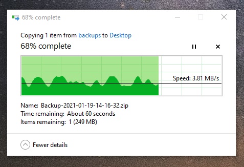

  9. My PC connecting to my Server PC, hardlined. [ ID] Interval Transfer Bitrate [ 5] 0.00-1.00 sec 6.82 MBytes 57.2 Mbits/sec [ 5] 1.00-2.00 sec 7.38 MBytes 61.9 Mbits/sec [ 5] 2.00-3.00 sec 7.25 MBytes 60.9 Mbits/sec [ 5] 3.00-4.00 sec 7.37 MBytes 61.8 Mbits/sec [ 5] 4.00-5.00 sec 7.22 MBytes 60.6 Mbits/sec [ 5] 5.00-6.00 sec 6.77 MBytes 56.8 Mbits/sec [ 5] 6.00-7.00 sec 6.64 MBytes 55.7 Mbits/sec [ 5] 7.00-8.00 sec 7.18 MBytes 60.2 Mbits/sec [ 5] 8.00-9.00 sec 7.22 MBytes 60.5 Mbits/sec [ 5] 9.00-10.00 sec 7.32 MBytes 61.4 Mbits/sec [ 5] 10.00-10.05 sec 382 KBytes 59.6 Mbits/sec - - - - - - - - - - - - - - - - - - - - - - - - - [ ID] Interval Transfer Bitrate [ 5] 0.00-10.05 sec 71.5 MBytes 59.7 Mbits/sec Server PC connecting to my PC, hardlined. [ ID] Interval Transfer Bandwidth [ 5] 0.00-1.00 sec 6.25 MBytes 52.4 Mbits/sec [ 5] 1.00-2.01 sec 6.47 MBytes 53.9 Mbits/sec [ 5] 2.01-3.01 sec 6.05 MBytes 50.7 Mbits/sec [ 5] 3.01-4.00 sec 5.21 MBytes 43.9 Mbits/sec [ 5] 4.00-5.00 sec 6.16 MBytes 51.6 Mbits/sec [ 5] 5.00-6.00 sec 6.08 MBytes 51.1 Mbits/sec [ 5] 6.00-7.00 sec 6.08 MBytes 50.9 Mbits/sec [ 5] 7.00-8.00 sec 4.68 MBytes 39.3 Mbits/sec [ 5] 8.00-9.00 sec 4.87 MBytes 40.8 Mbits/sec [ 5] 9.00-10.00 sec 4.66 MBytes 39.2 Mbits/sec [ 5] 10.00-10.04 sec 165 KBytes 36.0 Mbits/sec - - - - - - - - - - - - - - - - - - - - - - - - - [ ID] Interval Transfer Bandwidth [ 5] 0.00-10.04 sec 0.00 Bytes 0.00 bits/sec [ 5] 0.00-10.04 sec 56.7 MBytes 47.3 Mbits/sec Pop_OS! Laptop to Server PC, wifi. [ ID] Interval Transfer Bitrate [ 5] 0.00-1.00 sec 34.7 MBytes 291 Mbits/sec [ 5] 1.00-2.00 sec 30.3 MBytes 254 Mbits/sec [ 5] 2.00-3.00 sec 30.8 MBytes 258 Mbits/sec [ 5] 3.00-4.00 sec 31.5 MBytes 264 Mbits/sec [ 5] 4.00-5.00 sec 34.0 MBytes 285 Mbits/sec [ 5] 5.00-6.00 sec 36.4 MBytes 305 Mbits/sec [ 5] 6.00-7.00 sec 34.9 MBytes 292 Mbits/sec [ 5] 7.00-8.00 sec 35.5 MBytes 297 Mbits/sec [ 5] 8.00-9.00 sec 30.6 MBytes 257 Mbits/sec [ 5] 9.00-10.00 sec 36.9 MBytes 310 Mbits/sec [ 5] 10.00-10.01 sec 348 KBytes 463 Mbits/sec - - - - - - - - - - - - - - - - - - - - - - - - - [ ID] Interval Transfer Bitrate [ 5] 0.00-10.01 sec 336 MBytes 282 Mbits/sec receiver ----------------------------------------------------------- Server listening on 5201 ----------------------------------------------------------- See what I'm saying? I'll have to double check my drivers for all my systems then, because maybe it's just my PC? I just built both systems recently, and I'm more than certain they're up to date. Hmm. Mine: Ryzen 7 3800x Asus ROG Strix Mini ITX B550 w/ 2.5G Realtek Server: Ryzen 9 3900x Crosshair VIII Hero X570 w/ 2.5G Realtek and 1G Intel (Inactive) Also, forgot to mention, I'm messing around with IPv6 because of my Pi-Hole docker container, I wanted to try setting up both IPv4 and IPv6 for my DNS Server connections but that might be unnecessary. I'll most likely remove it.
  10. Update: Instead of 1MB/s - 2MB/s, I'm now averaging 3MB/s - 6MB/s, still nowhere near what I'm expecting.

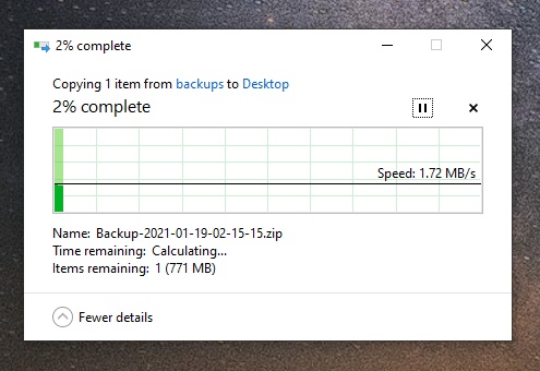

  12. MB/s. I should be getting around 100x more than this.
