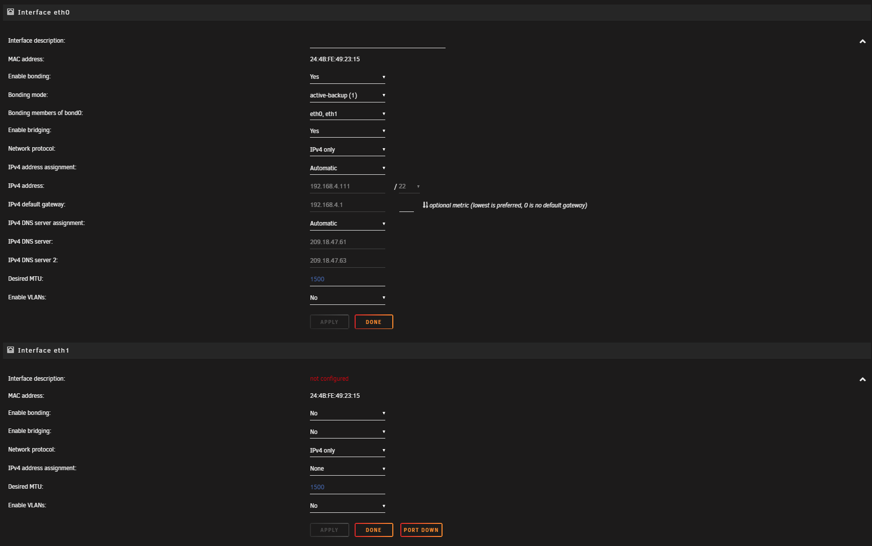

Hey Squid! Thanks for the reply, interestingly enough, switching back to my ISP's DNS Servers didn't help, but deleting the network.cfg and rebooting did make a change! Checked the network config on unRAID and its set to bonding (which I don't want) but I'm able to download and update everything again. Tested by adding your community apps plugin. Removing the bond setting gives me no internet access whatsoever (any clues why? I wasn't using it before, and I don't want to.)
Just solved it for myself, but I'm still confused. Looks like my older setup with both of my LAN Ports connected into two separate routers no longer works. I was using the secondary connection for my VR Windows VM. I'll try to look into it further.

My network settings also flipped to Bond without any changes. I needed to disable VM/docker and update the network settings back to single nic to restore.
