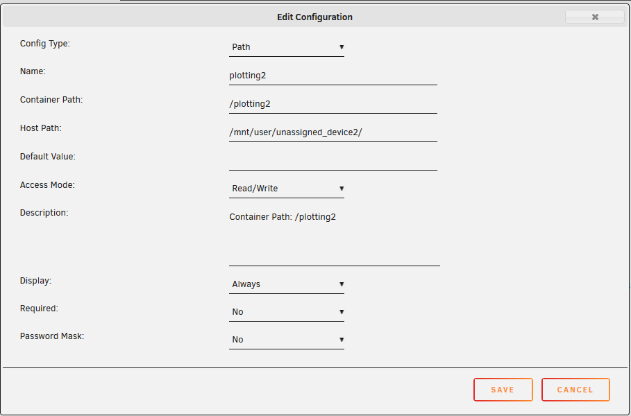

  2. Thank you ! And indeed thanks for everyone that is contributing and helping. You caught me before going to bed 😉 You are correct, you will need to add another path for the second temp directory. Let's say you called it plotting2 and that this plotting2 folder is pointing to your 2nd unassigned device. You can then start some plots with this as your plotting temp folder venv/bin/chia plots create -b 5000 -r 2 -n 1 -t /plotting2 -d /plots And some others with your first unassigned device (let's assume it's named plotting1 ) : venv/bin/chia plots create -b 5000 -r 2 -n 1 -t /plotting1 -d /plots At the moment there is no better way than with the console for this docker (or via the tmux console, see OP for details on this) EDIT: The template variable would look like this :
