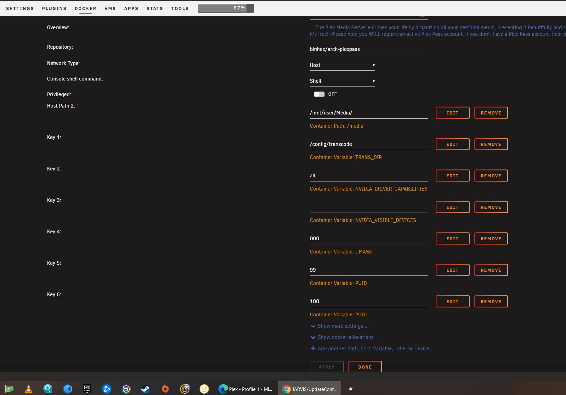

  2. Hey Binhex, thanks for the help. Changing the IP range solved my issues and im able to setup Plex w/o any problems.
  3. ohh... hmmm, interesting. I'll try and redefine the IP based on those ranges and report back. I had Plex working before on my Win 10 PC using the same IP range. I guess for UnRAID, non-routable IP range is a must?

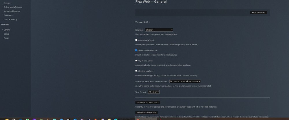

  4. Im having problems setting up binhex plex pass on my server. My server LAN IP is 179.168.0.30. Every time i try to access the local IP:32400 within my network, it redirects to plex.tv and i have to login with my credentials. And when i log in, i cant see my server media files. Even if i go to settings, nothing shows up. Just this: And im pretty sure i setup the docker correctly: My TV/movies are under /mnt/user/Media/TV Shows, /Movies, etc. I even unplugged my router from the internet, try to login to my server's local IP and it keeps saying unable to connect to plex.tv. I have used 2 different computers to access 179.168.0.30:32400 and same error. Unable to connect to plex.tv. Temp turned off windows firewall and same issue. Am i missing something here? Did i miss a step when installing the repository?
