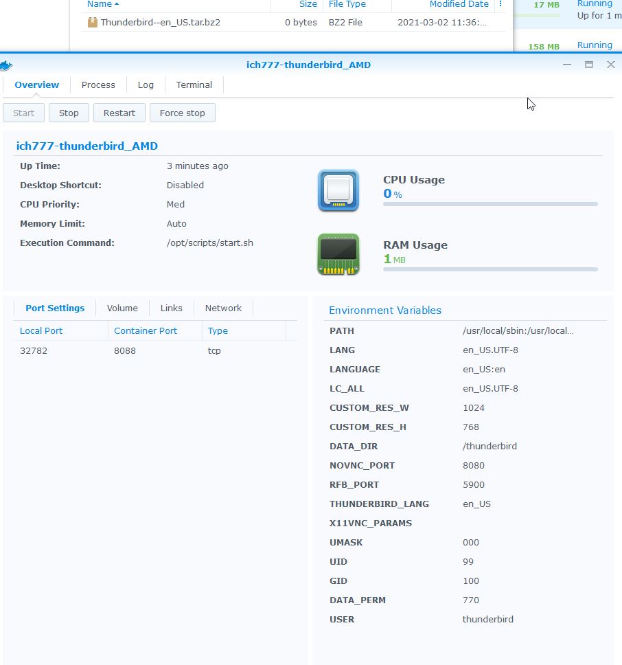

  2. Hello, I changed the port to 8080 and loaded the latest version.. still it faild. I tried de-DE also failed with different error and tried ther again.. not sure what I can do now ....
  3. I am running Synology Ds416play+ using Intel CPUs I am running 2 other x86 docker without an issue. what I did now: download AMD docker container, reviewed config (see picture). 1 file was created (filename:Thunderbird--en_US.tar.bz2) but not completed.. so no really change 😞 see screenshot of config

  8. Hello, I try using ich/thunderbird docker on Synology (having a few other containers already active and working fine). I have installed and configured Thunderbird docker, but I cannot get it to work the log files says: ---Starting...--- ---Version Check--- ---Thunderbird not installed, installing--- ---Something went wrong, can't download Thunderbird, putting container in sleep mode--- the network is set to bridge, so it should have full access to internet. edit: I looked in the respective docker folder and only found 3 files 15 Feb was my first try... 21 is from today.. 15.02.2021 14:36 215 .wget-hsts 21.02.2021 16:49 0 Thunderbird--.tar.bz2 15.02.2021 14:23 0 Thunderbird-78.3.2-.tar.bz2 Where can I start locking to get it to work?
