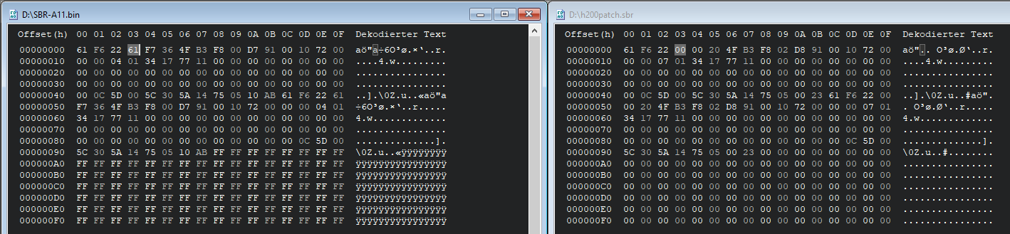

  3. As far as I can remember it is slightly different in the mfg bytes. See comparison below.
  4. Okay the new cable finally arrived. And I can report that it all works now! I've attached the SBR that finally did the trick for others to try if they are desparate. Thanks again for your input! h200patch.sbr

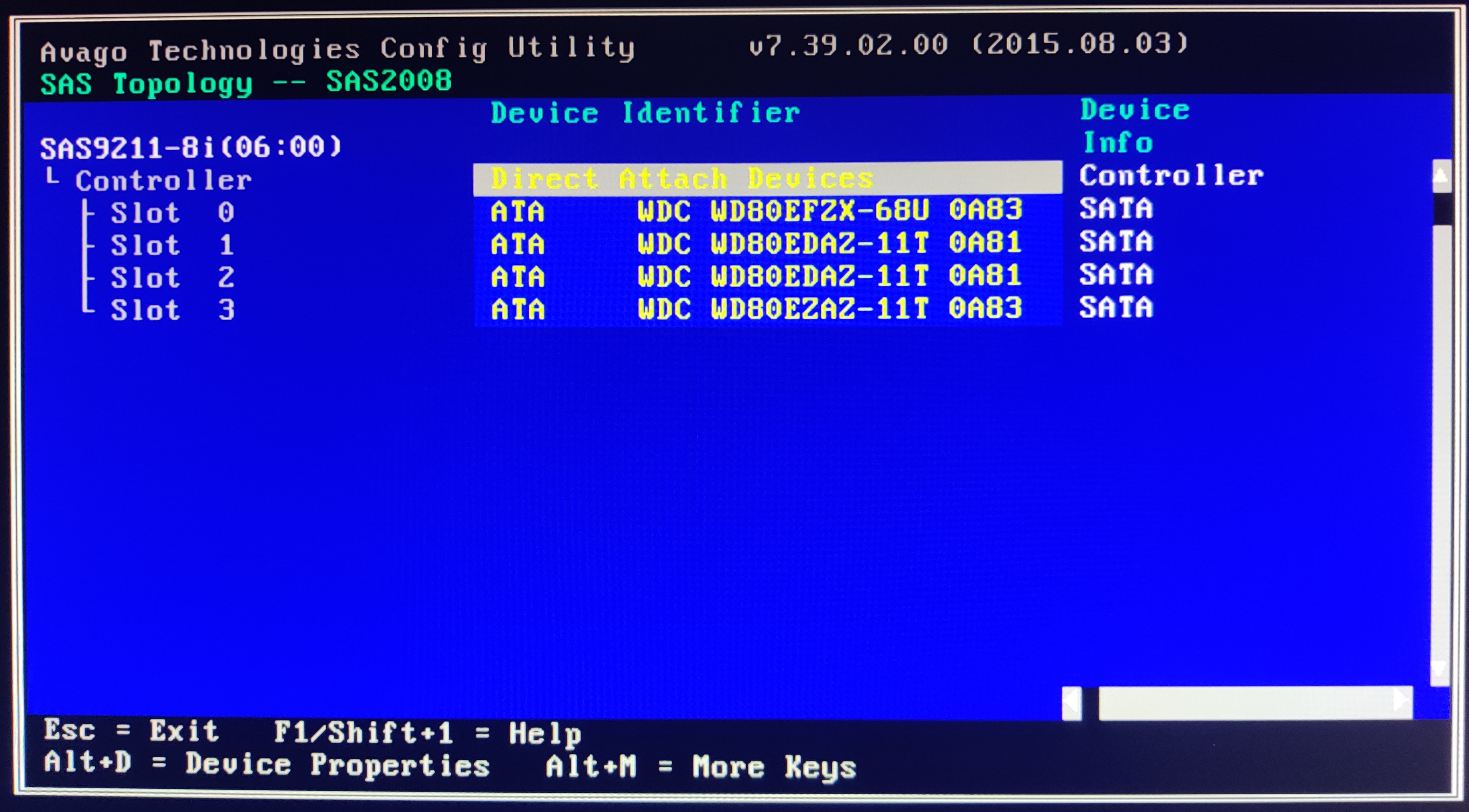

  7. Here are the screens. Only 4 drives detected.

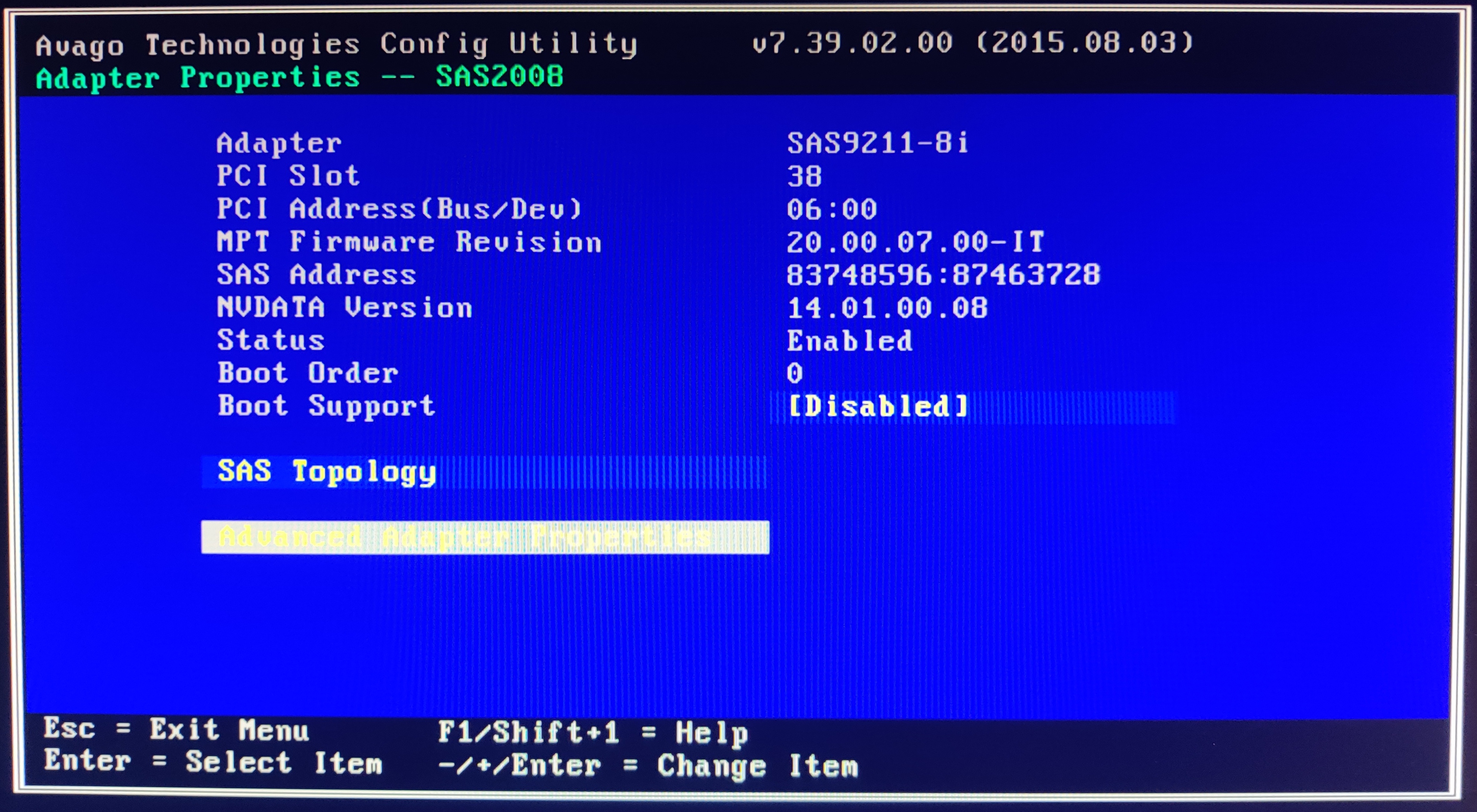

  8. I don't know what you mean by that. It goes from the AMIBIOS screen directly to dmesg messages without any screen in between where i could press F2.
  9. Here is my A11 with A21 SBR: *-disk:0 description: ATA Disk product: WDC WD80EZAZ-11T vendor: Western Digital physical id: 0.0.0 bus info: scsi@9:0.0.0 logical name: /dev/sda version: 0A83 serial: NO size: 7452GiB (8001GB) capacity: 7452GiB (8001GB) capabilities: 15000rpm gpt-1.00 partitioned partitioned:gpt configuration: ansiversion=6 guid=c62d29d7-7fd7-483a-99a2-10e2c678a6da logicalsectorsize=512 sectorsize=4096 *-disk:1 description: ATA Disk product: WDC WD80EDAZ-11T vendor: Western Digital physical id: 0.1.0 bus info: scsi@9:0.1.0 logical name: /dev/sdb version: 0A81 serial: NO size: 7452GiB (8001GB) capacity: 7452GiB (8001GB) capabilities: 15000rpm gpt-1.00 partitioned partitioned:gpt configuration: ansiversion=6 guid=d55f6d5e-290c-4f42-8acc-a70d238537f1 logicalsectorsize=512 sectorsize=4096 *-disk:2 description: ATA Disk product: WDC WD80EFZX-68U vendor: Western Digital physical id: 0.2.0 bus info: scsi@9:0.2.0 logical name: /dev/sdc version: 0A83 serial: NO size: 7452GiB (8001GB) capacity: 7452GiB (8001GB) capabilities: 15000rpm gpt-1.00 partitioned partitioned:gpt configuration: ansiversion=6 guid=faa13e2b-c07e-474b-86ac-3ee2457b1ad2 logicalsectorsize=512 sectorsize=4096 *-disk:3 description: ATA Disk product: WDC WD80EDAZ-11T vendor: Western Digital physical id: 0.3.0 bus info: scsi@9:0.3.0 logical name: /dev/sdd version: 0A81 serial: NO size: 7452GiB (8001GB) capacity: 7452GiB (8001GB) capabilities: 15000rpm gpt-1.00 partitioned partitioned:gpt configuration: ansiversion=6 guid=0eca972d-aa6b-41fc-b942-deb1f60f1b74 logicalsectorsize=512 sectorsize=4096 All 4 disk are connected to the same fan cable to one HBA port. The 5th is not connected at this time. Here is lshw with the same 4 drives connected to the other HBA port. *-disk:0 description: ATA Disk product: WDC WD80EZAZ-11T vendor: Western Digital physical id: 0.0.0 bus info: scsi@9:0.0.0 logical name: /dev/sda version: 0A83 serial: NO size: 7452GiB (8001GB) capacity: 7452GiB (8001GB) capabilities: 15000rpm gpt-1.00 partitioned partitioned:gpt configuration: ansiversion=6 guid=c62d29d7-7fd7-483a-99a2-10e2c678a6da logicalsectorsize=512 sectorsize=4096 *-disk:1 description: ATA Disk product: WDC WD80EDAZ-11T vendor: Western Digital physical id: 0.1.0 bus info: scsi@9:0.1.0 logical name: /dev/sdb version: 0A81 serial: NO size: 7452GiB (8001GB) capacity: 7452GiB (8001GB) capabilities: 15000rpm gpt-1.00 partitioned partitioned:gpt configuration: ansiversion=6 guid=d55f6d5e-290c-4f42-8acc-a70d238537f1 logicalsectorsize=512 sectorsize=4096 *-disk:2 description: ATA Disk product: WDC WD80EFZX-68U vendor: Western Digital physical id: 0.2.0 bus info: scsi@9:0.2.0 logical name: /dev/sdc version: 0A83 serial: NO size: 7452GiB (8001GB) capacity: 7452GiB (8001GB) capabilities: 15000rpm gpt-1.00 partitioned partitioned:gpt configuration: ansiversion=6 guid=faa13e2b-c07e-474b-86ac-3ee2457b1ad2 logicalsectorsize=512 sectorsize=4096 *-disk:3 description: ATA Disk product: WDC WD80EDAZ-11T vendor: Western Digital physical id: 0.3.0 bus info: scsi@9:0.3.0 logical name: /dev/sdd version: 0A81 serial: NO size: 7452GiB (8001GB) capacity: 7452GiB (8001GB) capabilities: 15000rpm gpt-1.00 partitioned partitioned:gpt configuration: ansiversion=6 guid=0eca972d-aa6b-41fc-b942-deb1f60f1b74 logicalsectorsize=512 sectorsize=4096 It does not seem to be a problem with the ports.
