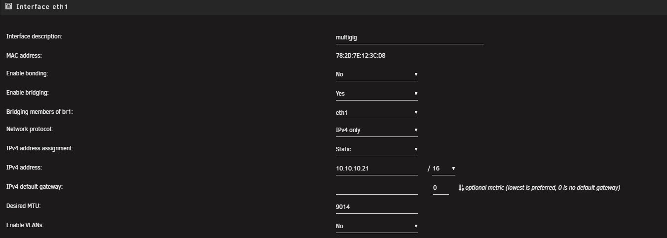

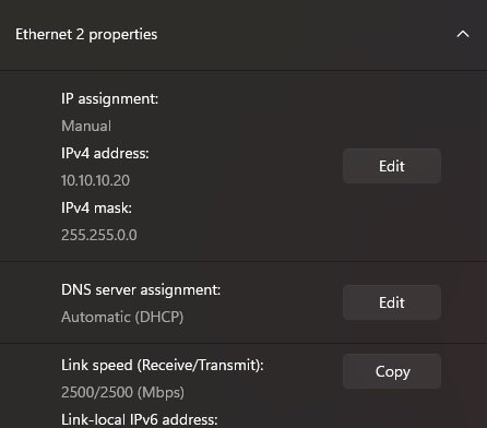

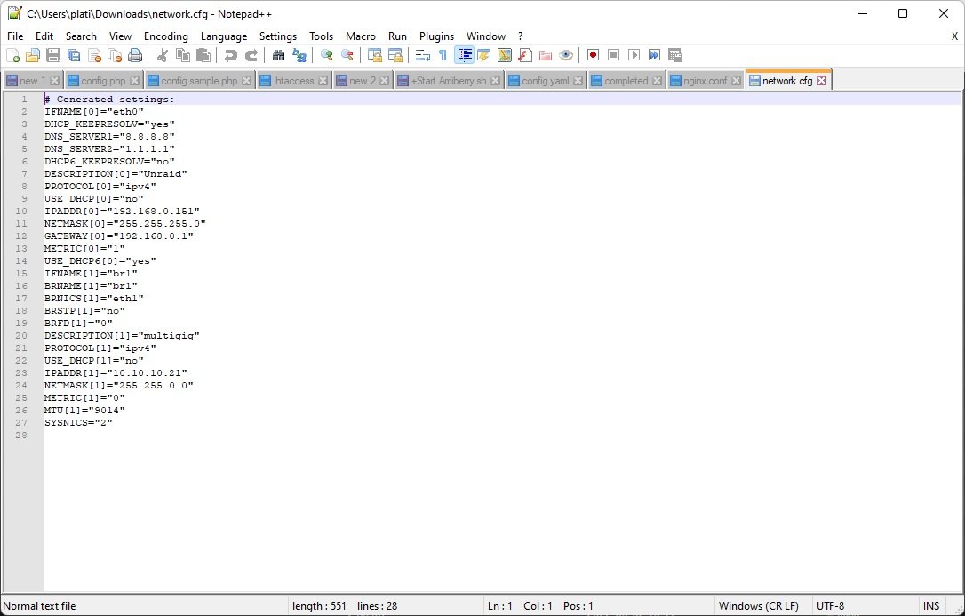

  11. On Unraid server Pro, version 6.10.0-rc5 I have just recently purchased 2 2.5gb nics. one for my windows pc, and one for my unraid server. I still rip from disks, and have been doing tons of 4k. (my interwebs isn't very fast out in the country, fixed wireless) When my SSD on my windows pc gets close to full, I transfer the files over the network. *What I have* PC 1gb nic to unmanaged 1gb switch to router to 1gb switch to unraid 1gb nic. *What I'm trying to do* What I want to set up is 2.5gb nic pc directly to 2.5gb nic on the unraid. on its own subnet. the rest of my house is on 192.168.0.x, and I will be doing this P2P network 10.10.10.x. I want to transfer the files directly over the 2.5gb nics instead of my local network. What am I missing? I can ping the unraid IP from the windows PC, but cant see the windows nic from the unraid machine. I have the windows side of it set to private, also no gateway set, and a mask of 255.255.0.0. Unraid side I have no gateway set, /16 subnet mask. Attached is my network config for UnRaid, I'll also attach my windows settings. network.cfg
