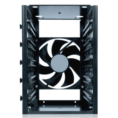

  7. I like the look of these...might order one to see if it will fit in a 5 bay HDD enclosure. Ebay ID 220626683956
