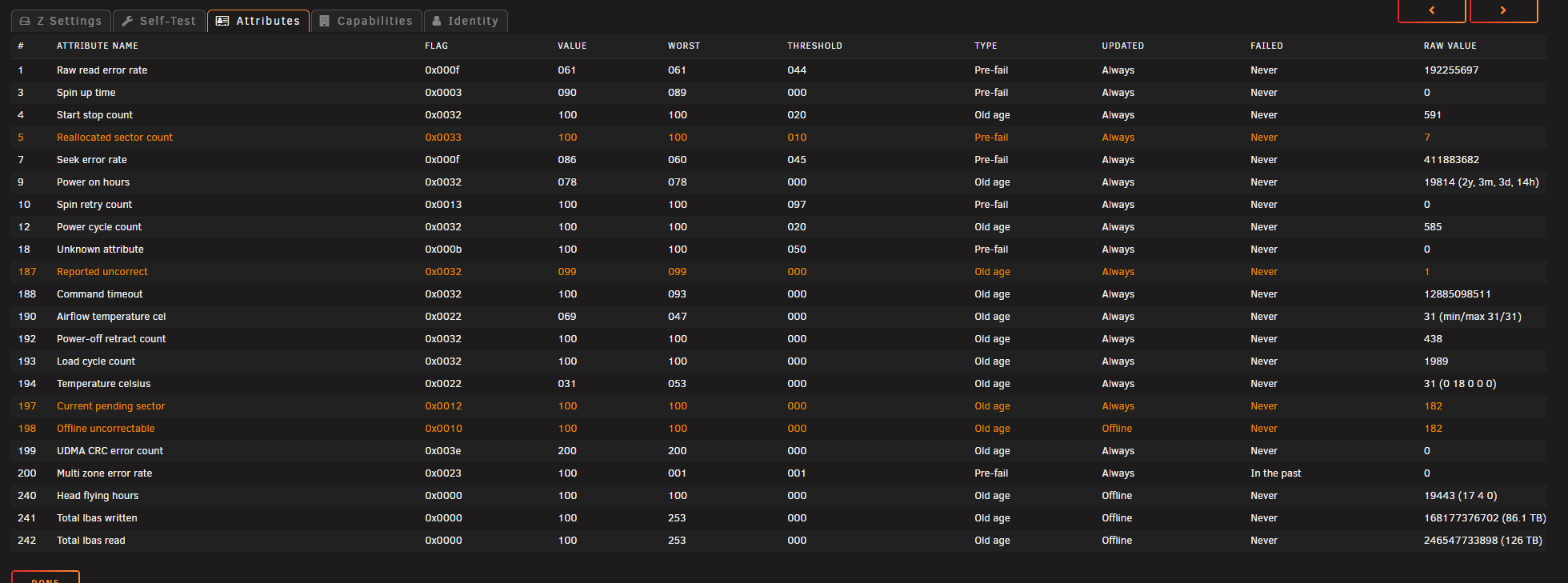

  7. Yup here is the smart of the failed drive.

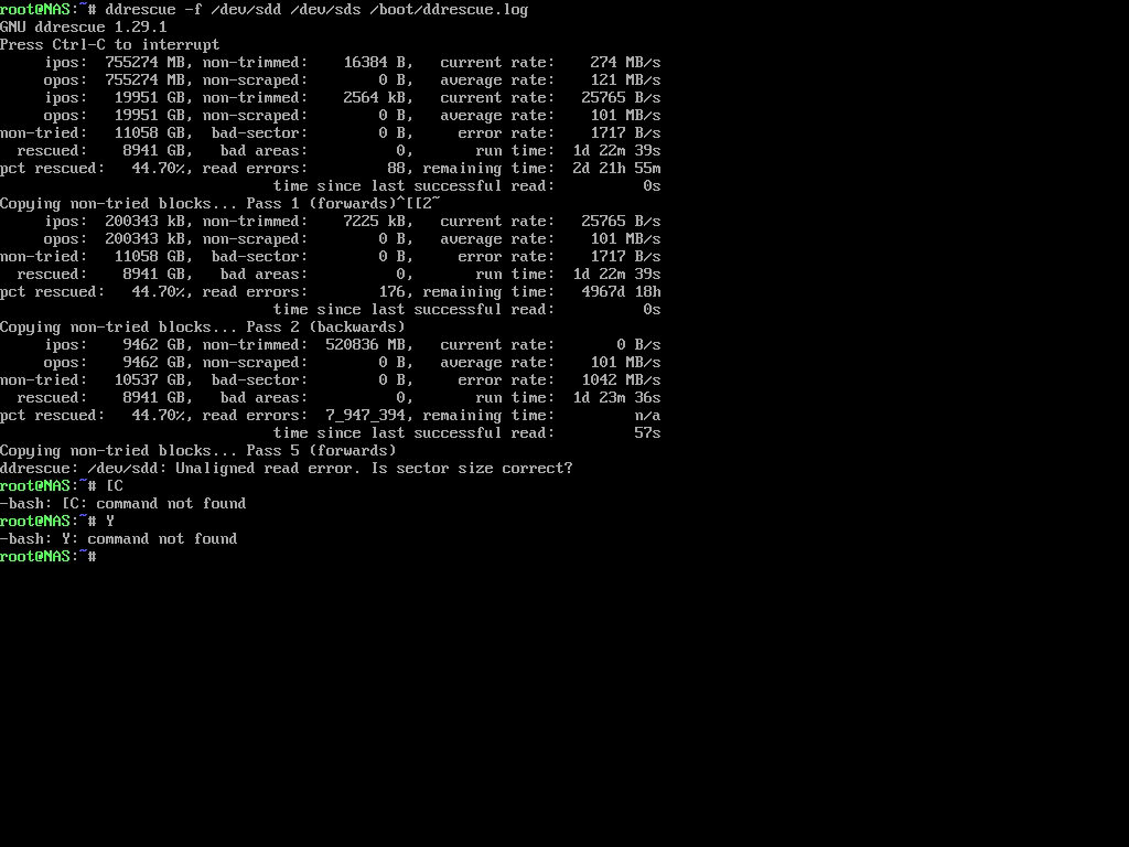

  13. Hi again @JorgeB i did and it resume to this is this correct? or should i start over? is this is normal?
  14. Got it i read online that i should use -D if i encounter this error should i or should i proceed with your recommended command? Thanks again for the fast reply @JorgeB
  15. Hi @JorgeB Did it fail or is this normal? omg what happened?

  18. Hi my replacement drive just arrived, again i am sorry i am not that techie and i am already afraid i might damage some important data what is the best command i can run using this ddrescue? any help will be appreciated Thanks!
