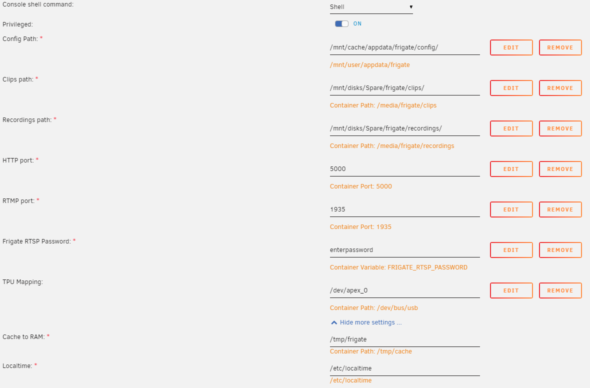

  9. Ok just trying it now with https://github.com/pdecat/frigate-hass-addons/
  10. Hi thanks for that but when i go to https://github.com/pdecat/frigate-hass-addons I'm getting a 404 page not found https://github.com/pdecat/frigate-hass-addons/blob/main/frigate_beta_old/README.md Sorry if I am doing something daft 😞
  11. Hi all, hope someone can please help i have unraid and this docker working perfectly on one system but its a real power hog so I have been trying to get this working on my hp proliant nl36 which only has a AMD Athlon II, 2 core 1.30GHz CPU. From what I have found out this CPU does not support AVX, and I think that is what is causing this error below, Iv also asked on the Home Assistant forum post for Frigate but I did not get any replies. Any suggestions appreciated, thanks https://github.com/blakeblackshear/frigate/issues/49 ``` * Starting nginx nginx ...done. Fatal Python error: Illegal instruction Current thread 0x00001553e214a740 (most recent call first): File "<frozen importlib._bootstrap>", line 219 in _call_with_frames_removed File "<frozen importlib._bootstrap_external>", line 1101 in create_module File "<frozen importlib._bootstrap>", line 556 in module_from_spec File "<frozen importlib._bootstrap>", line 657 in _load_unlocked File "<frozen importlib._bootstrap>", line 975 in _find_and_load_unlocked File "<frozen importlib._bootstrap>", line 991 in _find_and_load File "<frozen importlib._bootstrap>", line 219 in _call_with_frames_removed File "<frozen importlib._bootstrap>", line 1042 in _handle_fromlist File "/usr/local/lib/python3.8/dist-packages/tflite_runtime/interpreter.py", line 36 in <module> File "<frozen importlib._bootstrap>", line 219 in _call_with_frames_removed File "<frozen importlib._bootstrap_external>", line 783 in exec_module File "<frozen importlib._bootstrap>", line 671 in _load_unlocked File "<frozen importlib._bootstrap>", line 975 in _find_and_load_unlocked File "<frozen importlib._bootstrap>", line 991 in _find_and_load File "/opt/frigate/frigate/edgetpu.py", line 15 in <module> File "<frozen importlib._bootstrap>", line 219 in _call_with_frames_removed File "<frozen importlib._bootstrap_external>", line 783 in exec_module File "<frozen importlib._bootstrap>", line 671 in _load_unlocked File "<frozen importlib._bootstrap>", line 975 in _find_and_load_unlocked File "<frozen importlib._bootstrap>", line 991 in _find_and_load File "/opt/frigate/frigate/app.py", line 19 in <module> File "<frozen importlib._bootstrap>", line 219 in _call_with_frames_removed File "<frozen importlib._bootstrap_external>", line 783 in exec_module File "<frozen importlib._bootstrap>", line 671 in _load_unlocked File "<frozen importlib._bootstrap>", line 975 in _find_and_load_unlocked File "<frozen importlib._bootstrap>", line 991 in _find_and_load File "/opt/frigate/frigate/__main__.py", line 7 in <module> File "/usr/lib/python3.8/runpy.py", line 87 in _run_code File "/usr/lib/python3.8/runpy.py", line 194 in _run_module_as_main ```
