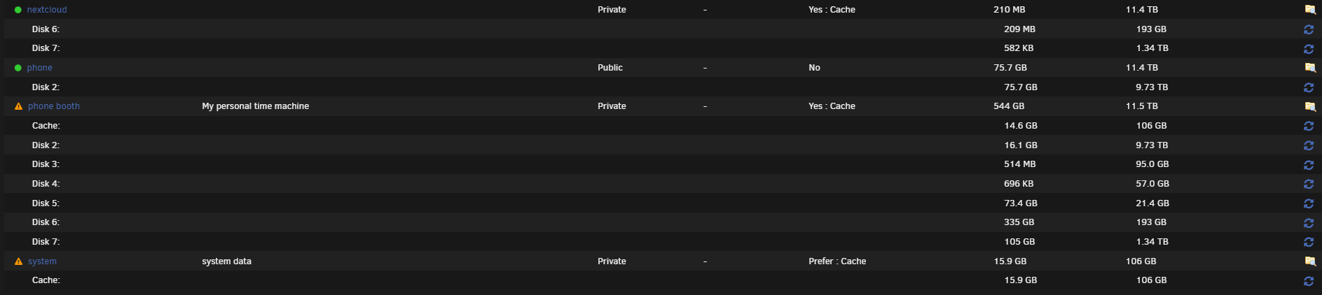

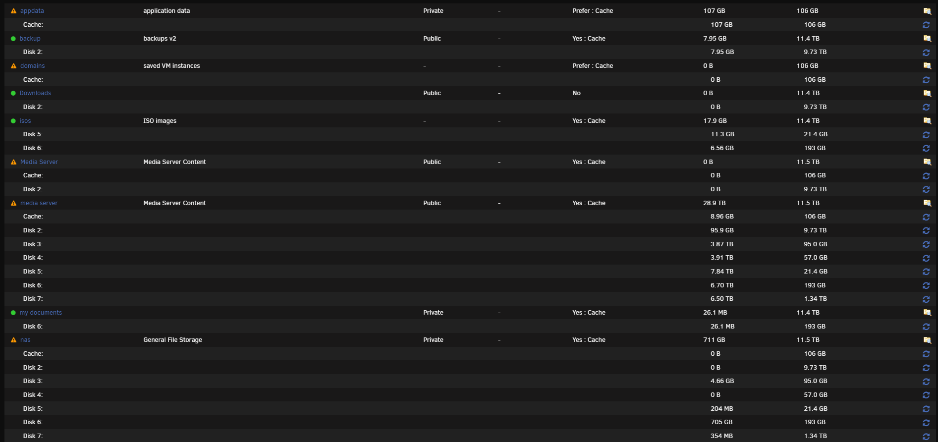

  5. cassandra-diagnostics-20211112-0750.zip
  6. My media is all contained in a share called "media server". Another share, "Media Server" is created automatically, that only contains the folders from the original share, but no files. Is there some way to see what is causing it to be created? I have triple checked my Docker containers and I can not find any reference to the capitalized configuration.
