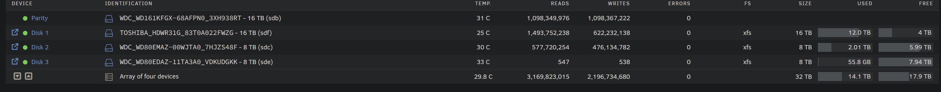

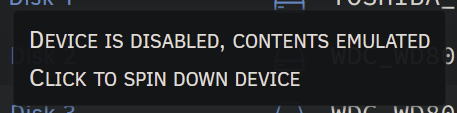

After a bit of delay I have replaced the power Molex to SATA adapter with 3 SATA splitters (with the correct pins blocked for a couple of drives that were shucks) and I'm still right where I started with one disk saying its missing. Or to be exact it says: *attached image*
