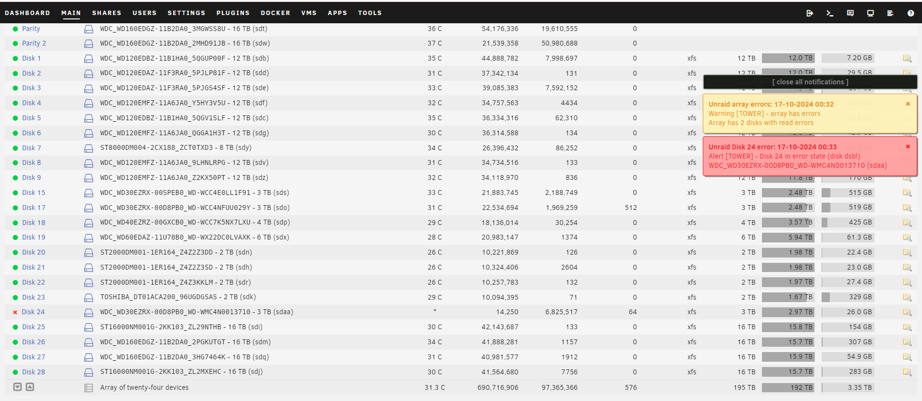

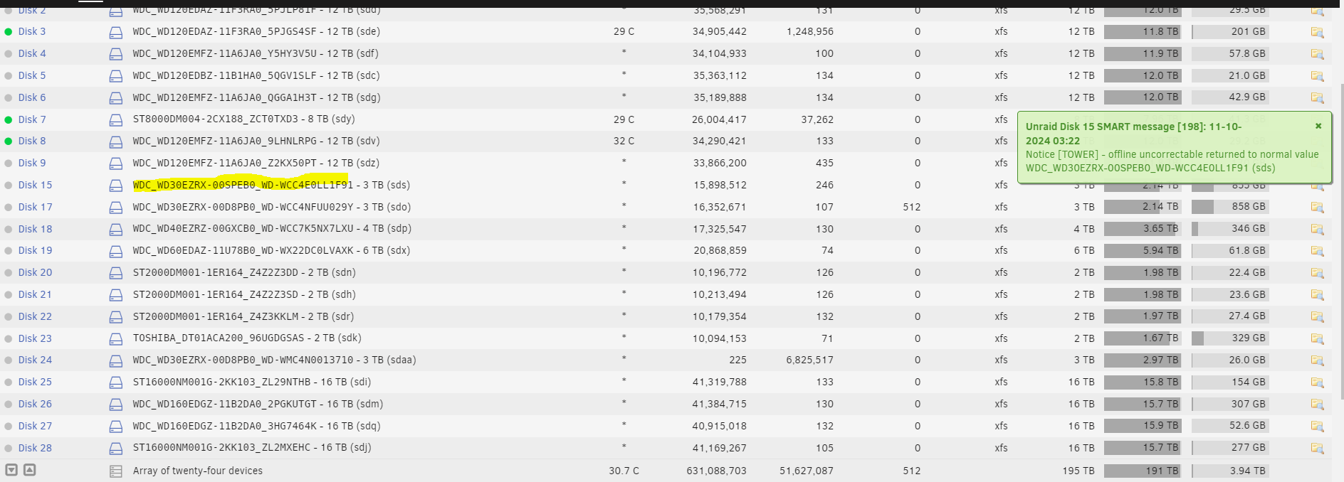

  1. Had the drive go into error state again, listed logs and screen shot in case anyone is able to help point me in the right direction tower-diagnostics-20241017-1010.zip
  2. came back as clean, took most the day to run, still running a rebuild on the drive so not running much else, when it errors out a drive again Ill post more logs
  3. So last night I had a drive drop out again but this time it was able to correct the drive on its own, first time thats ever happened but same issue still happening tower-diagnostics-20241011-1348.zip

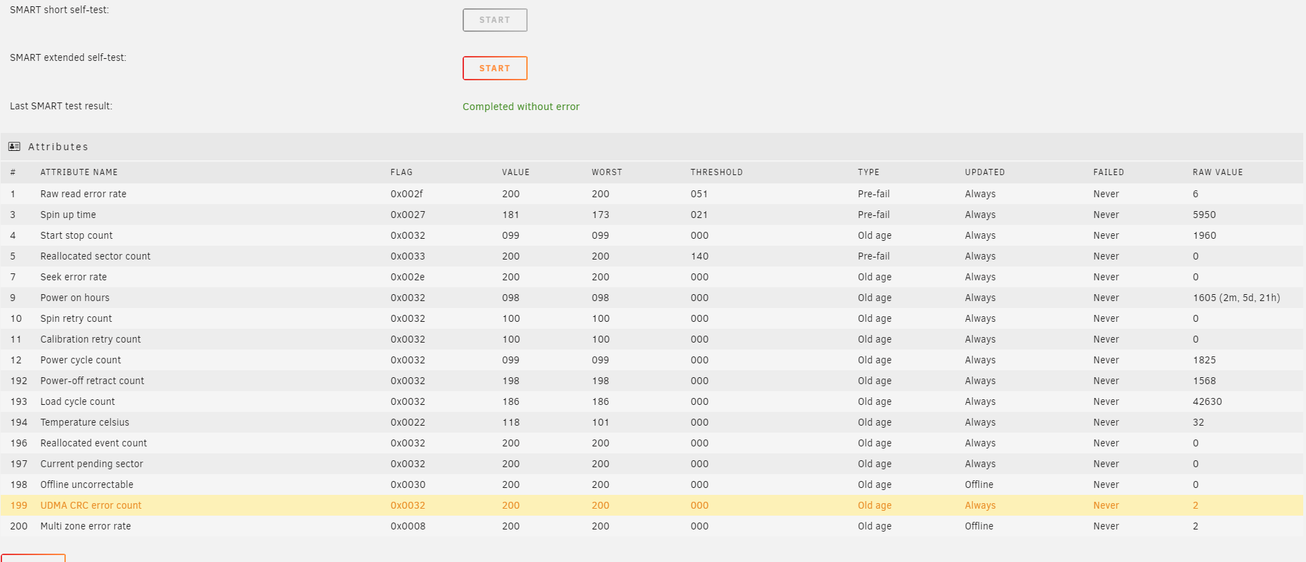

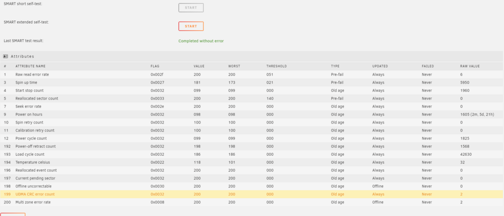

  4. Im running a dell R710 6 drive bays with 2 psu and a disk shelf DS4246 with 4 psu, I have both the server and disk shelf plugged into two separate UPS so power outages wont damage the drive/os with unclean shut downs, recently changed out the batteries as they were getting old, I havent filled up the entire drive bay yet but this issue isnt new though its gotten worse lately. It used to only happen when I ran a vm windows and when it was downloading and reading from the same disk I could get I/O fails and it would error the disk out and Id have to go through the process of unmounting and mounting again. but now it seems to happen even more lately even when not using the vm. only recent change is a did add a few new dockers, as long as I keep it to just my dns and plex is wont have an issue but the moment I start spinning up the other dockers, its random when it will happen a day later , 7 days later and hour. I cant say for sure its not a power issue, but I do have the max psu units i can for my system and did upgrade them to the max size, which wasn't much given how old the equipment is and its compatibly. Is there a way I can test or something i can run to find out or have a better idea of the issue? Im not using any power spliters

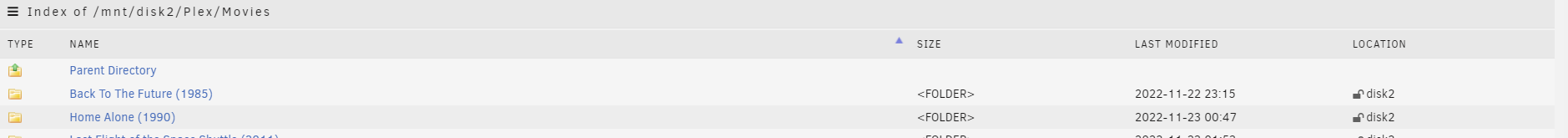

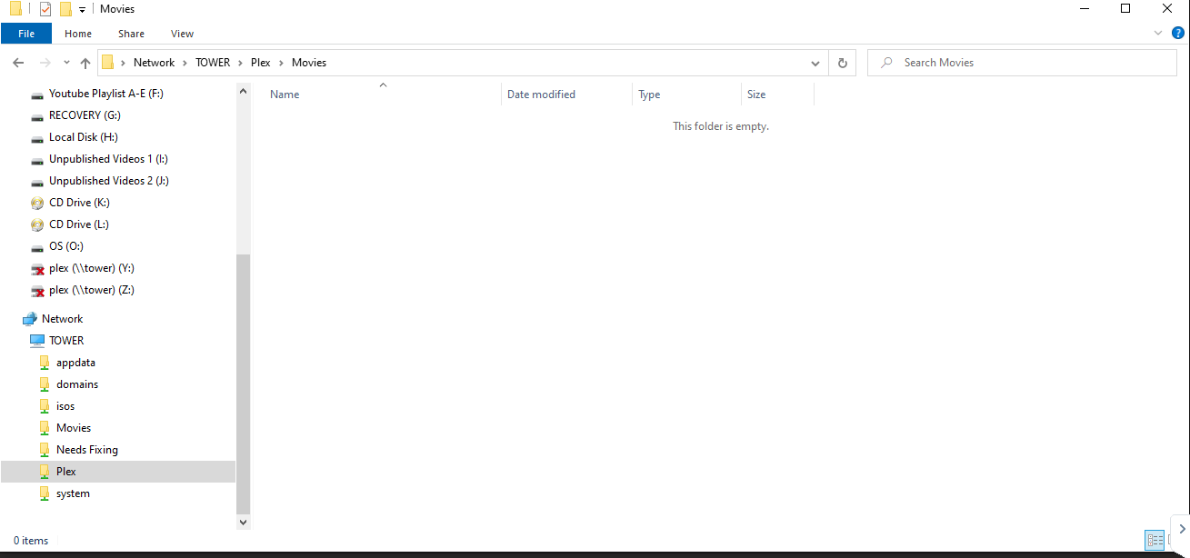

  13. quick update it looks like all the files are still there but two folders, both the largest on the unraid that had video files are now empty except I can still go into the drives on unraid and go under the folders there and download the video files and they work they simply dont show up in the network section of the file folders any more

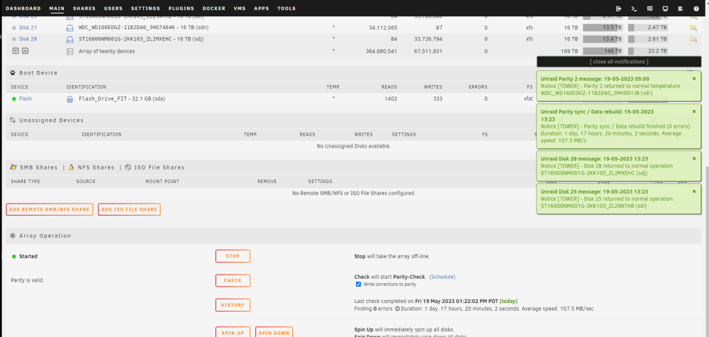

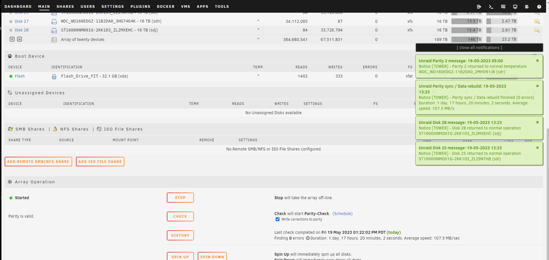

  14. so looks like it rebuilt the two hard drives just fine this time, didnt find any errors like last time. I havent spun up any of the vm's or tried to access the information yet. going to try that next but ran a diag and took a screen shot as well. if there are any other precautions I should try let me know. I also disabled the parity backup during all this just in case but will turn it back on in a few days if all goes well. tower-diagnostics-20230519-1820.zip
