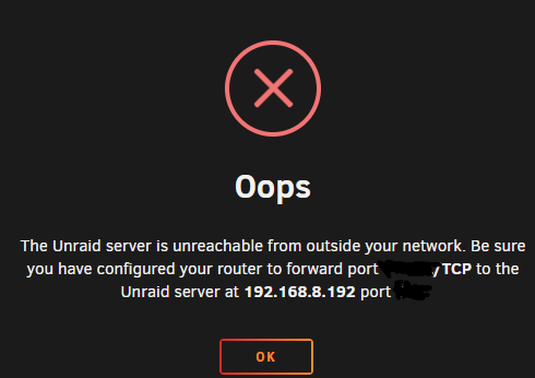

  2. I tried remote access from work today and got the following. I've reviewed my port forwarding rules and am reasonably confident they are good (considering it doesn't work) . I have a friend that also uses Unraid and he reviewed my forwarding settings and also could not find fault. I went to unplug an ethernet cable from my router and noticed the router was extremely hot so it's possible I've an unusual hardware issue. As a precaution I intend to swap out my router in the coming days. Thanks for the assistance so far, I will post again when I've something new to try or have new hardware. Have a good weekend!!!

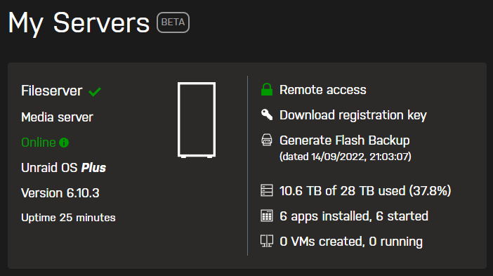

  6. Hi, I've recently been unable to remote into Unraid. I had previously had no issue remoting in. I've reviewed my routers forwarding settings and they are unchanged. I get the following error which led my to doubt my router config. See below fileserver-diagnostics-20220914-2122.zip I have reset my router and copied the settings (that once worked) back after the reset but to no avail. While viewing the MyServers Dashboard I can see remote access is available, so I think I'm signed in correctly. If anyone has an insight I'd appreciate it. It may be irrelevant but the first time I encountered the issue I was remoting/remoted in and someone at home unplugged the router while my session was active. I've added a log also. Thanks again
