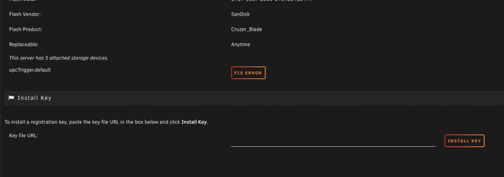

  4. Sorted it - 6.9.1 was screwed up from a restore with regard to re-registering the key remotely. I was also getting 'upc' and other browser errors. I just upgraded the server to latest, then re-registered and it worked!
  5. Hi All. My server USB failed, fortunately I am using the unraid.net backup and have a fairly recent backup. I have restored the backup to a fresh USB as per the guide and the server boots, all good. I have downloaded my basic.key and dropped into the config folder on the USB. However, when I click on 'registration key' - instead of seeing 'Replace Key' button, I see the following upcTrigger.default 'Fix". The fix button doesnt do anything and I am now stuck.. please help Im on Unraid 6.9.1
