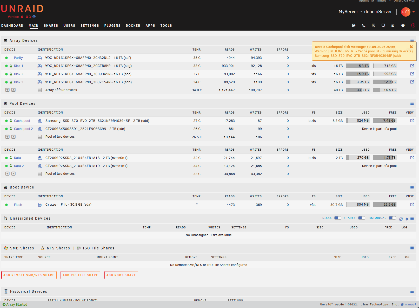

Cachepool not working after swapped disk
Hi all, I have a cachepool with two discs. sde stopped working so I took it out of the pool (which was in RO mode) and replaced it with the new SSD (again sde). I added the new sde to the pool again and restart the array. I'm still getting an error (Surprisingly about sdd (had the same error while the pool was running without a second device.)) And I still cannot use shares that use cachepool. I can see the files but it's the read only, I think. Any ideas what to do?
