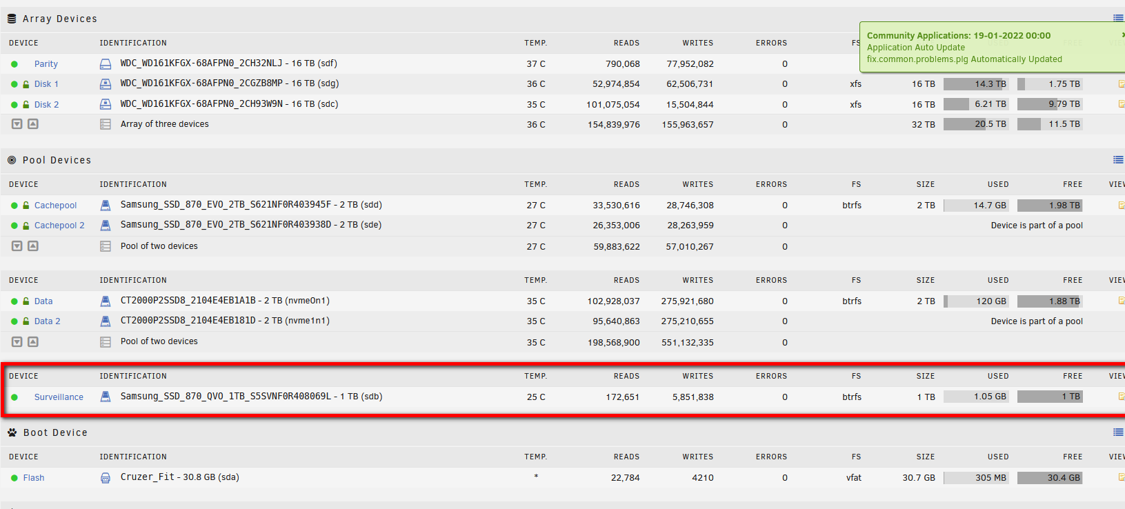

i have a single drive array with just one share on it. I would like to change the drive to have a larger one instead. It's ok if i loose the current data on the drive (just old cctv footage).
Can i just remove the old disk from the system. install the new one. boot. Assign the new one to the existing array?
- Will it "miss" the old disk?
- Is there share automatically using the new disk?
Thanks
 Dennis

the server has multiple arrays, so there are more disks and no slots left ;( - just the array i would like to upgrade has a single disk i want to swap

ok, one issue - the disk is not formatted
How can i prepare the disk as i did when i created the pool for the first time

maybe one more unrelated question that just came to my mind:
- the other pools above (data and cachepool) each have 2 drives with 2TB (8TB) each.
The pools have 2tb each - my understanding was that the second drive is a mirror - is that correct?
