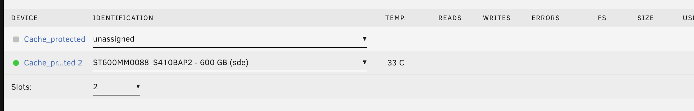

  2. Thanks JorgeB, That solution did indeed erase the duplicates, and seemingly ammended the flash config file. I am still a bit stuck on, the issue shown below.. The "cache_protected" (unassigned) duplicated as cache-protected 2, with 2 slots. Do I just drop to 1 slot and it will keep the assigned device? Or should I be assigning, effetively swapping, the "sde" drive to the "cache_protected" first? Sorry for the numpty question I have not come across this before.

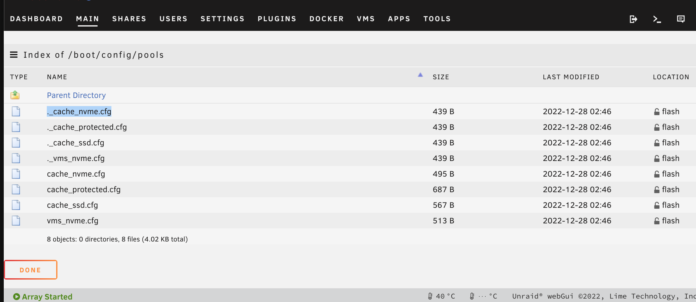

  3. Thanks for that pointer, I think you are right. It does look like there are duplicate spurious entries in the config/pools folder. I am not sure which ones to delete. I am assuming its the files starting with"._" as they don't look right to me?

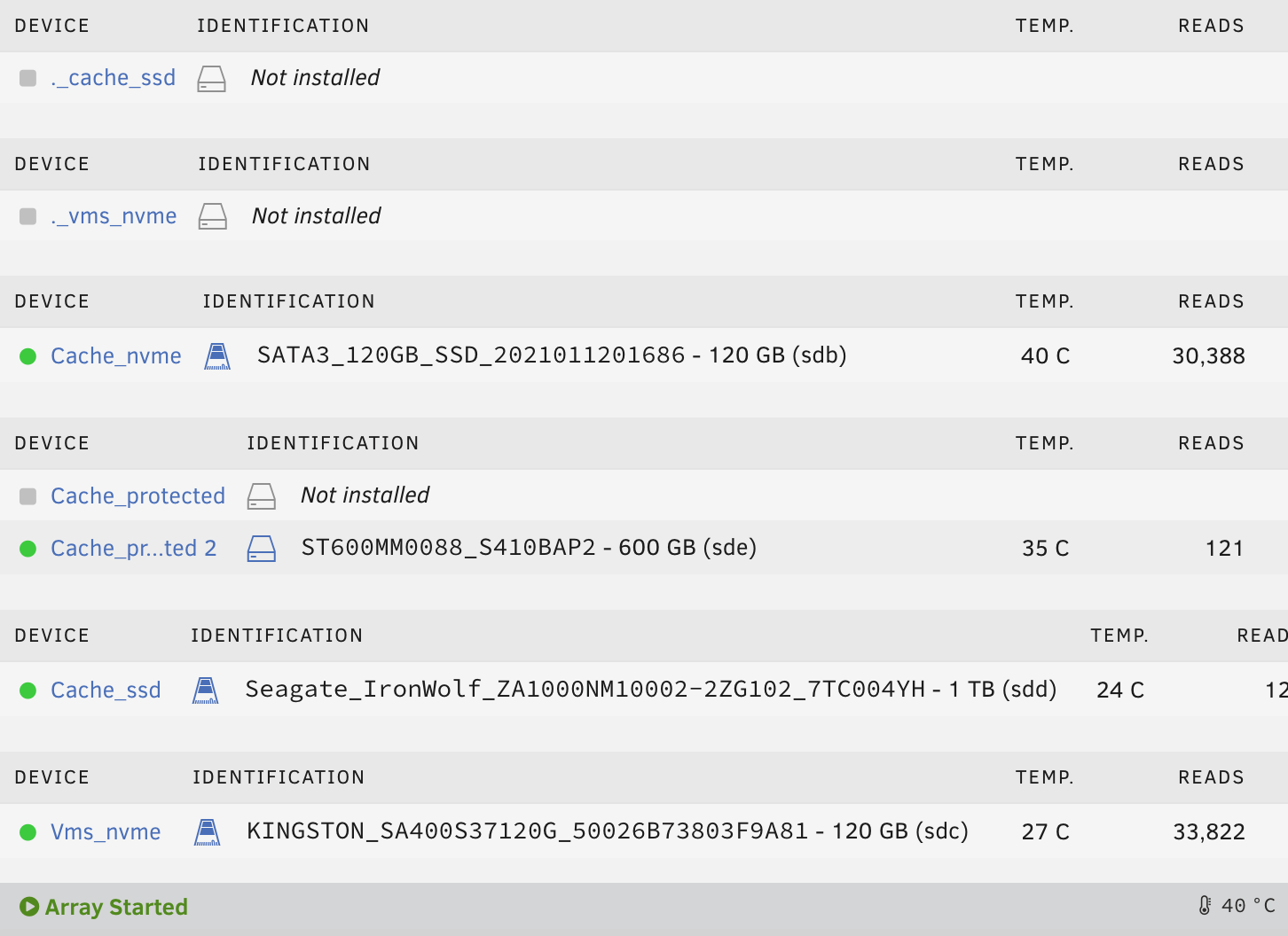

  4. Upgraded from 6.9.2 to 6.11.5, having attempted several times with everything inbetween and had issues only resolved by reverting back to 6.9.2. 6.11.5 now seems to be fine, upgrading my Dell T320, however a strange issue with my Pool Devices has presented itself. They all seem to have duplicated; one version showing "not installed" the other looking normal with the disk identified etc. Everything seems to be operating fine, it just triggers my OCD to have the "not installed" devices showing. What should I be doing to clean things up? Any suggestions welcomed... tower-diagnostics-20221228-1020.zip
