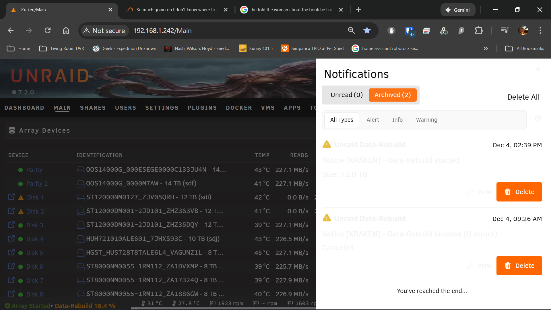

  2. Back on topic my servers data rebuild is at 80 % and 5 hours. Everything is looking good.

  5. Okay everything looks good as it is data rebuild is running. Right now it's at 235 MB/ sec and hover at 14 Hours. If nothing happens I will lets you know when it completes and marked as completed. I don't have the extra money until Wednesday but I am setting a reminder to send you something then. As I said thank you. Now I am going to take what I have learned and use it fixing similar issues on a backup Unraid system that I started after this one went down.

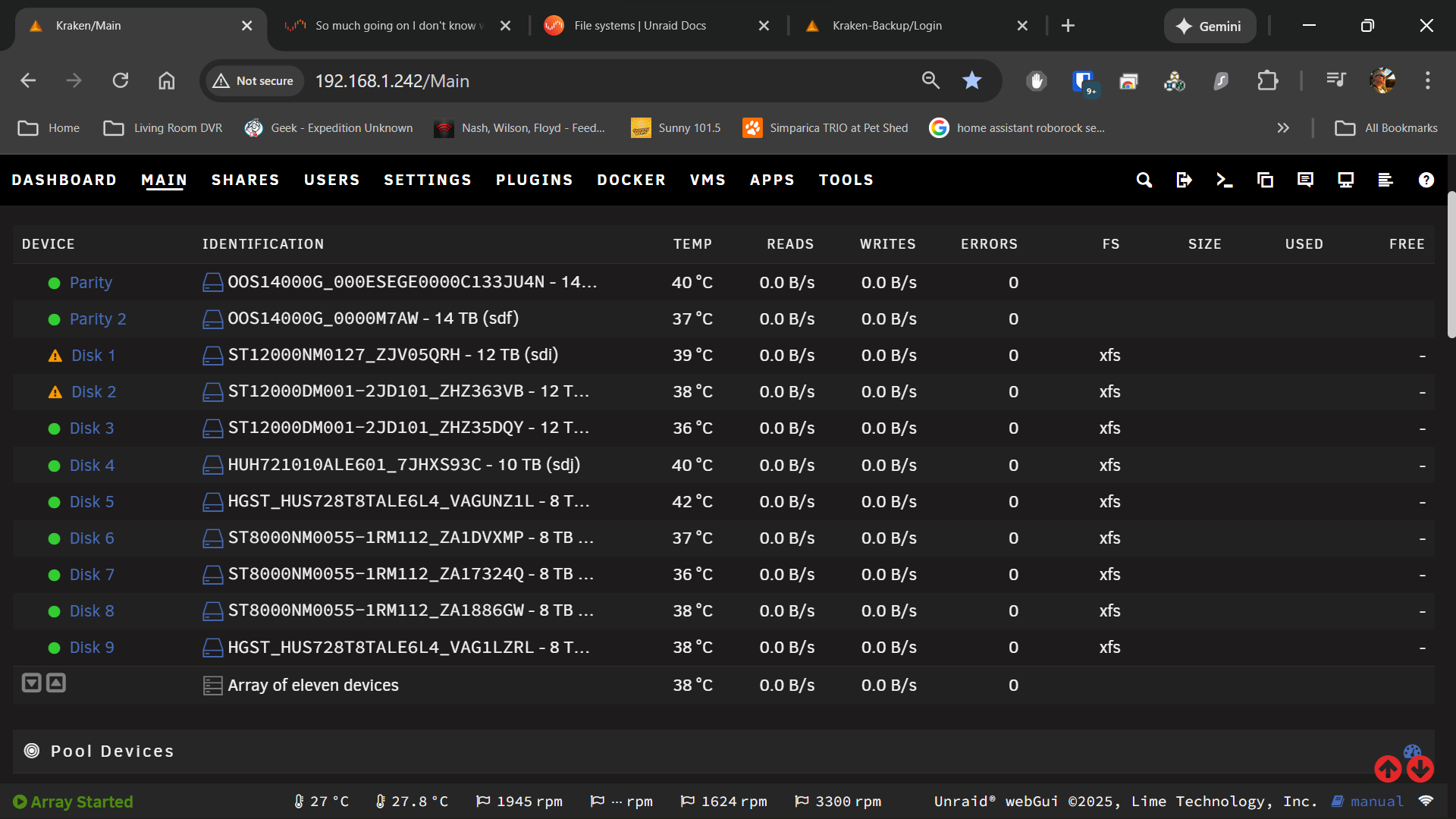

  6. Thanks. Disk 1 says "File system corruption fixed." Should I run check again to verify? If not I will move on to Drive 2. Assuming that goes the same do I start the array back as normal?

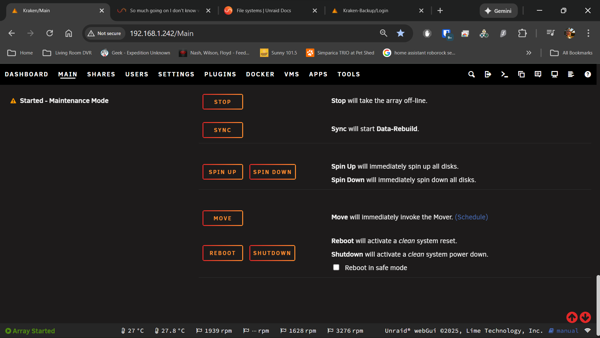

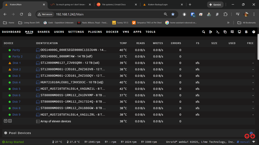

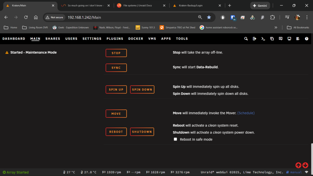

  7. Okay did that on disc 1. and got: "Phase 1 - find and verify superblock... bad primary superblock - bad CRC in superblock !!! attempting to find secondary superblock... .found candidate secondary superblock... verified secondary superblock... would write modified primary superblock Primary superblock would have been modified. Cannot proceed further in no_modify mode. Exiting now. I have the fix button is that Okay to hit?
  8. OK I'm sorry but I went ahead and restarted in maintenance mode for xfs but at the bottom where the check button should be there is no button for check. The is only the sync button. The two drives 1 & 2 both now show xfs (see the screenshot). Should I start the sync and if so should I only rebuild one disk at a time? Again thanks for your help! kraken-syslog-20251204-1445.zip kraken-diagnostics-20251204-0944.zip

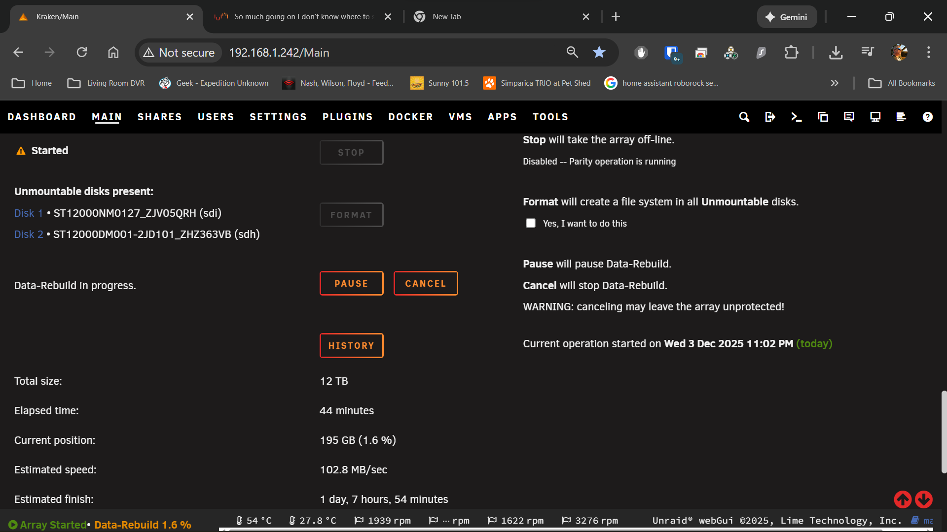

  9. It's at 21% running between 100 MB/ sec to 200 MB/ sec. showing 1 day and 2 hours left. Go ahead and stop parity rebuild and do the file system check and repair?

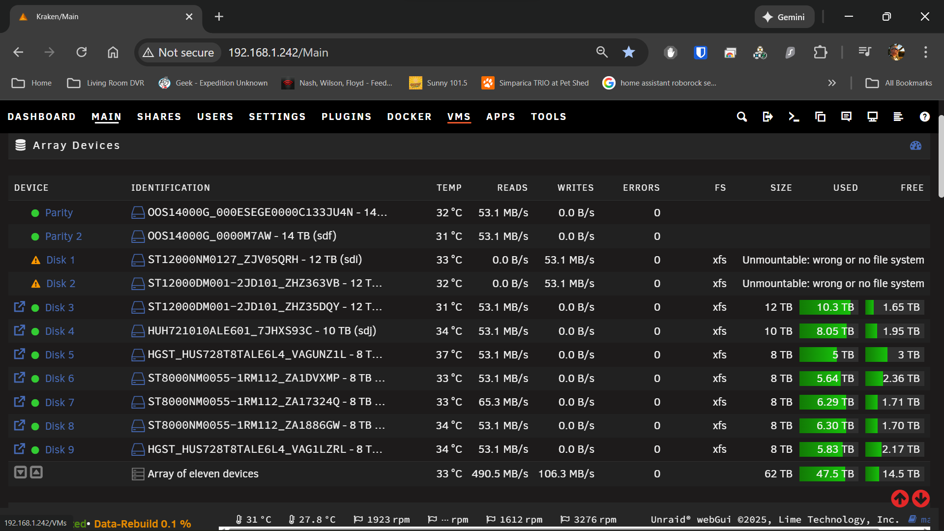

  10. Thank you for the help you provided so far.
  11. I had a break for a bit and got the power cables inspected and tightened up. I also noticed a switch on my power supply that I think is some kind of Eco Switch that I turned off. I'm confused by why disk 1 & 2 say they are "unmountable: wrong or no file system" and it gives me the option to format the two drives just above where it says "Data Rebuild in Progress". So I hope they are okay and are rebuilding. I am going to add the screenshots of the main page. kraken-diagnostics-20251203-2340.zip kraken-syslog-20251204-0442.zip
