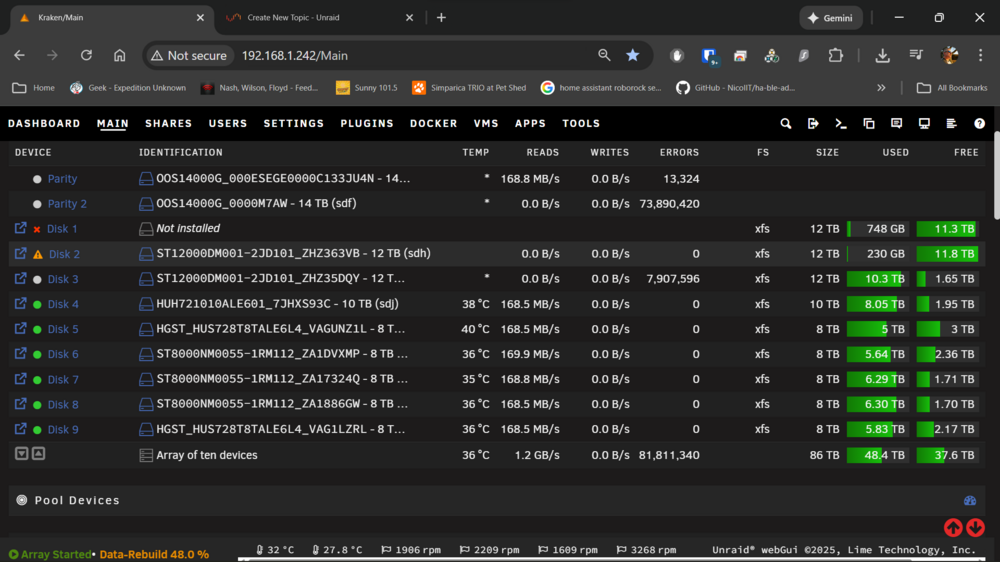

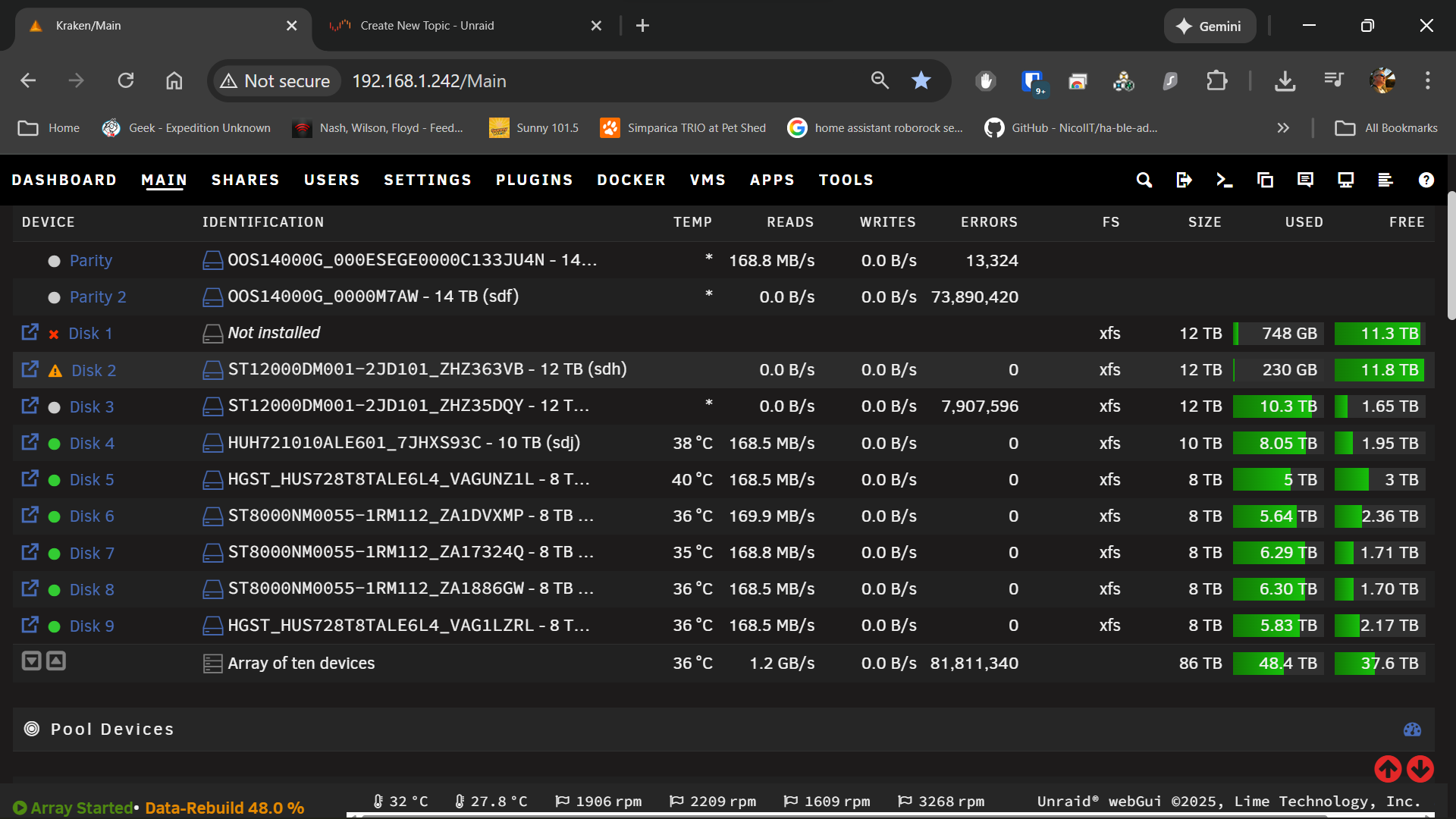

OK I'm sorry but I went ahead and restarted in maintenance mode for xfs but at the bottom where the check button should be there is no button for check. The is only the sync button. The two drives 1 & 2 both now show xfs (see the screenshot). Should I start the sync and if so should I only rebuild one disk at a time? Again thanks for your help! kraken-syslog-20251204-1445.zip kraken-diagnostics-20251204-0944.zip

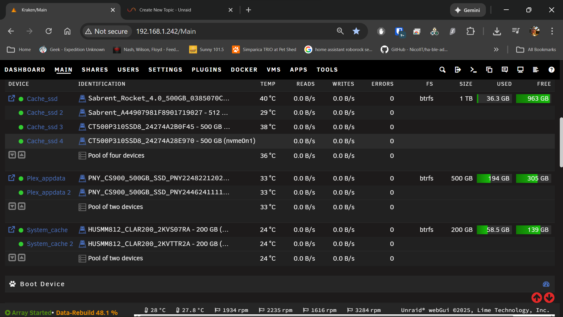

I had a break for a bit and got the power cables inspected and tightened up. I also noticed a switch on my power supply that I think is some kind of Eco Switch that I turned off. I'm confused by why disk 1 & 2 say they are "unmountable: wrong or no file system" and it gives me the option to format the two drives just above where it says "Data Rebuild in Progress". So I hope they are okay and are rebuilding. I am going to add the screenshots of the main page. kraken-diagnostics-20251203-2340.zip kraken-syslog-20251204-0442.zip- So much going on I don't know where to start
