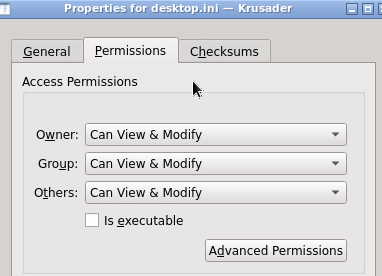

Hello everyone I have spent several hours googling, searching the forums and trying things but nothing helped. Some files on my Array (well in the share I backup my onedrive to from my Windows Machine, but i am certain the error will crop up on other shares at some point) throw the following error Other files on the same Share work without problems. I did try to use Syncthing at one point but the Scan of the Folder took so long every time, that it wasn't feasible. I am not 100% sure but it might be that the errors started back when i was testing that. I just didn't want to delete everything on my Unraid instance unless I have to, especially since I have some symlinks pointing at folders inside my onedrive backup for the foundryvtt instance I am running. I tried the following fixes: Run New Perms The Perms are OK - everyone should be able to R/W according to my chek in Krusader: create a new user, that isn't in any way related to my windows login. Delete all saved credentials in windows several times. I think the files are all on disk2 so started the array in maintenance mode and rand the filesystem check but it didn't find any errors might have not done everything right here. basically added the -nv flag and ran the check in my webgui.

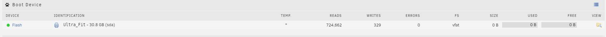

Replacement key shows up with full stats. Seems to have done the trick. I will likely replace the USB as well once I get my new Unraid build. Thanks a ton.

OK will do, got a few USB sticks to spare, but the only ones I have are also quite small Samsung ones, the full size USB sticks I have are all SanDisk - hopefully they are not of teh coutnerfeits. Got them from a reputable dealer here in Switzerland though. I hope they are fine.

I switched my Unraid to a new (temporary) Box about a week ago, since then my Flash gets filled up within about 24 hours of a reboot and the log is filling up rather quick as welll. In Dashboard the Flash is shown as 0B used / 0B free. The Flash itself is only around 500MB, so nowhere near full. I tried multiple USB Ports (both 2.0 and 3.0) and the behaviour stays the same. Any tips what I should check next, or will I have to do regular reboots until I can get new hardware? Or is it "just" my USB failing? mainframe-diagnostics-20220206-2140.zip
