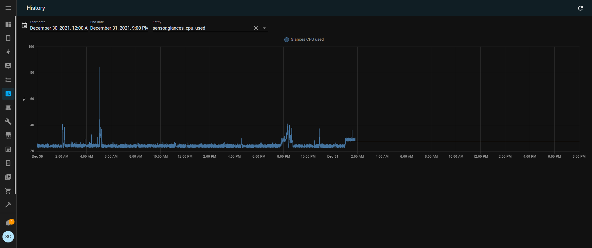

  10. Ok posting a fresh log of this happening ~1 day ago when I was not at home. My Home Assistant shows the server went down at around the same time 1.48 AM syslog
