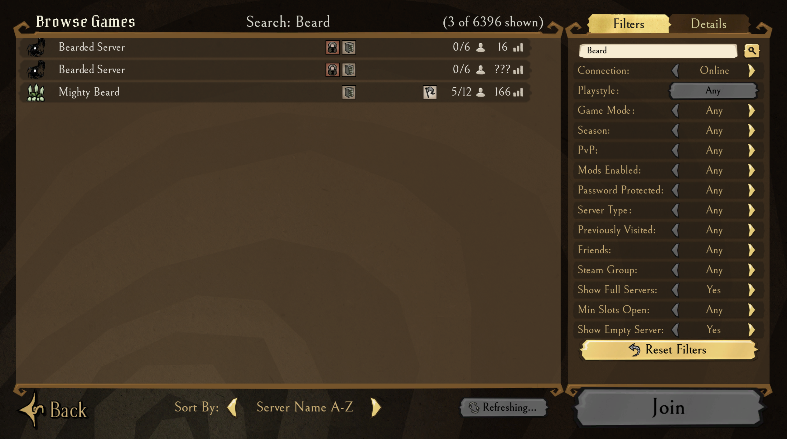

  7. I see it in the logs, which you said was kind of expected. I mean I still see two servers on the server list. I put a screenshot of the in-game server list.

  11. MrBeardSmith joined the community
