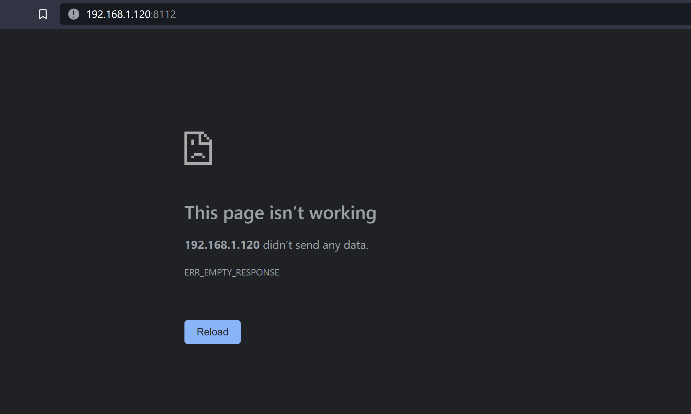

  15. Ok so I ran that command and it returned the following: curl: (52) Empty reply from server Also what's interesting now in the logs this is what is populating: 2021-08-28 20:48:08,110 DEBG 'watchdog-script' stderr output: Unhandled error in Deferred: 2021-08-28 20:48:08,113 DEBG 'watchdog-script' stderr output: Traceback (most recent call last): File "/usr/lib/python3.9/site-packages/twisted/internet/base.py", line 1433, in mainLoop reactorBaseSelf.runUntilCurrent() File "/usr/lib/python3.9/site-packages/twisted/internet/base.py", line 972, in runUntilCurrent f(*a, **kw) File "/usr/lib/python3.9/site-packages/twisted/internet/defer.py", line 477, in callback self._startRunCallbacks(result) File "/usr/lib/python3.9/site-packages/twisted/internet/defer.py", line 580, in _startRunCallbacks self._runCallbacks() --- <exception caught here> --- File "/usr/lib/python3.9/site-packages/twisted/internet/defer.py", line 662, in _runCallbacks current.result = callback(current.result, *args, **kw) File "/usr/lib/python3.9/site-packages/deluge/plugins/Blocklist-1.4-py3.9.egg/deluge_blocklist/core.py", line 444, in import_list File "/usr/lib/python3.9/site-packages/deluge/plugins/Blocklist-1.4-py3.9.egg/deluge_blocklist/core.py", line 544, in auto_detect deluge_blocklist.detect.UnknownFormatError: 2021-08-28 20:49:39,057 DEBG 'start-script' stdout output: [info] Successfully assigned and bound incoming port '49452' 2021-08-28 21:04:39,228 DEBG 'start-script' stdout output: [info] Successfully assigned and bound incoming port '49452' 2021-08-28 21:19:39,413 DEBG 'start-script' stdout output: [info] Successfully assigned and bound incoming port '49452' I am not sure what's going on now LOL. Any ideas? Still cannot access the webui but running curl ifconfig.io still resolves the VPN address. Other containers are still able to to open that I have passing through delugevpn such as radarr/sonarr/sabnzb which is interesting all are also resolving the correct VPN address.
  16. Hey Binhex thanks for the reply. I did confirm my lan network is defined correctly and should be 192.168.1.0/24. It still will not let me connect to the container unfortunately.
  17. Hello all! This is now the second time this has happened to me. What I ended up doing the last time is removing the container entirely and reinstalling it. I cannot access the webui again nor does sonarr/radarr can access delugevpn. Everything was working well for the past 2 weeks and now the same issue. Started a few days ago. I am using PIA, I have tried multiple servers that support port forwarding, checked to make sure the server's port forwarding was up, (Canada, Netherlands, ect.) and still can't access. Checked username/pass all correct. Running curl ifconfig.io resolves the VPN address. I am now at a loss LOL. Because of this now sonarr and raddarr cannot see deulugevpn. Also turned off port forwarding and still the same issue. Any ideas would be much appreciated. Logs attached. Thanks all!supervisord.log
