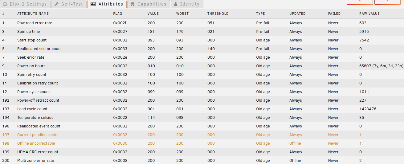

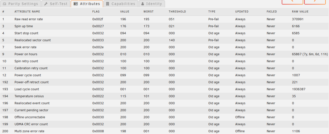

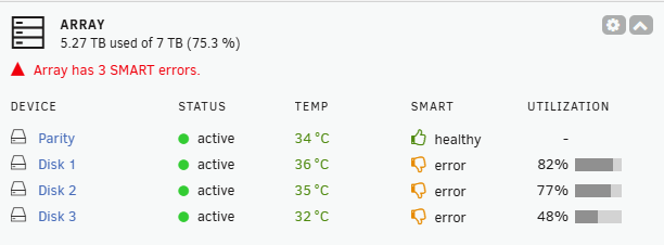

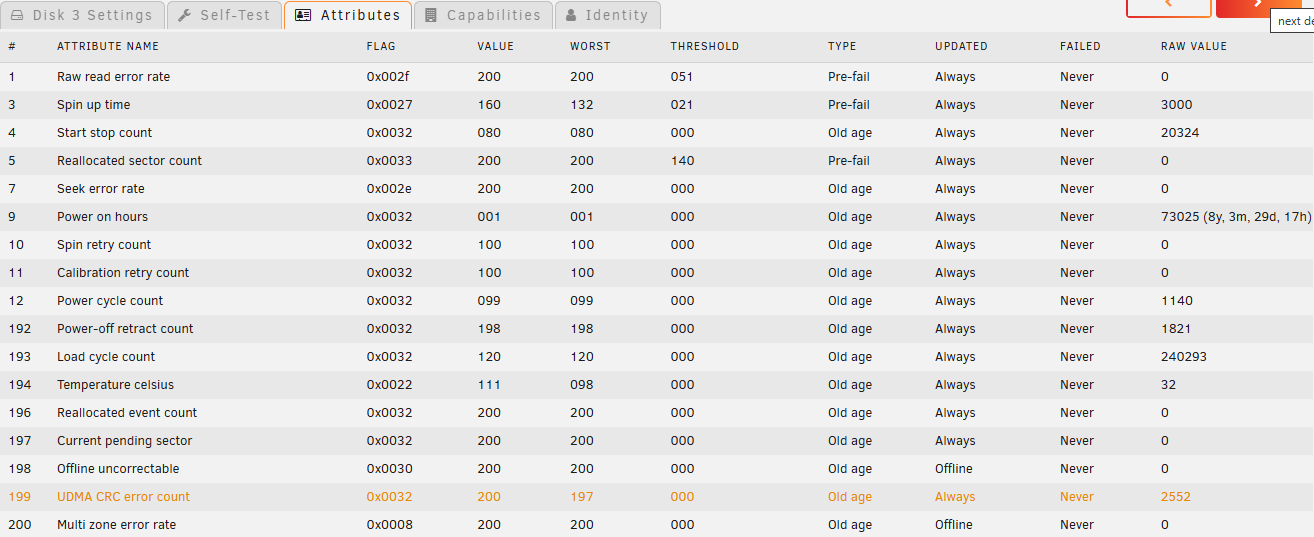

  2. Finally finished the operations. I stopped every service running on the server (Docker, SMB, mover and parity check schedules...). I mounted a new 12TB disk with Unassigned Disk, copied everything in /mnt/user0 into that mount point using the File Manager in the unraid webgui. It took a while. Then did a check of all the data with diff: diff -rq --no-dereference /mnt/user0 /mnt/disks/diskIDIt took another while but no difference were found. Then powered down the system, removed all the HDD, installed the two new 12TB drives and powered up. Used New Config, configured the disk with the data as Disk 1, the other as Parity. Parity operation is still running but everything works like a charm. Thank you for the help. I love unraid :)
  3. Thanks all, I should be receiving the new disks today. I'll try that. Actually I went over the docs (again again) and might have found the solution (although it's in the Legacy documentation): https://docs.unraid.net/legacy/FAQ/replacing-multiple-data-drives/#faster-method Looks a lot like the procedure @ConnerVT was suggesting. I'll disable everything besides the array during the procedure to avoid conflicts (SMB, Docker, mover and parity schedules). Thanks, while powered off, I'll change the SATA cables to be on the safe side. The disks have been showing warnings for a few months now.

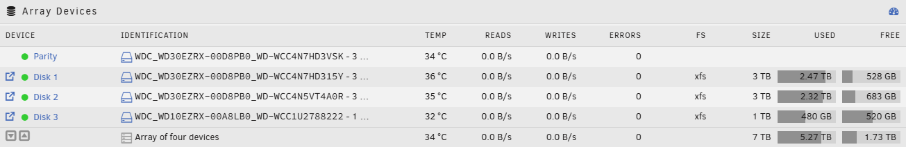

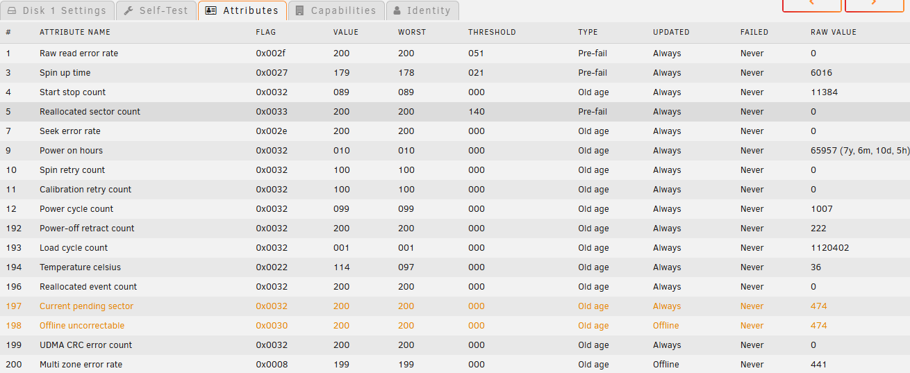

  4. That's a neat idea. Could I copy everything from the array to a 12TB disk and then use this disk as a data disk in a new config with the other 12TB disk as parity?
  5. Hi Basically, all my data disks in the unraid array are failing. They've had a good life (over 65k hours for the younger) but it's time to become e-waste I think. I decided to replace all the disks in the array (Parity and data) with two 12TB disks (one for parity, the other as data). I'm using the Basic licence so 6 disks maximum (I'm using a cache disk as well), so I have 1 extra slot. Downtime on the array is not an issue. What would be the best way to do the switch? I would like to avoid too much stress on the data disks that are about to fail.

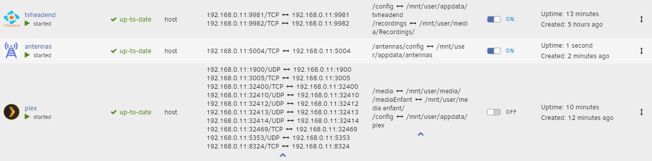

  9. Hi there I'm happily running an unRAID box for quite a while now with an Win10 VM attached to the monitor. The Win10 VM has a 2TB vdisk mounted for user data "local" storage (Documents, Images...). I would like to back the content of this vdisk to a remote site but uploading the 2TB img file every time is way too much, a simple rsync would be plenty enough. Is it possible to mount (read only) the vdisk img file directly on the server (say in /mnt/temp/vdisk) while the VM is running in order to back the content up? I wanted to give it a shot but I don't really want to mess the vdisk image...
  10. I've found the issue I was having. The incoming UDP traffic could not get through to the tvheadend container in Network type bridge (or custon bridge). Switching Network type to Host did the trick but I don't know if there's another way around it.

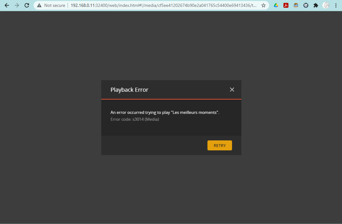

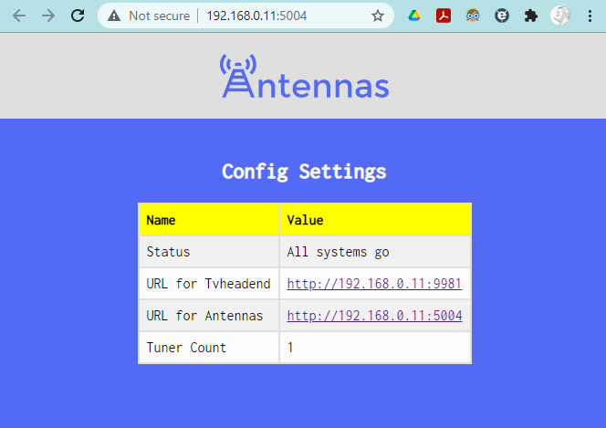

  11. Hi I've configured tvheadend, antennas and Plex and I'm having the following error in Plex when playing the only channel I've configured yet (testing): I've put all three Docker container in host network mode and did not set any password in tvheadend for now: Antennas's config: I can play live TV (IPTV) from the tvheadend interface on my desktop (Win10 VM machine), I've added antennas to Plex LiveTV and Plex has found the channel, downloaded the Guide but cannot play it. Any ideas?
