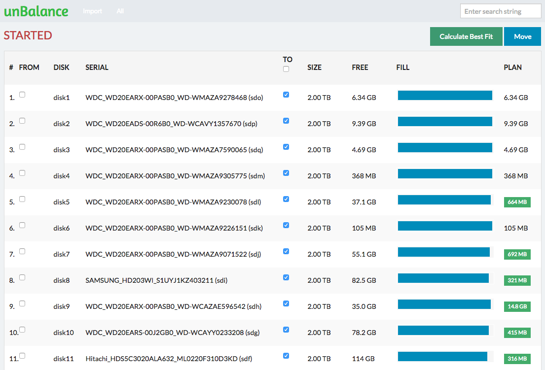

I've been working on a app (written in go), to "unbalance" the disks.
It basically tries to leave one disk, with as much space as possible.
It's still early alpha, and suited to my folder structure, but I'm attaching some pics so that you guys get a taste of what it does.
Please let me know if anyone would be interested in something like this, as a complement to what Freddie built.
Main interface after reading array configuration
After calculating how files will be moved around, it shows how much space will be left available in each disk (it has a hard low limit of 250mb).
It currently does a "dry-run" showing which commands would eventually be executed (mv commands).

@ lboregard
I like it, but would think an rsync move would be safer than the base linux move command.  It has the benefit of verifying the moved file.
GUI's are good.
In an ideal world 'unbalance' would be a front end to a 'diskmv' and 'consld8' back end.
I can see that 'unbalance' aims to allow partial merging but if that feature was dropped then in theory they are feature comparable and it seems a shame to have two separate code bases doing the same job.
Also I agree rsync is a requirement over mv as it is much safer.

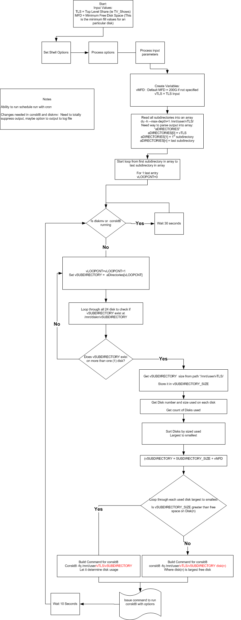

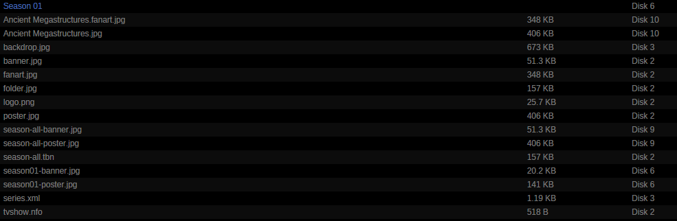

These appear to be great utilities.  I was trying to follow your code, I am not a coder, and was trying to understand how you use "user, as in "consld8 /mnt/user/video/tv/Wonderfalls disk3".  I am assuming you tear it apart and use the actual disk(n) values so that the data is not lost by using the /user paths.
With one more script to look through all of the subdirectories to parse to feed "consld8" this could be a totally automated solution that could be scheduled from cron.  Attached is a hi-level flow chart that I cobbled together for how I would envision such a program would step through.  I had thought about trying to cobble something together, or better yet hoping someone who actually knows how to code would develop.
Any thoughts about the flowchart?
Yes, consld8 calls diskmv and diskmv only moves files from one disk to another. No moves are done to or from the user share.
I was trying to follow your flowchart, but I am not a flowcharter.
I think a lot of the logic involving disk usage and free space is already included in consld8. A relatively simple script could be made to loop through all first level subdirectories and perform consld8 on each of them, letting consld8 determine the destination disk. You could even use 'find' and do it with one line (probably).
An alternative solution might be to add a recursive option to consld8. If a disk is not found with enough free space for the specified directory, consld8 is performed on all of the first level subdirectories.
...this could be a totally automated solution that could be scheduled from cron.
