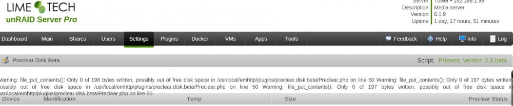

  6. As the PreClear Beta continues on my 3 HHDs. 2- 8tb and 1- 4tb I received the following error message again when I checked the status. The HDDs are currently in Cycle 2, Step 2, Zeroing. Several days of preclearing so I hate to interrupt or cancel at this point Warning: file_put_contents(): Only 0 of 197 bytes written, possibly out of free disk space in /usr/local/emhttp/plugins/preclear.disk.beta/Preclear.php on line 50 Warning: file_put_contents(): Only 0 of 196 bytes written, possibly out of free disk space in /usr/local/emhttp/plugins/preclear.disk.beta/Preclear.php on line 50 Warning: file_put_contents(): Only 0 of 196 bytes written, possibly out of free disk space in /usr/local/emhttp/plugins/preclear.disk.beta/Preclear.php on line 50 Device Identification Temp Size Preclear Status Please wait... retrieving information I have already entered the code you suggested previously including adding it to the go file. mount -o remount,size=256m /var/log Add that to your /boot/config/go file to make it persistent

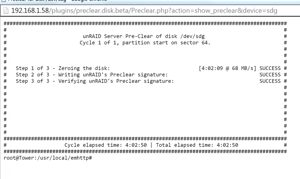

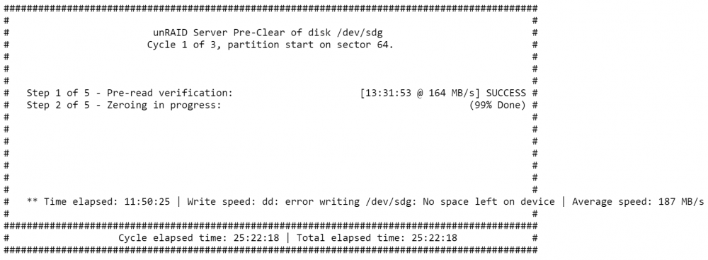

  7. Thank you for the prompt assistance I entered the line of code and it corrected the log error I also added it to the Config/Go file as you suggested. I have several more 8tb drives to clear. Is there a place where one can read all the logging at the finish of the PreClear ? Also you may want to know about this end of file error that gets displayed when the script gets to the end of the disk.

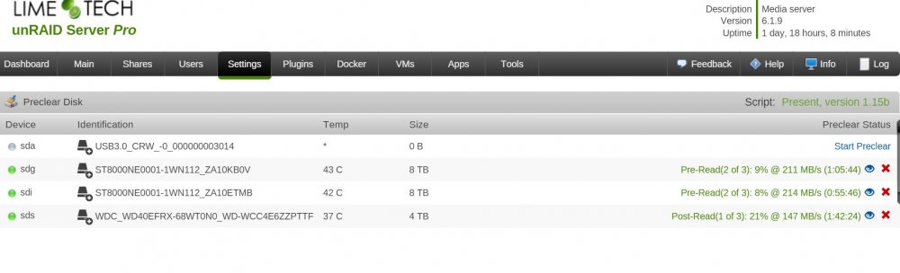

  9. I have been Preclearing 3 HHD withe the PreClear Beta for 2 days now. It is in the PreRead phase of cycle 2 for 2 8tb hard drives and iI think n the PreRead phase for a 4tb drive running. When I attempted to open the plugin to watch the progress I received this error and the plugin refuses to open though the preclear appears to continue to run Any idea what I should do ?
  10. The beta version has a new script written by gfjardim. It is a beta version, so don't expect all the same functionality as the other preclear plugin yet. Thanks for the prompt response. I understand he new script will be lacking until gfjardim has an opportunity to fine tune all the necessary functionality. That doesn't explain my main question which may be a bug. I ran the Beta Preclear plugin and it ran without having the preclear_disk.sh script in the config/plugins/preclear.disk/ directory
  11. I recently added the Preclear Plugin Beta and did not read further on the first page where it said to add the script preclear_disk.sh. The original Preclear Plugin was already installed and the script was in that plugin folder. I ran the Beta Preclear plugin and it ran without having the script in the config/plugins/preclear.disk/ directory. Is there a reason it ran OK ? When the Preclear is finished is there way to recall the html log that shows the finished completion ?
  12. No need to ditch Chrome. Whenever you run Preclear open the GUI with a different browser. You can also try multiple clicks on the button
  13. Two things to try if the GUI is not responding Turn off add blockers as they block the popup screen Us a different browser. Google Chrome is sometimes unresponsive
