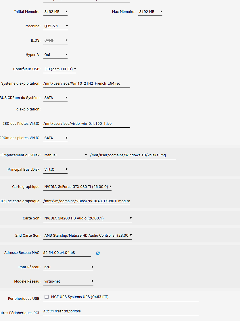

  7. So little update, 980ti is running in game when using the kvm but i still need to put VNC as 1st gpu in the KVM to get it working.
  8. Hello, it's a bit late but i still have problems. Tried all things up there nothing more working. Well not nothing in fact. I managed to have my 980ti appearing in the KVM with VNC in GPU slot1 & 980 in slot2 (in kvm config) I installed drivers and no more warnings. Anyway when i switch back to 980ti only in slot1 (in kvm config), i got nothing. Is someone having any idea at this point before i give up ^^ ? Thanks a lot

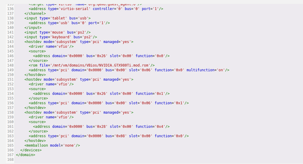

  11. Little update, i tried to change the bus for slot 6 in the KVM but i get this error : "XML error: Invalid PCI address 0000:05:06.0. slot must be <= 0" So tried to put slot 0 bus 5 but nothing better. I'll try today to move GPU in physical slot 2 but i'll miss the pcie 3.0 3.0 x16 to 2.0 x4 is that a problem for gaming passtrough gpu ?
  12. Hello sorry for the late answer and thanks a lot for your feedback ! Yeah i tried a lot of things before asking help cause i prefer knowing or understanding what Im doing before asking help. It is easier for anyone to help after that (at leats thatd what i Think) because the perso Who asks is concerned by the problem and is undersanding what people are talking about to help him. Anyway, i'll test out the things you guides me through and give a feedback here then asap ! Thanks a lot
  13. Hello guys, i am today asking for help for a common problem among beginners : GPU passtrough yay! I tried a lot of things : dump Vbios, driver install with VNC .... and watched a lot of stuffs spaceinvader guides, forum topics etc.... but nothing works actually. Im not seeing my KVM on RDP at all when the 980ti is used in config. Here are some screenshots of my KVM config and the Diagnosis files. 980Ti is in 1st PCIe slot, my Motherboard is a B450 Mortar Max and i'm in Legacy+EFI boot mode and CSM compatibility in the Bios. Unraid is also configured in Legacy. I wish i can get some help cause i should admit that i'm a bit lost right now ^^ Thanks to everybody ! nasjlp-diagnostics-20220525-2216.zip
