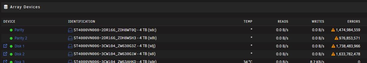

Hello, it has been quite some time that I have a lot of issues with my server. there almost always are new read errors when parity checking. If I change the sata cable it works for one or two week and it comes back. It was mostly on disk 5, even with new cables and a new disk. and here is my last parity check : I attached diagnostics as well. I tried numerous new cables, I added sata expansion cards in case in was the internal MB sata ports that were failing, and I've no clues anymore on what to do except that I don't trust my server anymore. Could it be power supply related ? Thanks in advance for your help. nastorm-diagnostics-20260608-0900.zip
2 disks disabled while parity check because of read errors, cables are new.

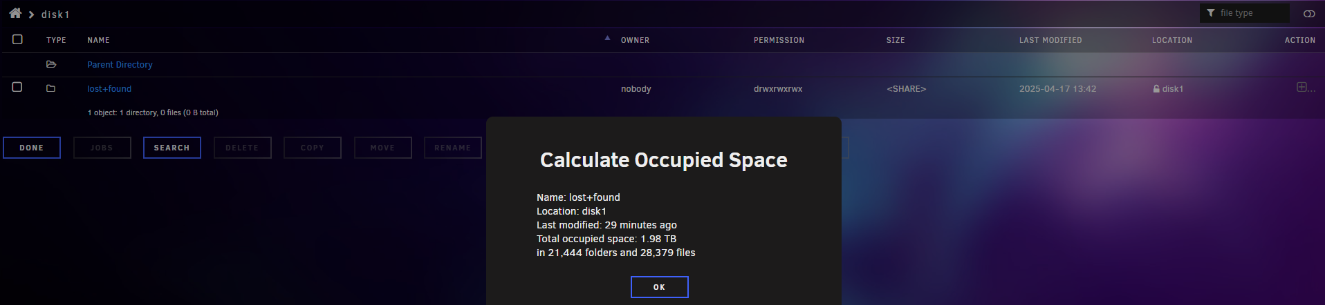

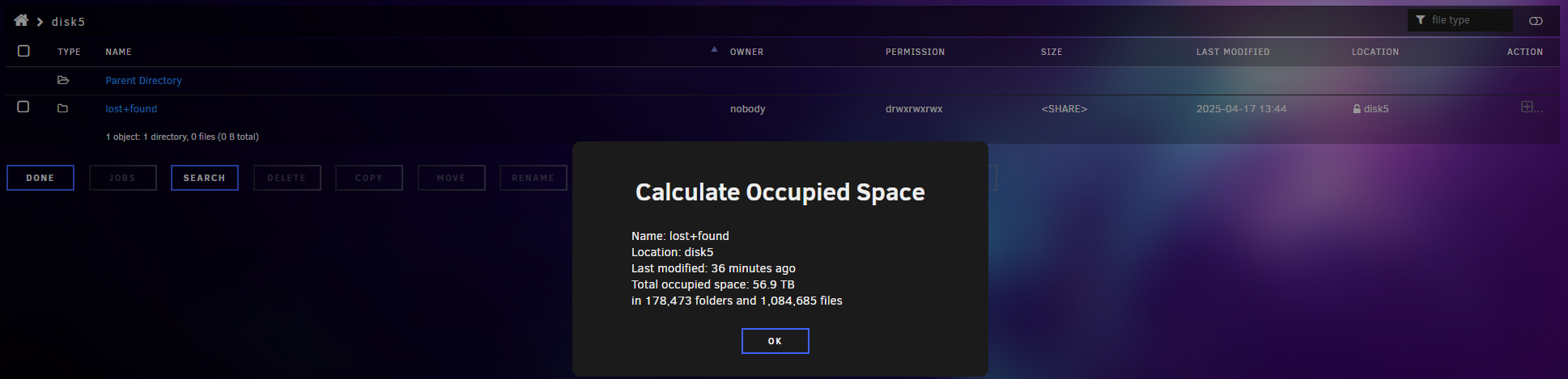

So after checking in detail every disk. 1) My data from the nextcloud share is properly ordered at once, just in a Lost&Found Folder. 2) My backup data on disk 5 is a total mess, split in thousand+ folders. This is backup data from my nextcloud share, so if I can get back my nextcloud share as it was, I can rebuild new backup from it instead of trying to order all backup data on disk 5 (which are split between disk 5 & 6, only data on 5 is a mess). 2) is not a problem if I can recover from 1). now big question I didn't find the answer looking on the net : How can I move the data from Disk 2 to Disk 2 (renaming the nextcloud share folder and moving it in the root folder), and be sure that all timestamps will be preserved ? It seems mv can't guarantee that. cp can but I don't have enough space on the disk to do a copy preserving timestamp then deleting original. Any ideas ?- Help with lost&found that span the entire data of multiple disks.

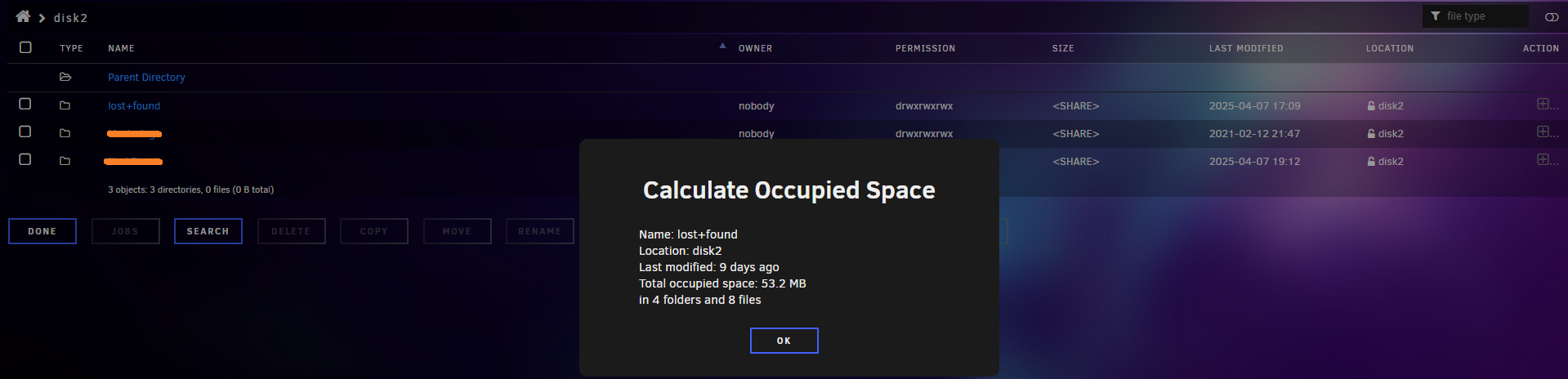

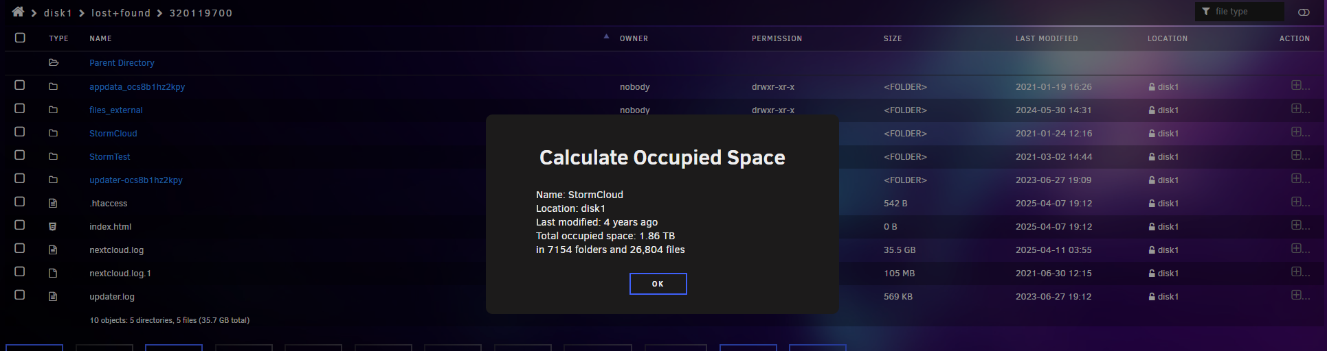

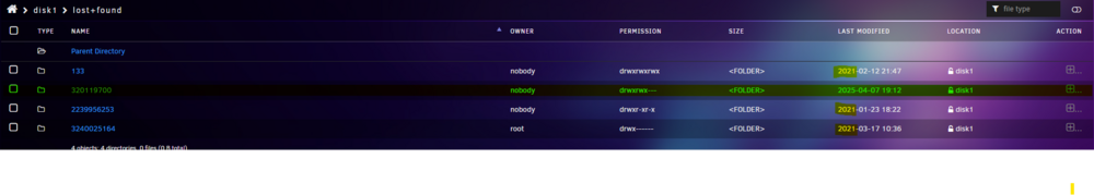

With further analysis : Disk 1 has 4 folders in lost & found : - 3 of them contain a few files - the last one seem to contain all the data of the Nextcloud share, properly ordered. And the size / number of file seems coherent. Could it be possible that the file system error concerned just the root folders of the disk, and everything else was preserved ? If I move that folder from lost&found to the Nextcloud share, should it work ? Edit : is it safe to say that the three other folders are very old lost & founds since their modified date is 2021 ? In green the folder with the nextcloud share. Sorry for the gazillion questions, I'm slightly panicking.- Help with lost&found that span the entire data of multiple disks.

Hello, Due do bad sata cables and an unclean shutdown, I had 3 disk marked "unmountable". I did repair the file system on each three, it was talking about bag log but they never got mountable. After zero log the disks : - Disk 1 has all its data in lost&found, in random named folder - Disk 2 has just a few files, nothing alarming here - Disk 5 has all its data in lost&found, in random named folder Disk 1 & 2 support my Nextcloud share, sporting 4 TB of data. Disk 5 & 6 are versioned backups of the nextcloud share, done with Rsync. I just rebuilt disk 5 on a brand new disk but I have the older one (although giving a lot of read errors). In the Lost & Found folders, files seems okay with proper names, but put randomly. Any ideas ?- rsync Incremental Backup
