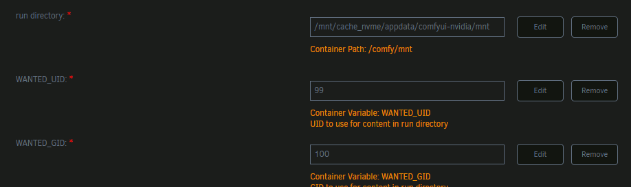

  9. Unraid docker instance. I use my pc to file manage. I reload the ui with every change purely out of habit.
