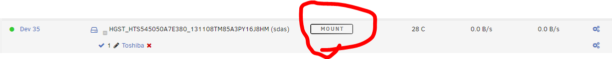

  10. So I re-formatted it on my laptop with NTFS. Then it appeared as mountable, but got this: Mounting volume... $MFTMirr does not match $MFT (record 24). Then I ran ntfsfix couple of times and VOALA! It mounted! Thanks for your support and great plugin!!
  11. ToTo changed their profile photo
  12. Log: Oct 19 00:04:47 Tower kernel: sd 45:0:18:0: [sdas] 976773168 512-byte logical blocks: (500 GB/466 GiB) Oct 19 00:04:47 Tower kernel: sd 45:0:18:0: [sdas] 4096-byte physical blocks Oct 19 00:04:47 Tower kernel: sd 45:0:18:0: [sdas] Write Protect is off Oct 19 00:04:47 Tower kernel: sd 45:0:18:0: [sdas] Mode Sense: 7f 00 10 08 Oct 19 00:04:47 Tower kernel: sd 45:0:18:0: [sdas] Write cache: enabled, read cache: enabled, supports DPO and FUA Oct 19 00:04:47 Tower kernel: sdas: sdas1 Oct 19 00:04:47 Tower kernel: sd 45:0:18:0: [sdas] Attached SCSI disk Oct 19 00:04:47 Tower emhttpd: HGST_HTS545050A7E380_131108TM85A3PY16J8HM (sdas) 512 976773168 Oct 19 00:04:47 Tower emhttpd: read SMART /dev/sdas Oct 19 00:05:26 Tower unassigned.devices: Removing partition '1' from disk '/dev/sdas'. Oct 19 00:05:32 Tower kernel: sdas: Oct 19 00:05:45 Tower unassigned.devices: Device '/dev/sdas' block size: 976773168. Oct 19 00:05:45 Tower unassigned.devices: Clearing partition table of disk '/dev/sdas'. Oct 19 00:05:46 Tower unassigned.devices: Reloading disk '/dev/sdas' partition table. Oct 19 00:05:46 Tower unassigned.devices: Reload partition table result: /dev/sdas: re-reading partition table Oct 19 00:05:46 Tower unassigned.devices: Creating a 'gpt' partition table on disk '/dev/sdas'. Oct 19 00:05:46 Tower unassigned.devices: Formatting disk '/dev/sdas' with 'ntfs' filesystem. Oct 19 00:05:47 Tower unassigned.devices: Format disk '/dev/sdas' with 'ntfs' filesystem: Cluster size has been automatically set to 4096 bytes. Creating NTFS volume structures. mkntfs completed successfully. Have a nice day. Oct 19 00:05:50 Tower unassigned.devices: Reloading disk '/dev/sdas' partition table. Oct 19 00:05:51 Tower kernel: sdas: sdas1 Oct 19 00:05:51 Tower unassigned.devices: Reload partition table result: /dev/sdas: re-reading partition table Oct 19 00:40:35 Tower unassigned.devices: Removing partition '1' from disk '/dev/sdas'. Oct 19 00:40:41 Tower kernel: sdas: Oct 19 00:40:49 Tower unassigned.devices: Device '/dev/sdas' block size: 976773168. Oct 19 00:40:49 Tower unassigned.devices: Clearing partition table of disk '/dev/sdas'. Oct 19 00:40:49 Tower unassigned.devices: Reloading disk '/dev/sdas' partition table. Oct 19 00:40:49 Tower unassigned.devices: Reload partition table result: /dev/sdas: re-reading partition table Oct 19 00:40:49 Tower unassigned.devices: Creating Unraid compatible mbr partition on disk '/dev/sdas'. Oct 19 00:40:50 Tower unassigned.devices: Reloading disk '/dev/sdas' partition table. Oct 19 00:40:50 Tower kernel: sdas: sdas1 Oct 19 00:40:50 Tower unassigned.devices: Reload partition table result: /dev/sdas: re-reading partition table Oct 19 00:40:50 Tower unassigned.devices: Formatting disk '/dev/sdas' with 'xfs' filesystem. Oct 19 00:40:53 Tower unassigned.devices: Format disk '/dev/sdas' with 'xfs' filesystem: meta-data=/dev/sdas1 isize=512 agcount=4, agsize=30524160 blks = sectsz=4096 attr=2, projid32bit=1 = crc=1 finobt=1, sparse=1, rmapbt=0 = reflink=1 data = bsize=4096 blocks=122096638, imaxpct=25 = sunit=0 swidth=0 blks naming =version 2 bsize=4096 ascii-ci=0, ftype=1 log =internal log bsize=4096 blocks=59617, version=2 = sectsz=4096 sunit=1 blks, lazy-count=1 realtime =none extsz=4096 blocks=0, rtextents=0 Oct 19 00:40:56 Tower unassigned.devices: Reloading disk '/dev/sdas' partition table. Oct 19 00:40:56 Tower kernel: sdas: sdas1 Oct 19 00:40:56 Tower unassigned.devices: Reload partition table result: /dev/sdas: re-reading partition table Oct 19 15:09:25 Tower unassigned.devices: Removing partition '1' from disk '/dev/sdas'. Oct 19 15:09:30 Tower kernel: sdas: Oct 19 15:09:45 Tower unassigned.devices: Device '/dev/sdas' block size: 976773168. Oct 19 15:09:45 Tower unassigned.devices: Clearing partition table of disk '/dev/sdas'. Oct 19 15:09:45 Tower unassigned.devices: Reloading disk '/dev/sdas' partition table. Oct 19 15:09:45 Tower unassigned.devices: Reload partition table result: /dev/sdas: re-reading partition table Oct 19 15:09:45 Tower unassigned.devices: Creating a 'gpt' partition table on disk '/dev/sdas'. Oct 19 15:09:46 Tower unassigned.devices: Formatting disk '/dev/sdas' with 'ntfs' filesystem. Oct 19 15:09:47 Tower unassigned.devices: Format disk '/dev/sdas' with 'ntfs' filesystem: Cluster size has been automatically set to 4096 bytes. Creating NTFS volume structures. mkntfs completed successfully. Have a nice day. Oct 19 15:09:50 Tower unassigned.devices: Reloading disk '/dev/sdas' partition table. Oct 19 15:09:51 Tower kernel: sdas: sdas1 Oct 19 15:09:51 Tower unassigned.devices: Reload partition table result: /dev/sdas: re-reading partition table Oct 19 15:14:58 Tower unassigned.devices: Removing partition '1' from disk '/dev/sdas'. Oct 19 15:14:59 Tower kernel: sdas: Oct 19 15:15:04 Tower kernel: sdas: Oct 19 15:15:19 Tower unassigned.devices: Device '/dev/sdas' block size: 976773168. Oct 19 15:15:19 Tower unassigned.devices: Clearing partition table of disk '/dev/sdas'. Oct 19 15:15:19 Tower unassigned.devices: Reloading disk '/dev/sdas' partition table. Oct 19 15:15:19 Tower unassigned.devices: Reload partition table result: /dev/sdas: re-reading partition table Oct 19 15:15:19 Tower unassigned.devices: Creating Unraid compatible mbr partition on disk '/dev/sdas'. Oct 19 15:15:20 Tower unassigned.devices: Reloading disk '/dev/sdas' partition table. Oct 19 15:15:20 Tower kernel: sdas: sdas1 Oct 19 15:15:20 Tower unassigned.devices: Reload partition table result: /dev/sdas: re-reading partition table Oct 19 15:15:20 Tower unassigned.devices: Formatting disk '/dev/sdas' with 'xfs' filesystem. Oct 19 15:15:23 Tower unassigned.devices: Format disk '/dev/sdas' with 'xfs' filesystem: meta-data=/dev/sdas1 isize=512 agcount=4, agsize=30524160 blks = sectsz=4096 attr=2, projid32bit=1 = crc=1 finobt=1, sparse=1, rmapbt=0 = reflink=1 data = bsize=4096 blocks=122096638, imaxpct=25 = sunit=0 swidth=0 blks naming =version 2 bsize=4096 ascii-ci=0, ftype=1 log =internal log bsize=4096 blocks=59617, version=2 = sectsz=4096 sunit=1 blks, lazy-count=1 realtime =none extsz=4096 blocks=0, rtextents=0 Oct 19 15:15:26 Tower unassigned.devices: Reloading disk '/dev/sdas' partition table. Oct 19 15:15:26 Tower kernel: sdas: sdas1 Oct 19 15:15:26 Tower unassigned.devices: Reload partition table result: /dev/sdas: re-reading partition table
  13. I deleted Temp share, re-formatted the drive, but Mount button is still grayed... In which condition this button is disabled?
  14. Alright, the drive in question is HGST_HTS545050A7E380_131108TM85A3PY16J8HM (sdas) Thanks in advance! tower-diagnostics-20211019-1029.zip
