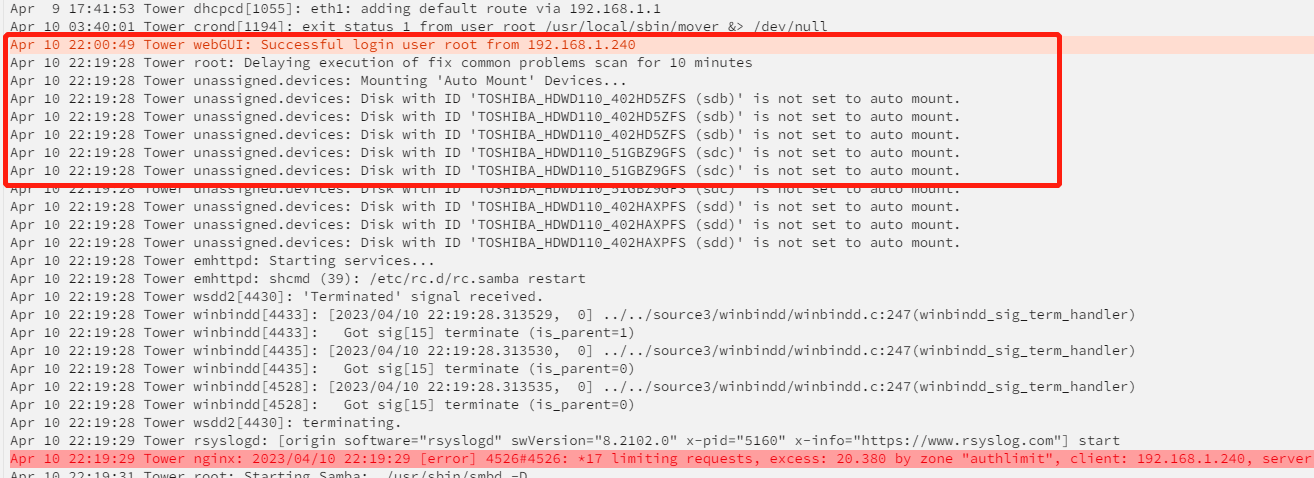

  1. 我的unraid服务器最近会突然的重启,频率大概是几天一次,偶尔隔一天也会重启一次,日志里面看不出什么情况,怎么去跟踪并解决这个问题呢!

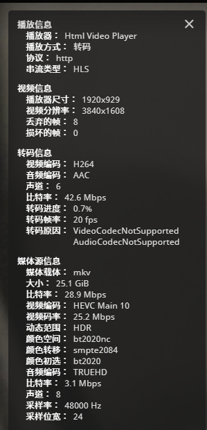

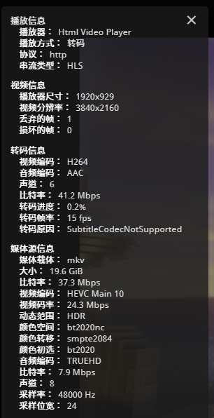

  3. Sorry,I only have 2 Blue Ray videos(hevc main 10).When I enable the hardware decoding, and diable the hardware encoding,both of the two videos work fine!For the first one,when I enable the hardware encoding,it can play without erros but the screen is blurred;the second one can not play and the logging said "H.264 bitstream malformed, no startcode found, use the video bitstream filter 'h264_mp4toannexb' to fix it ('-bsf:v h264_mp4toannexb' option with ffmpeg)"! By the way,I have a rx550 graphics card,Does this card use the driver 'amdgpu' rather than 'radeon'?
  4. hi: I'm using the iGPU in R5 5600G,it works when I diabled the hardware encoding.otherwise,it occurs a error when I open the hevc video。as flows [h264_vaapi @ 0x5629effd9100] Driver does not support some wanted packed headers (wanted 0xd, found 0x1). Output #0, hls, to '/config/transcodes/ed6ac1d6d22a29fdda3f787857ac2933.m3u8': Metadata: encoder : Lavf58.45.100 Stream #0:0: Video: h264 (h264_vaapi) (High), vaapi_vld, 3840x2160 [SAR 1:1 DAR 16:9], q=-1--1, 40576 kb/s, 23.98 fps, 90k tbn, 23.98 tbc (default) Metadata: encoder : Lavc58.91.100 h264_vaapi Stream #0:1: Audio: aac (LC), 48000 Hz, 5.1, fltp (24 bit), 640 kb/s (default) Metadata: encoder : Lavc58.91.100 aac [mpegts @ 0x5629f0969f80] H.264 bitstream malformed, no startcode found, use the video bitstream filter 'h264_mp4toannexb' to fix it ('-bsf:v h264_mp4toannexb' option with ffmpeg) av_interleaved_write_frame(): Invalid data found when processing input [hls @ 0x5629effaf880] Opening '/config/transcodes/ed6ac1d6d22a29fdda3f787857ac29330.ts' for writing frame= 1 fps=0.0 q=-0.0 Lsize=N/A time=00:00:00.66 bitrate=N/A speed=1.99x video:24kB audio:2kB subtitle:0kB other streams:0kB global headers:0kB muxing overhead: unknown [aac @ 0x5629effaed80] Qavg: 65536.000 Conversion failed! How can I resolve this error?Very thanks for your help!
