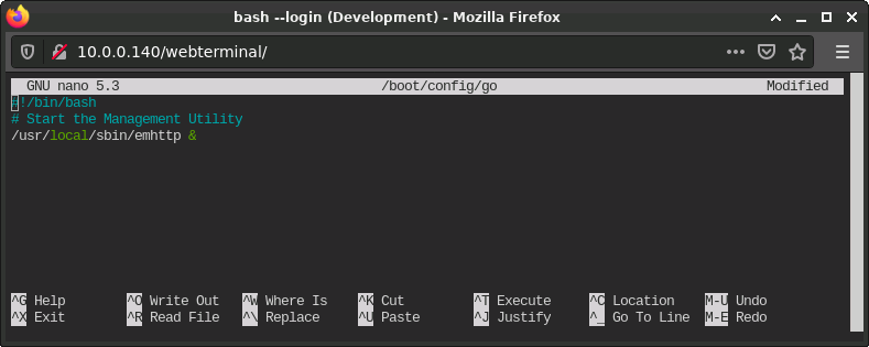

nano /boot/config/go
and press enter.
You should see something like this:

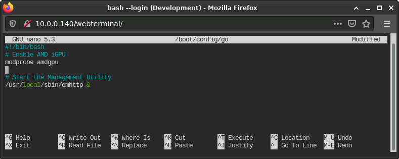

Now add after the first line these lines (navigate with the arrow keys on your keyboard):
# Enable AMD iGPU
modprobe amdgpu
This is a example what the 'go' file should like after you inserted the text above:
After that press:
  1. CTRL + X
  2. Y
  3. RETURN
to save the file and close the window.
Done! After the next reboot of Unraid the module for your AMD iGPU/GPU is automatically loaded and activated.
