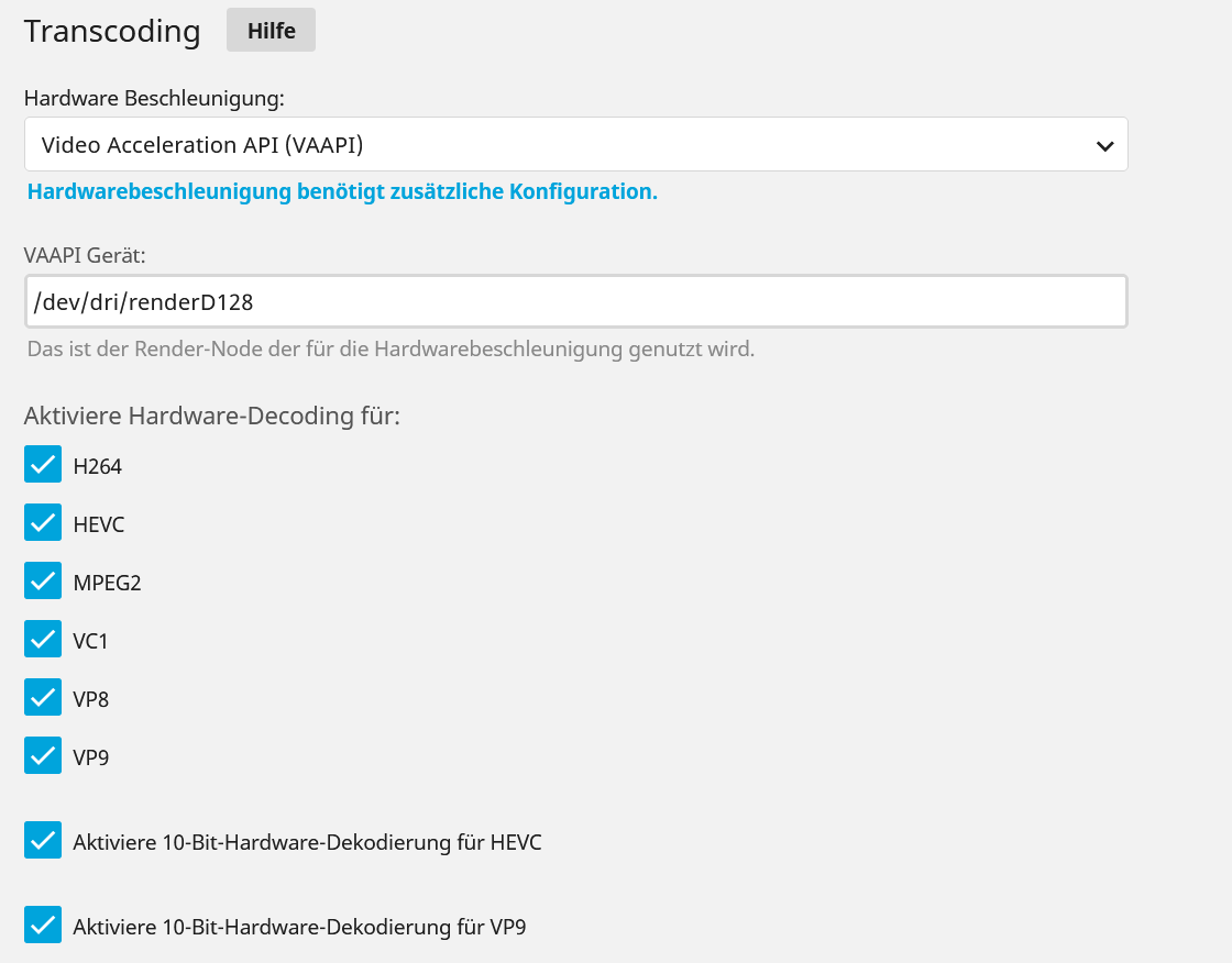

I have installed JellyFin for AMD-Intel-Nvidia and followed the same exact steps in the docker documentation and Intel quick sync will not work it will crash the video and I have to set hardware transcoding to none for it to work, I have an old i7 4770 that I owned over the years
What have you done exactly?
Have you passed through the device /dev/dri and what have you done in the settings from Jellyfin?
Can you provide a few screenshots?

Please keep in mind that you CPU (Haswell) maybe doesn't support all the codecs you've selected, please look here for further information: Click
Your CPU doesn't support HEVC, VC8, VC9,...
It only supports MPEG, h264 and VC1 <- decode only.
Also I would really strongly recommend to us the VA-API instead of QuickSync, they are basically the same where VA-API is an open standard where QuickSync is proprietary.

I also see that you've changed the render device path, so it actually can't work...

I have made Progress Finally I have changed the VA-APO device from /dev/dri to /dev/dri/renderd128 and it WORKED!!!
yup that was it Thank you!!! I have changed the VA-API Device to '/dev/dri/renderD128' resolved my issue, Thanks again for all your help before it was set to '/dev/dri/' as default or I changed it by accident I cant recall to be 100% but the device render path was the root cause of my issues.

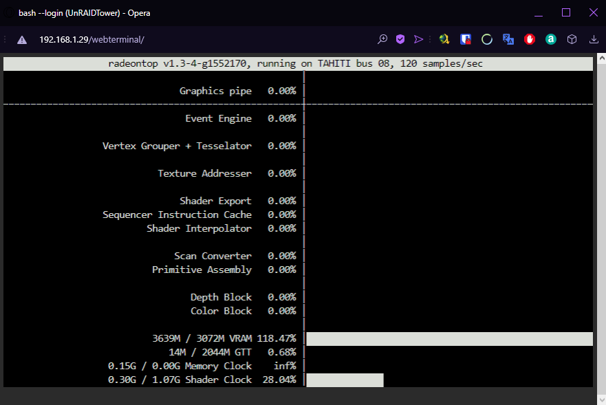

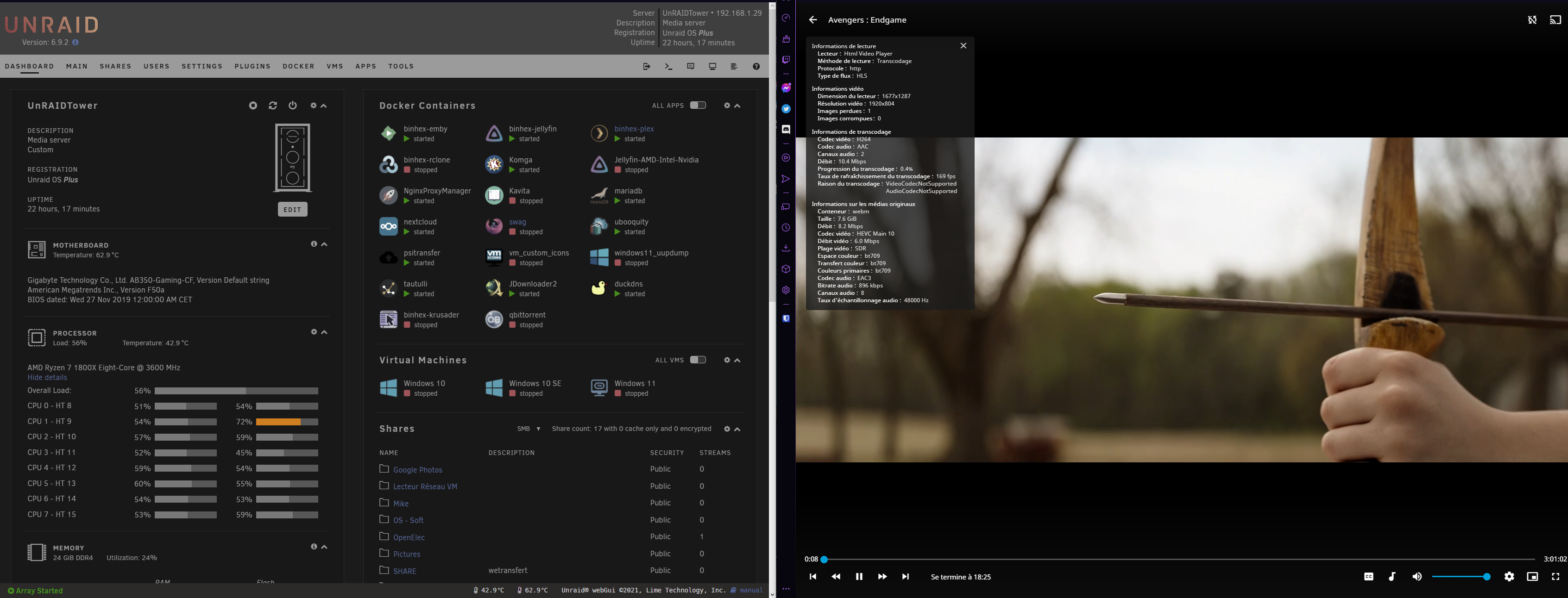

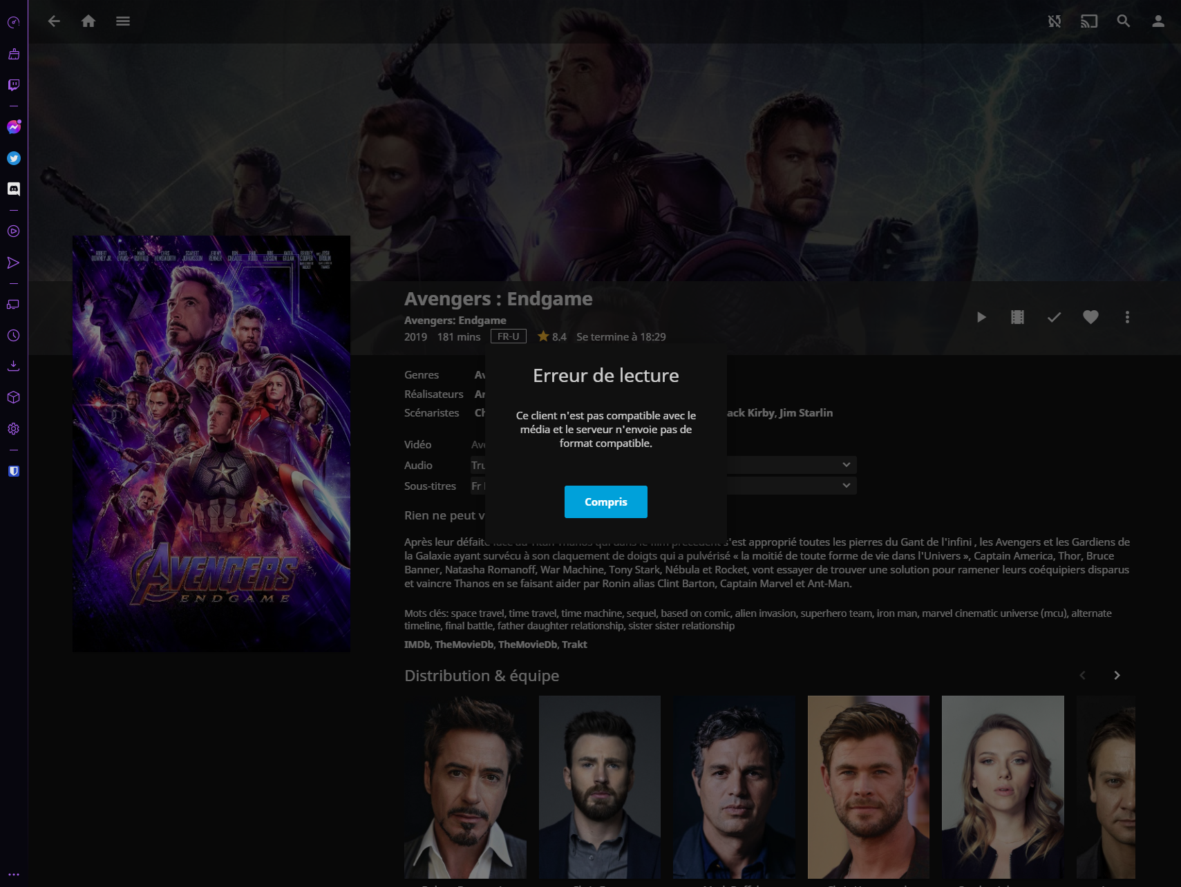

Hello, first of all thank you for your availability.
I'm not very good at it but your responses to other posts have helped me a lot. However I am having a problem playing 4k movies, I have an error message. I think this and due to the HEVC codec.
My processor is a Ryzen 1800x and my GPU is an R9 280x (oc). If I understood your answer to a post similar to mine correctly, my problem could possibly come from the CPU which does not decode the HECV?
But it's OK in Intel Quick Sync, but NOK in VAAPI (Cf screenshot)
I also have another problem, I am unable to modify the go file with mod variable probe radeon. I tried to change it by hand, but on every reboot I have to redo the command in the Unraid console.
I also noticed that the Radeon top statistics don't seem to move either, they have buoyed once, since they are on "3639M / 3072M VRAM 118.47%" (see screenshot) I think he has something that I did wrong, but I don't see what: / Can you help me please ? :)
Exactly the R9 280x is not able to encode h265 (HEVC) it is only capable of h264 and it will fall back to CPU encoding if no capable hardware encoder is available.
Please stick to VAAPI since this will work best in my Jellyfin container.
If you have Radeon TOP installed it should handle all for you and you don't need to modify anything.

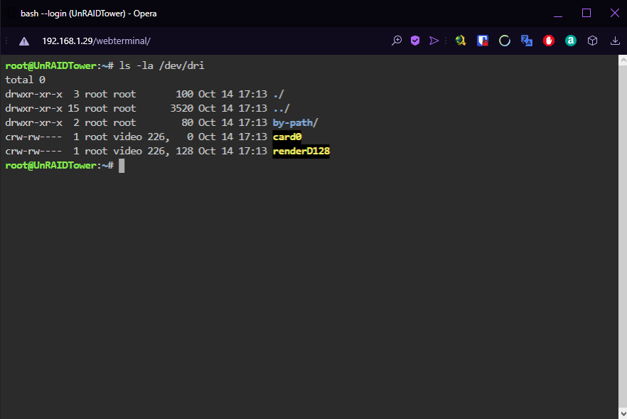

Please issue the command:
ls -la /dev/dri
after a reboot from unRAID and post the output here.

Here is the requested command:
14 minutes ago, tmike22 said:
Thank you for your very quick response.
Then everything is working as expected and the driver is loaded for your card, otherwise it would show that the directory does not exists.
