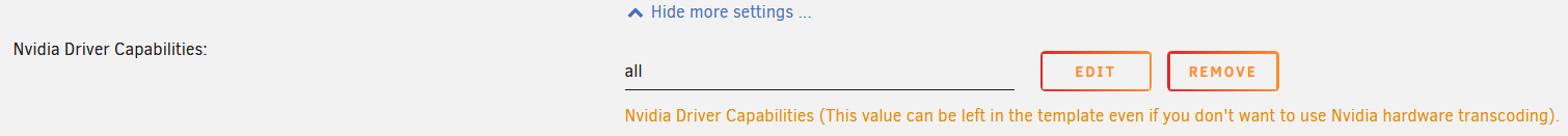

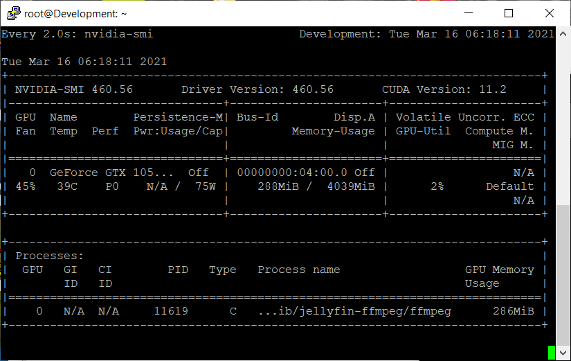

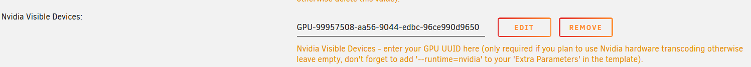

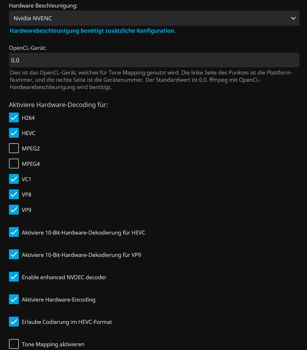

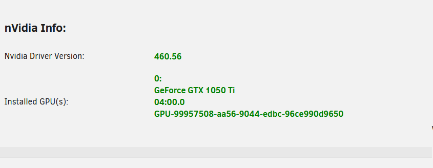

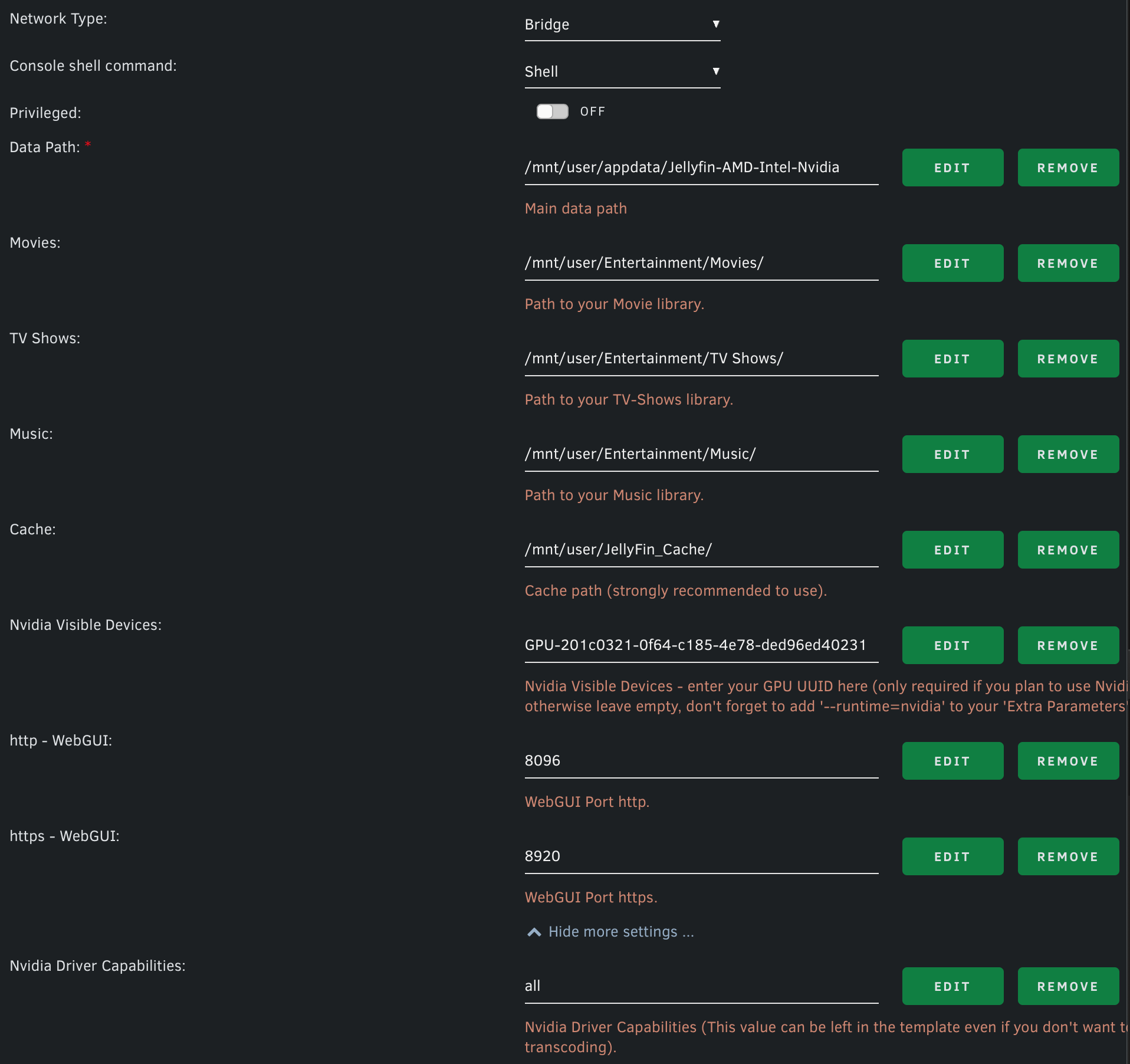

@Waddoo tried it now on my own on my DevServer with an GTX1050Ti and it should work:
Here are a few screenshots from my template (please check also if you got no leading space at Nvidia Visible Devices) :
This is the output from 'nvidia-smi' when I transcode from 4K to 480p:
This is the output form 1080p to 480p:
Here are my settings from Jellyfin:
Have you eventually activated the last checkbox 'Tone Mapping active'?
Can you send a few screenshots from your settings?

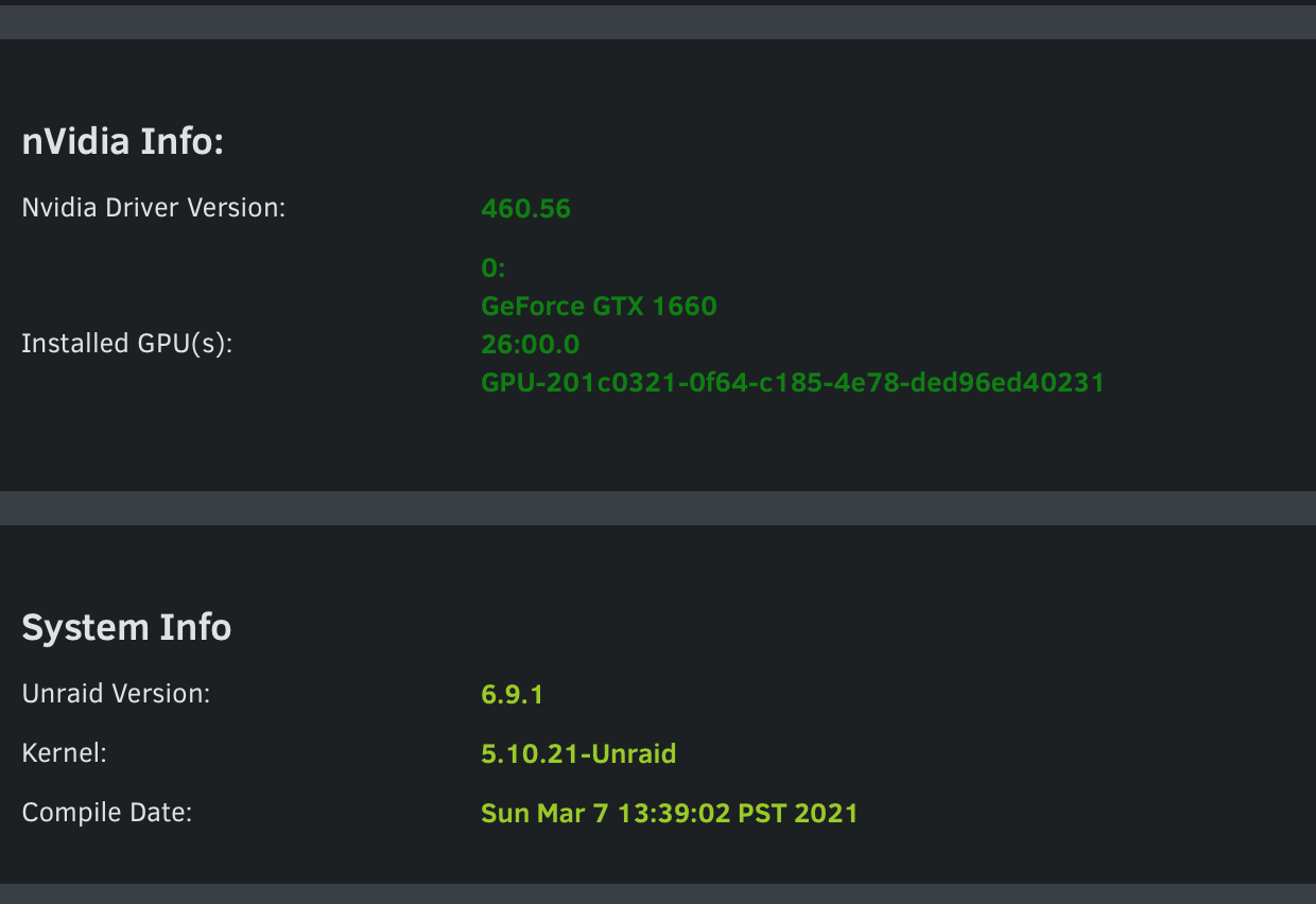

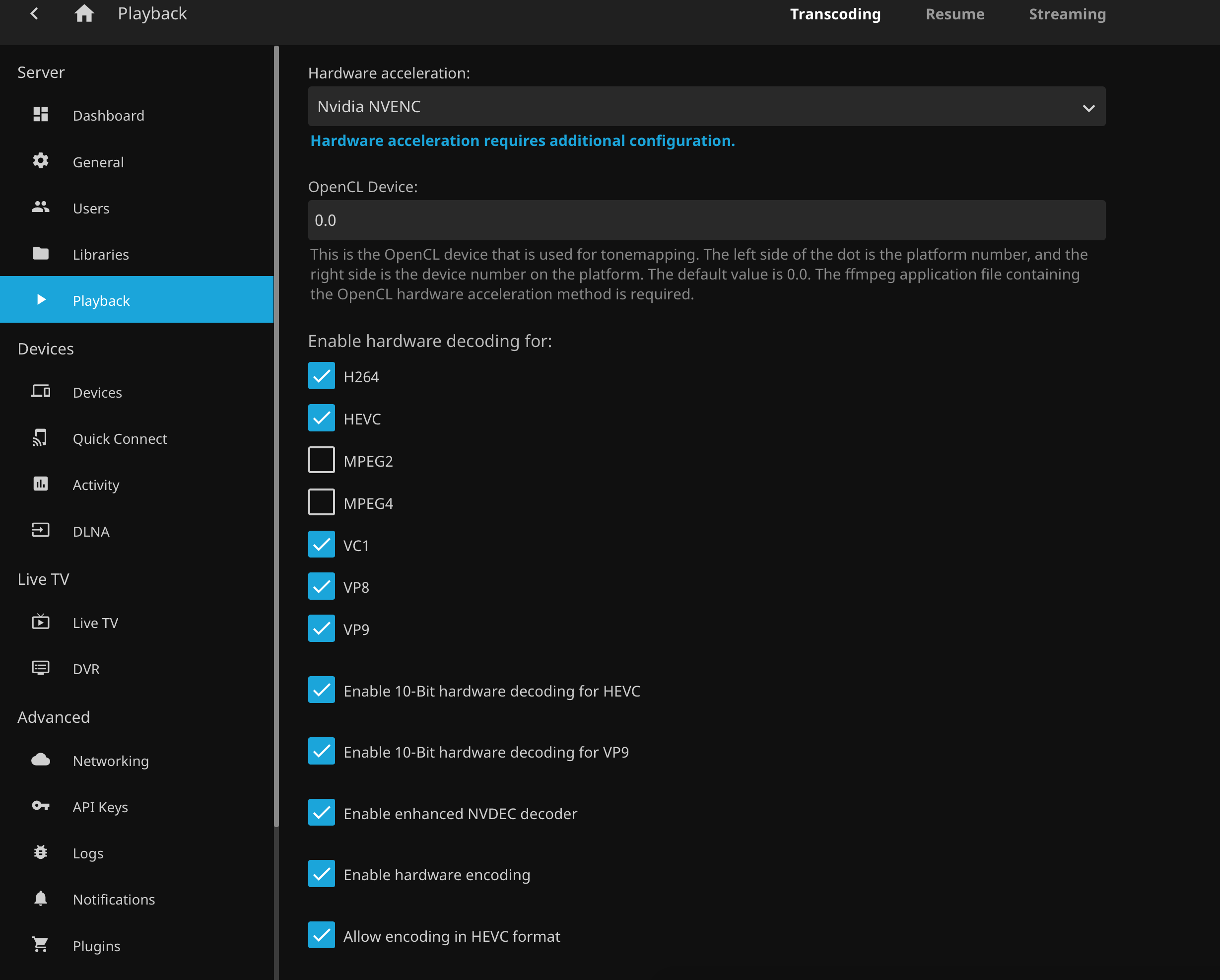

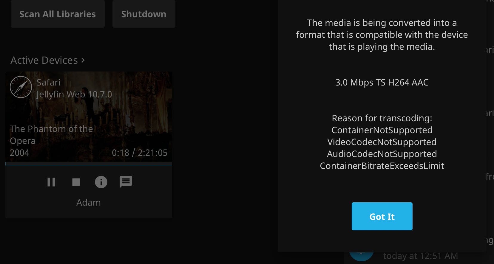

@ich777 I have setup the docker with the images below, let me know what you think is my next best step forward. I did remove the /dev/dri since it read to remove it but apart from that I think my settings are matching yours.
I tried it with that checked and without, same result of the JellyFin session recognizing it needs transcode but video is frozen.
I have included as many screenshots as I can showing what I see. I have also included a log file of a 1080p video that has the same fate as the 4K HEVC SDR. Sitting frozen with the timeline moving both on my player and dashboard, but no video/audio and no transcode process running.
Log.txt
Have you also added '--runtime=nvidia' at Extra Parameters (to see that you have to enable the 'Advanced View' with the switch in the top right corner of the template page).
If only it were easy as a missing parameter. Yes, I did remember to add —runtime=nvidia. Separated by a space next to the restart statement like in your image. I could give the entire server a reboot but not sure why the docker is t getting the gpu passed.

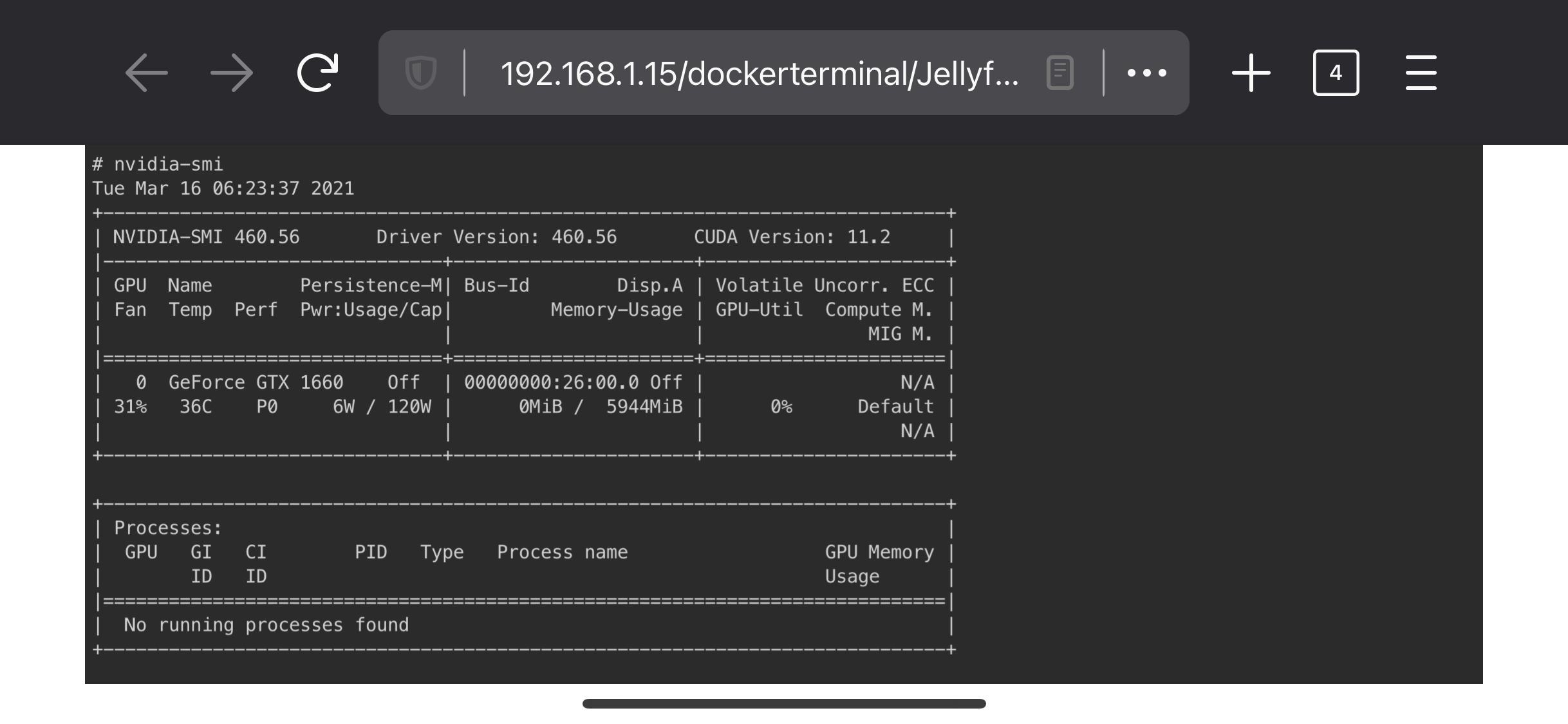

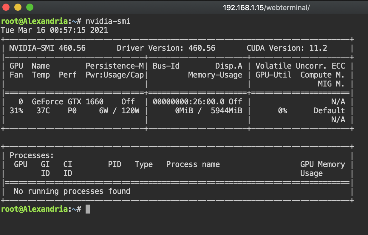

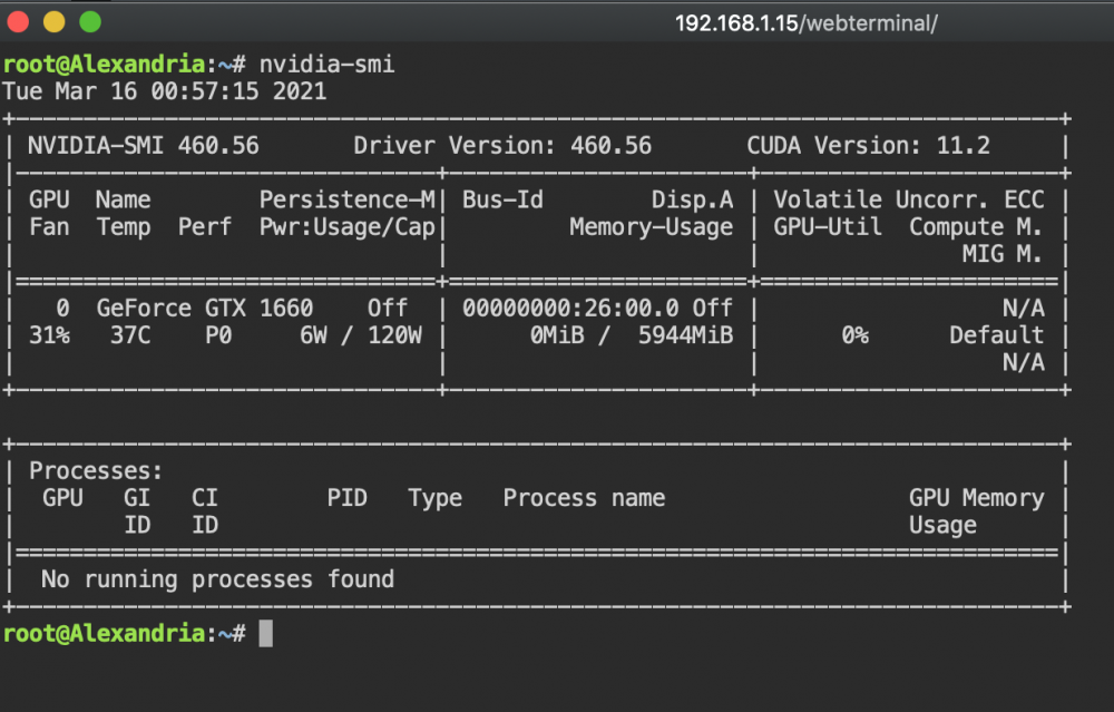

Can you try to open up a console window from the container itself (Click on the icon of Jellyfin and then click on Console) and then type in 'nvidia-smi'.
if I typed the nvidia gpu ID incorrectly, wouldn’t the docker not boot?
The container should still be able to start up.
See my docker command from my previous post, shows all the parameters on startup.
I have added a photo of the Jellyfin console and nvidia-Smi result.
