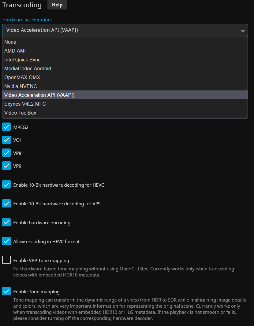

Noticed there's an AMD AMF option for transcoding - is that usable on certain hardware?
