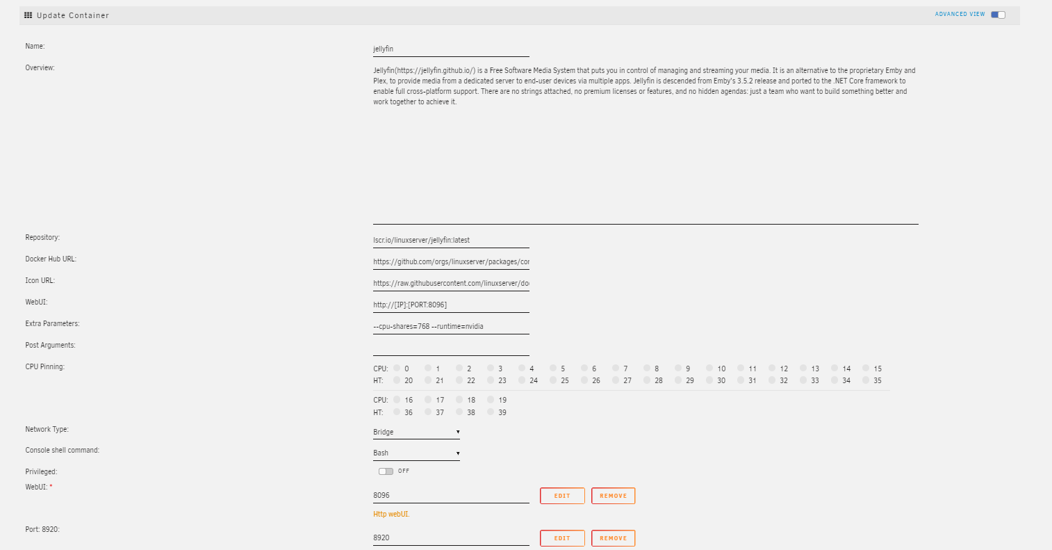

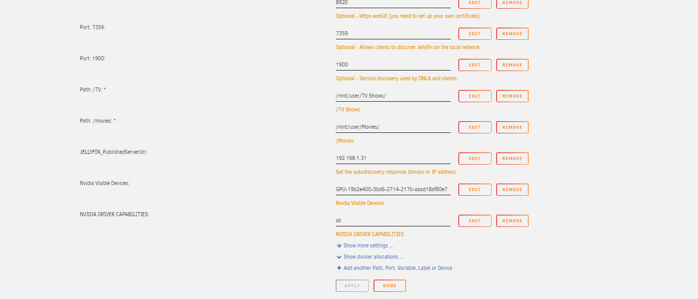

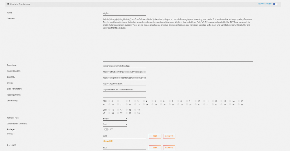

My transcoding is no longer working. I had a cache drive error a few days ago, and since fixing it, when i play a video with transcode on, it is distorted. If i play a video in Plex with transcode on, it works as expected. When i play a video in Jellyfin, with transcode on, Nvidia is not recognizing it. I dont see it in gpu statistics, and i dont see it running in the terminal either. I have done a fresh install of Jellyfin, with the same results. I have done a fresh install of my nvidia driver with the latest version, and same results. Rebooted my server several times. I am on unraid 6.9.2 and my driver version is 510.47.03 Any help would be greatly appreciated.

I ran this and it says No running processes found. For some reason, Jellyfin isnt triggering the video card when transcoding. - [Support] ich777 - Jellyfin AMD/Intel/Nvidia [DEPRECATED]
