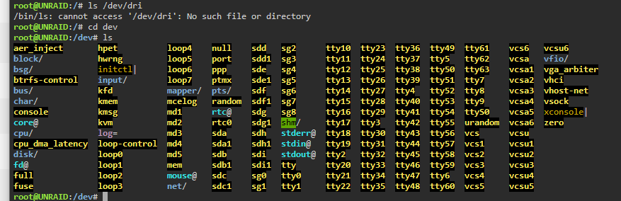

  5. Hello, Well I just understood why I no longer had the dri directory the graphics card is used by a VM I stopped the VM and found the directory Sorry for the inconvenience Have a good day

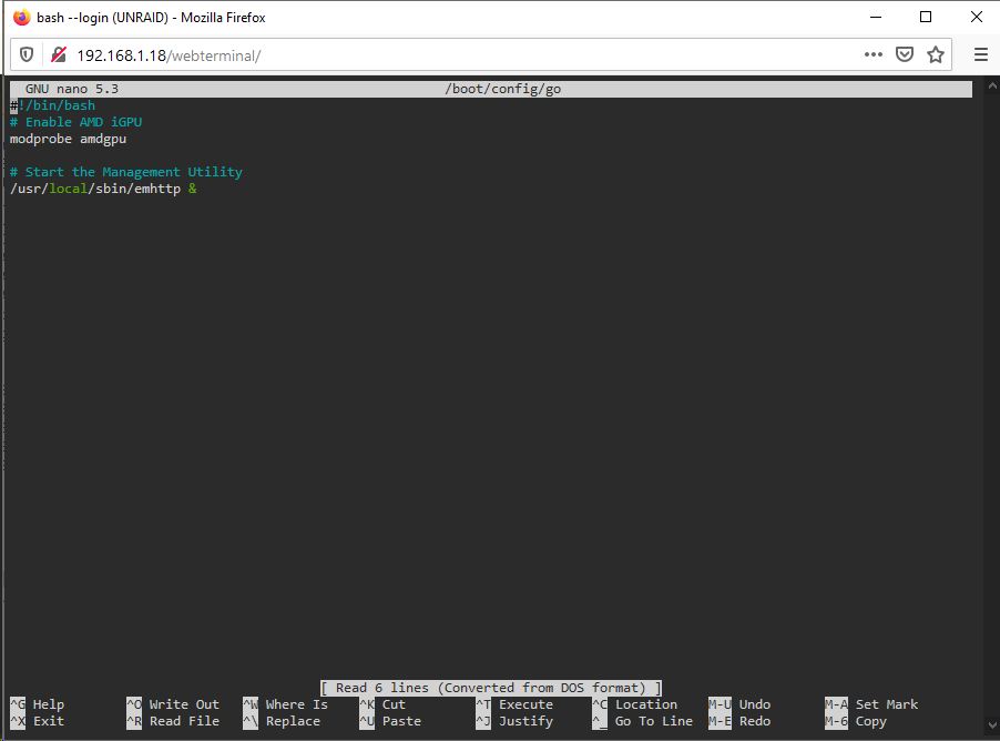

  6. Hello I certainly made a mistake I no longer have the dri directory Despite having modified the go file and using the modprobe command radeon the directory What settings do I have to make to find this dri directory? I have no problem with the Radeon TOP plugin Thank you very much in advance for your help Have a good day

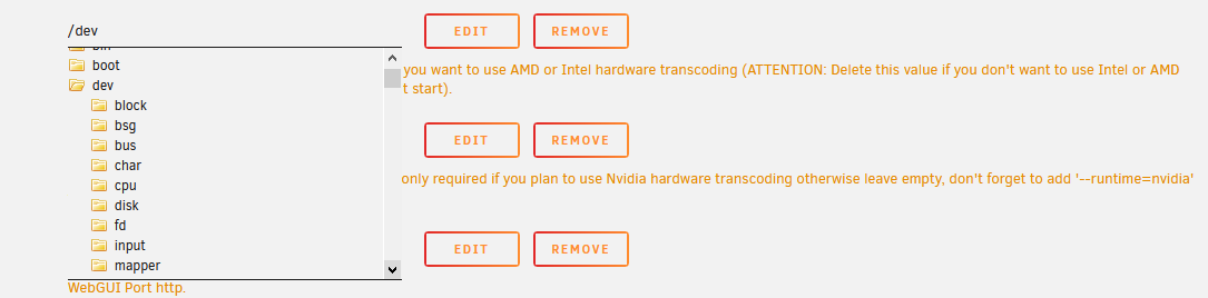

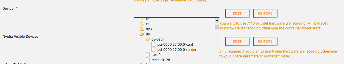

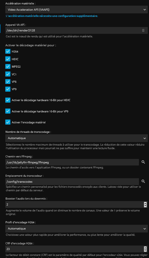

  10. thank you very much After using the 'modprobe radeon' command I finally have access to the application (I'm happy) On the other hand, in the event of a restart of the server, it is necessary to restart pr 'modprobe radeon’ How can I get the command to be taken directly when starting the server? And I send you the points entered in Jellyfin did not hesitate to tell me if I made a mistake (picture below) And last question how to verify that the garphic card is solicited?

  12. Hello Can you do "ls /dev/dri" and post the output here? Directory / dri not created should we do it manually ? or normally this is done when setting up the installation of Jellyfin AMD / Intel / Nvidia ? See the screenshot below This looks all good and the driver is loaded, are you on Unraid 6.9.0? Yes I am using 6.9.0 (updated to the latest version today) Are you sure that you set the iGPU to be the first boot device or better speaking have you installed also a dedicated GPU in your system? Yes I have a dedicated graphics card, a Sapphire Radeon HD 4850, however I do not have enough knowledge of unraid (on the other hand I have so far not had the need to declare it to Unraid, is this important?) Thank you for taking the time to help me

  14. Hello, And thanks for your help Yes I restarted after making the change to the go file and I just do the modprobe amdgpu command manually in addition I look for you indicated the lsmod
