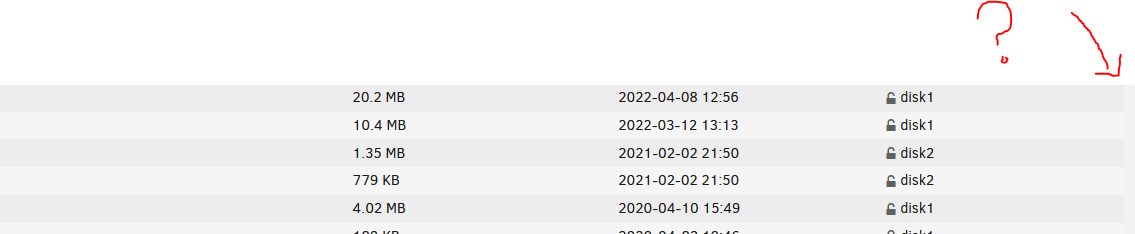

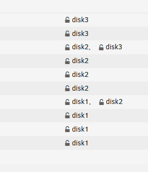

  5. Oh dammit. You're right! rm -d cleared it up. Stupid me was focused on trying to find things just on the share level and not the disk itself. Troubleshooting fail on my part.... While I have you... Any idea where to start looking on this? The in-share file manipulation options have disappeared.
  6. Thanks. Read that over. Doesn't seem to help in this particular situation as I can't locate the problem file. Through the shares tab. The parent folder lists as having something off array. Every child folder says it does not. The amount off array is 22b, I have no idea what it could be.

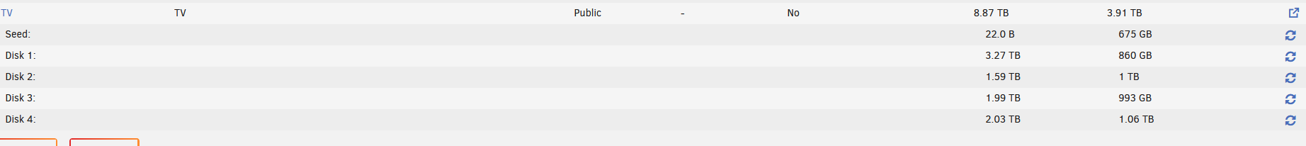

  7. Sorry, I should have phrased that better. The folder isn't empty. It's full of files, but none of them list as being on the non-array drive. The parent folder does list as something being on the non-array drive.
  8. Popped up during my morning server check. One share now shows files as unprotected. Computed, shows 22b sitting on a non array drive. Gone into the array share to find the directory. Found the folder which says it has the unprotected file in it... nothing to be found. Restarted the server. Issue remains. Why oh why... Oh fun. Now I've lost the ability to move/copy files via the Shares tab. Buttons, checkboxes are gone.
