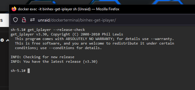

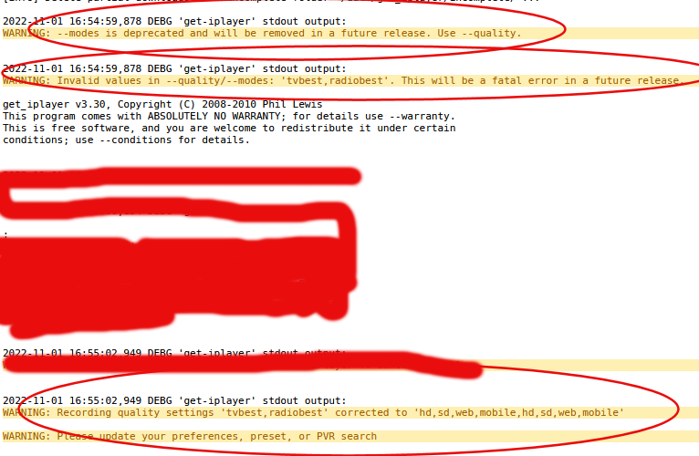

  7. Yep, I was doing something dumb lol. Thanks, all updated and errors now not occuring. really do appreciate you keeping all these dockers you make up to date!!
  8. I must be doing something dumb then cos the latest I can get from the github page is v3.30 and when I try a manual update from the console it also says v3.30 is the latest which I already have.
